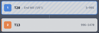

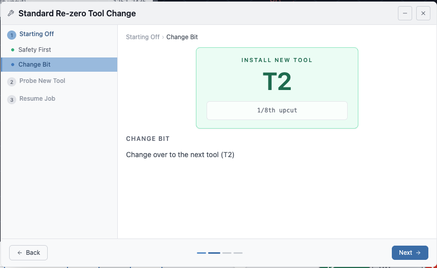

  • Numerous visual and workflow improvements to the tool change wizard
  • Tool change wizard will now resume the spindle before returning to the previous XY position
  • Tool change wizard and tool timeline now display annotation comments when no ATC nickname is set

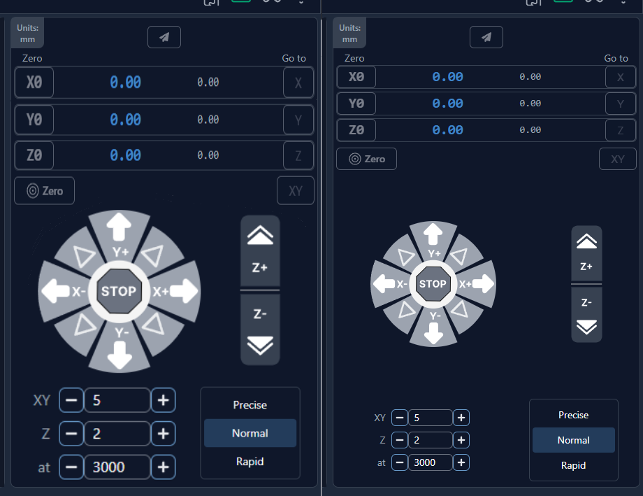

I love GSender but the button layout for the zeros is still quite tight. I have the Gcontrol panel and it does not allow for much error in placing your finger. One wrong slip and you zeroed the wrong axis.
Maybe there is a setting or layout change I am missing, but I would love larger buttons.
Agreed, there is a ton of unused space here that could be used to increase the size of everything. I’ve done a mockup comparing what I would expect vs what is there now. Taller and slightly wider spaced zero/goto lines, enlarged jog controls, and much enlarged and aligned controls for the axis movement distances.
The zero/goto buttons could be widened as well, but I didn’t see the need because its the vertical dimension that causes the problem.
