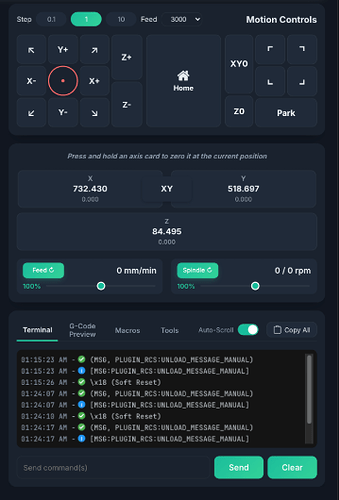

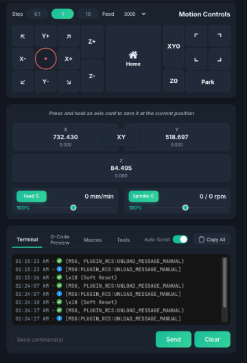

That unused space is there by design; when connected to a 4-axis machine, it is quickly filled by the additional axis row and jogging buttons:
We can make some further refinements, but the lack of space is an issue.
yeah, that’s fair, I didn’t consider that. As a UI developer, I also know how annoying it could be to make those all dynamically scale if there were 3 axes vs 4, so I won’t do that.
I still do mis-touch the zeroing controls and the goto controls though, and I’m not sure what I would do about that if it were me developing this. As an end user the obvious choice is either “buy a bigger touchscreen” or “get a mouse”, but you guys do sell a whole integrated touchscreen computer for this, so I assume you have a vested interest in making this UI good for touchscreens.
I can see going to a two-touch UI there making things a lot smaller (touch a “Zero” button and a small modal appears over it with large buttons “X”, “Y”, “Z”, and “A”. Similar for goto.). If that were done you could likely narrow the table of machine/workspace coordinates, and put the buttons vertically beside that.
Likely the easier fix for this is making the coordinates part and the jog part into two tabs in the side panel. That would effectively double the space you have.

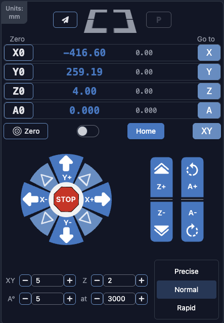

Edit: another interesting take on it, NCSender combines the coordinate display with the zeroing controls, and has a wider button layout, making all of the buttons more square. I havent tested this, but I would expect the squarer buttons to be better for a touch screen. as well, it is a touch-and-hold on a large button for zeroing, which is safer IMO.
@walid_kayhan I made this suggestion before but I’ll make it again.
When you are using the jogging controls, you don’t really need the visualizer. So why not decrease the size of the visualizer and increase the jogging controls size when you’re not running a job.
…or use a tabbed interface, separating the items based on when they are used.
Agreed. I can obviously only speak for myself, but the things I use the visualizer for are:
  1. is the correct program loaded?
  2. which corner did I set as my work origin in fusion?
It would be completely fine (to me) for it to be entirely on a different tab or to be reduced to half or a third of the size it currently is, in order to make inputs into the machine less error prone. I generally have a good idea where the machine is by just watching the machine, so I don’t generally watch the visualizer while the machine is running.
There isn’t a way to just hide the visualizer now, right? I think it would be helpful to have the ability to open a floating resizable jogging control window. The existing window can be left as-is but have ability to open a jogging only window that you can move around and resize as you see fit.
