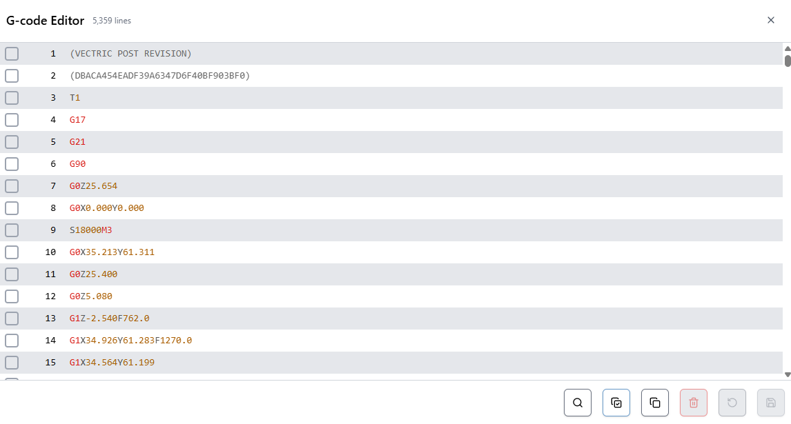

Built-in G-code Editor
gSender now includes a built-in G-code editor for inspecting and modifying files directly inside the application.
The editor includes:
  • Syntax highlighting
  • Search functionality
  • Quick navigation to specific terms or lines
  • Basic editing and saving capabilities
The editor also acts as an additional progress indicator while running jobs, highlighting which lines have been processed.

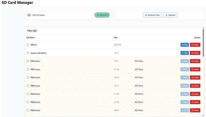

SD Card File Management
SD card functionality has been expanded significantly.
gSender can now interact directly with files stored on the controller’s SD card for grblHAL devices. It uses yModem protocol for USB connections, and FTP when connected over ethernet.
You can:
  • View files on the SD card
  • Upload files
  • Run files
  • Delete files
Files can be uploaded using drag-and-drop or file selection, making it easy to move jobs onto the controller.
When running jobs from the SD card, gSender now displays progress feedback similar to streaming jobs directly from the application.

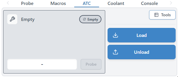

Automatic Tool Changer (ATC) Support
One of the largest areas of work this cycle was full ATC workflow support.
gSender now includes an integrated system for managing tools, tracking tool changes, and working with the Sienci ATC more easily.
Tool Table
A new Tool Table allows you to manage all tool-related information in one place.
You can now:
  • Store tool offsets
  • Assign nicknames to tools
  • Probe individual tools or complete racks
This makes it much easier to maintain consistent tool setups across jobs.

ATC Workflow Controls
New controls were added to support day-to-day ATC operation.
You can now:
  • Load tools - both manually and using the rack
  • Unload tools - both manually and using the rack
These actions tie directly into ATC macros and make managing tool states much easier during operation.

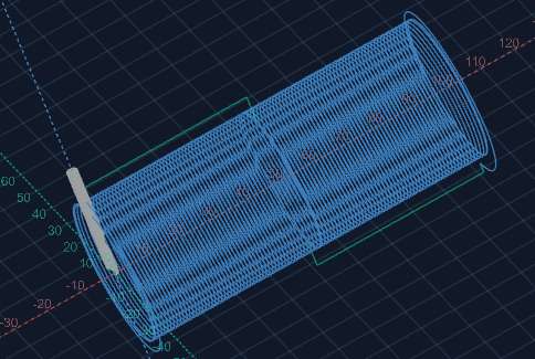

Rotary Visualization Improvements
Rotary jobs are now visualized more accurately, with fixes to geometry rendering and preview alignment. This provides a much closer representation of the final machined result.
