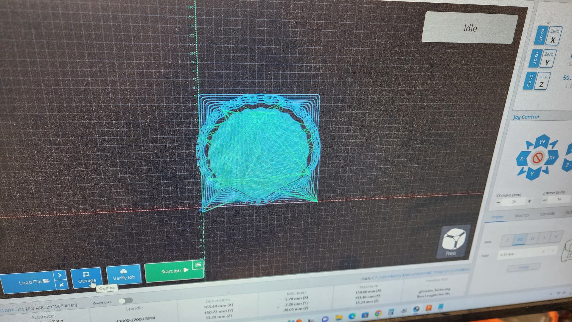

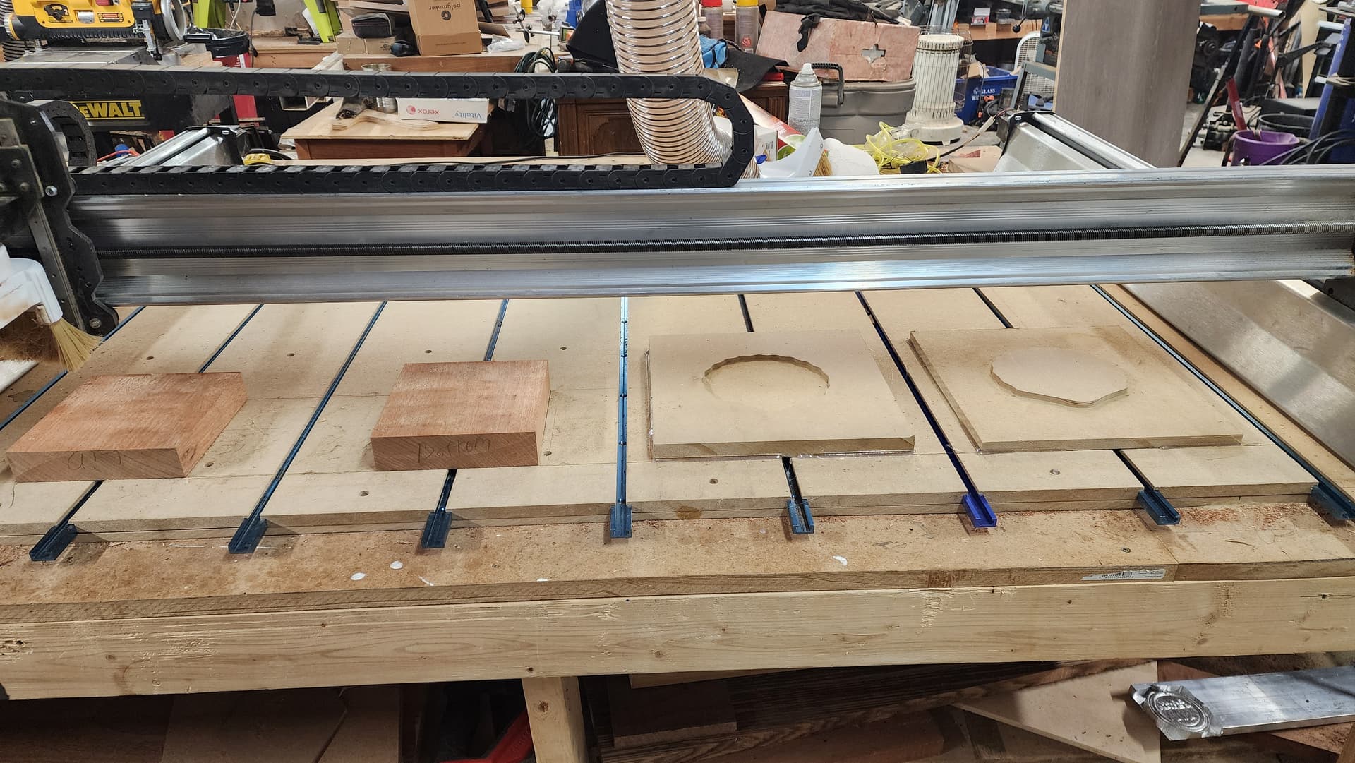

I am probably just missing something on how GSender handles workspaces. I have 4 workspaces defined, one for each station on the spoil board. The goal is to generate 2 jobs. One for the first two positions and one for all 4 to experiment with production runs. I have verified that the gcode is setting the correct workspaces. When I load the 2 position job into gsender it looks like the two jobs overlay each other on position 1. When i run an outline it does position 2 only. I am assuming the overlay is because the visualizer only has 1 origin. My question is will the job switch workspaces when it hits the change in the gcode? A broader question is whether I am going about this in the best way.
Yes. You’ll have preview issues though as gSender visualizer shows everything from the perspective of the WCS.

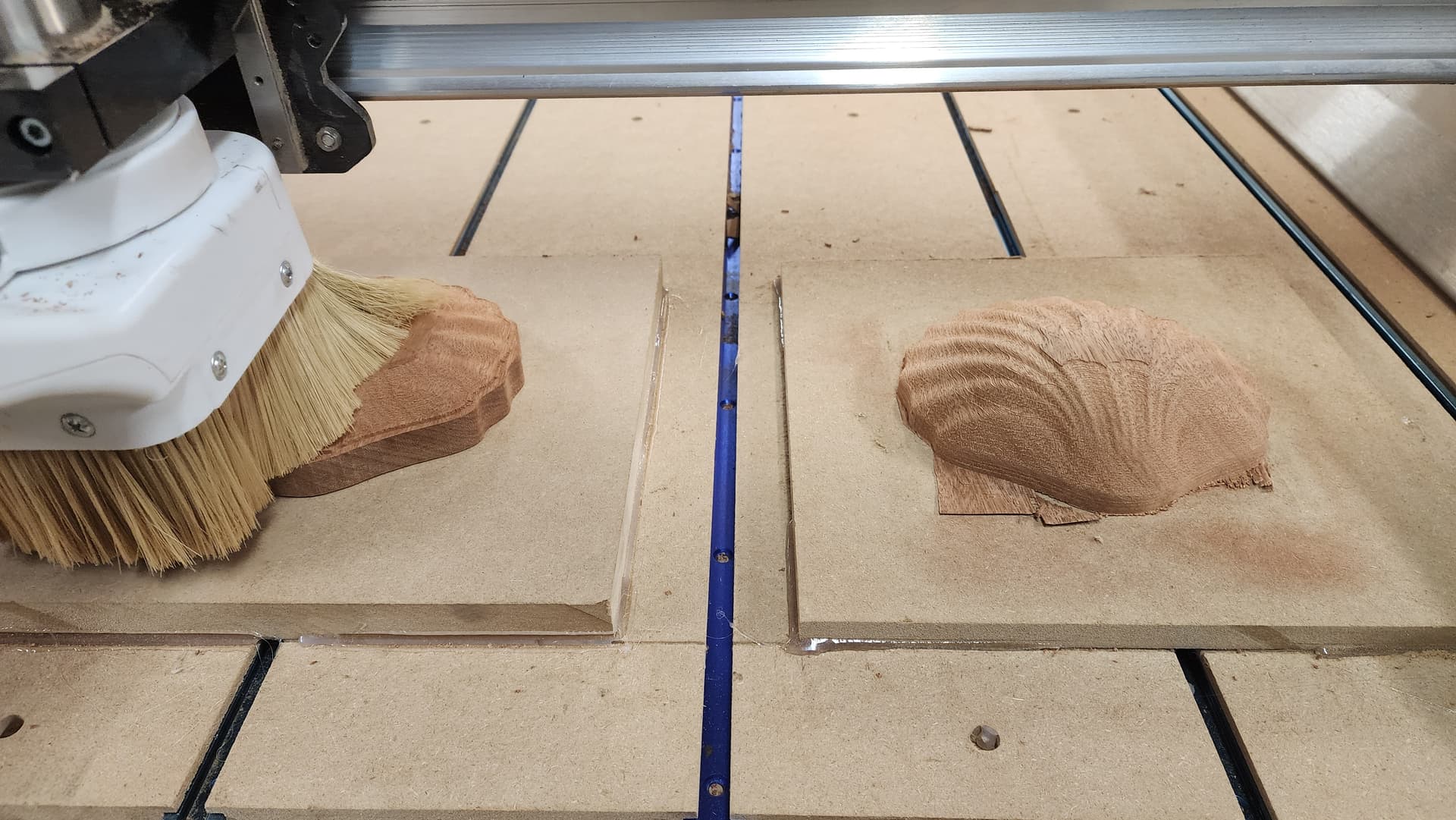

I finally got a job to not error through the workspace change. It switched workspaces just fine at least on the fixtured second side job. Would be awesome if the visualizer was workspace aware.

I don’t know how gSender visualizer could take the WCS into account without causing issues for most users (that only use G54). Would you want the visualizer to represent G53, machine space? I think that would complicate things.
Maybe it could stick with G54 and make all other WCS relative to that? That would make it confusing for those that use different WCSs but one at a time.
