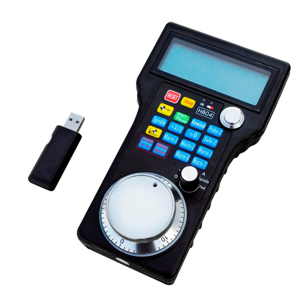

Hello is there a handwheel that is suitable for gsender and can be connected to a PC?

Welcome to the forum Manuel. The info in this GitHub Issue for GRBL might be relevant although it’s a bit old and maybe things have changed.
EDIT: This is all new to me, I didn’t even know what a CNC handwheel was but I assume we are talking about something like this?
It was this bit from the GitHub issue that made me question whether a device like that can work with GRBL.
A handwheel works with a system that has closed-loop control or a specifically-written stepper algorithm that can handle distinct and asynchronous input from a handwheel. Grbl does neither.
This is exactly what I meant ![]()
Thats a bummer…i used to use one like that on a fanuuc which also had an estop on it…i was hoping to get one for the altmill.
