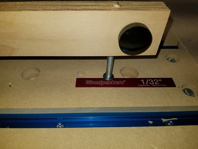

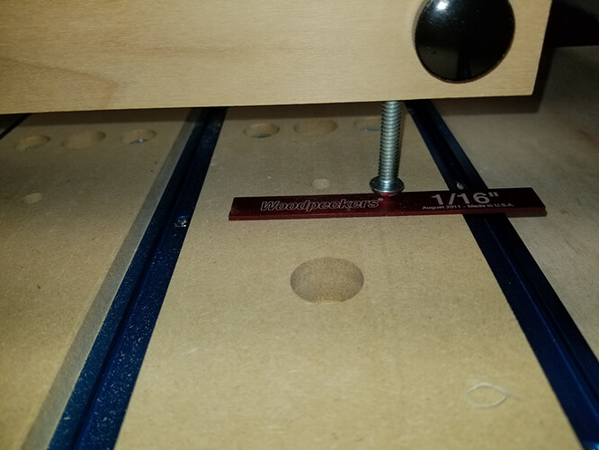

I checked the alignment of my router using the instructions in the video above. It seems I am out almost 1/16" along the X axis and almost 1/32" along the Y axis. I have been struggling with how to correct this as there seems to be no ability to make adjustments on the Long Mill and the tolerances are such that there is not enough slop to make any change just loosening and retightening bolts. The limiting factor is the bottom wheels that are mounted on fixed axles. This may sound crazy but it seems to me that it would be possible to make small rotational adjustments in both the X and Y axis if one or both of the bottom v-wheels were mounted using eccentric nuts like the top wheels. While this would make the mill much more adjustable the trade off would be that it would be harder to get it into a basic alignment which a majority of customers would probably be satisfied with. Before I start boring out the holes for the axles I am wondering if anyone has tried or even considered such a thing.
I was able to make adjustments just by loosening the router in the mount and moving it slightly. Only took a couple of minor tweeks to get it close enough. HTH’s,
