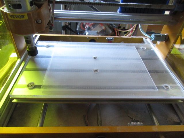

3] Prepare a spoil board:
Cut out a 0.25 inch thick 30x18mm . 11.8 x 7.1” polycarbonate board to use as a base for PCB board. Attach the board to the CNC base using counter sunk machine screws and bolts

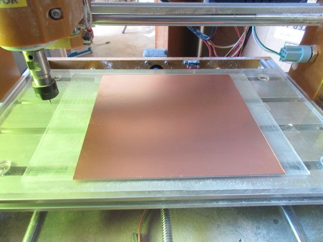

9] Attach the PCB board with plastic double sided tape . Scotch / 3M permanent double sided tape

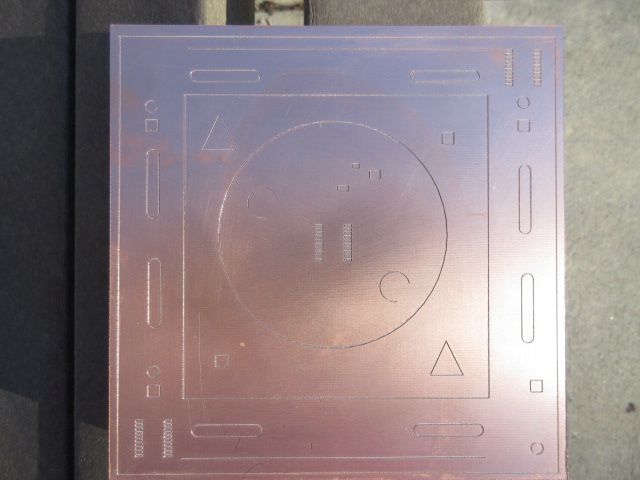

10] The bit to be used is a 30 deg PCB engraving bit. The cutting dept is 0.005”. The feed rate is at 2” per minute. You can increase the feed rate to test for breakage or high ware. For large areas were there are no traces use a .5mm to .8mm flat cutting tool with overlapping cuts. With a cutting depth of .005” – 0.00137 cladding, The width of the cut will be Tan 30 x 2 x .00363 = .0042 . Any deeper cut will result in grooves formed in the laminate and copper cladding getting pushed aside uncut and remaining on the PCB surface. Let me know if there are any typos. The bits used here had at more that 10 hours of cutting on them.
I could only show one picture so I showed the end product with test traces to demonstrate how consistent the cut level was.
Spoil board: picture. I use polycarbonate because it is hard and have a low melting point
Tapping with double sided 3M plastic permanent tape
PCB board attached to spoil board

I just want to add that for milling PCBs height mapping is not necessary. You get good results without it. If you make a well leveled spoil board. I looked the 8 4 inch boards and 1 6 inch board that I made with a $300 CNC machine and V bit with 10 hours on it with a magnifying glass and the consistency was great. I only used the machine for about 12 times. [ had to figure out G code].
