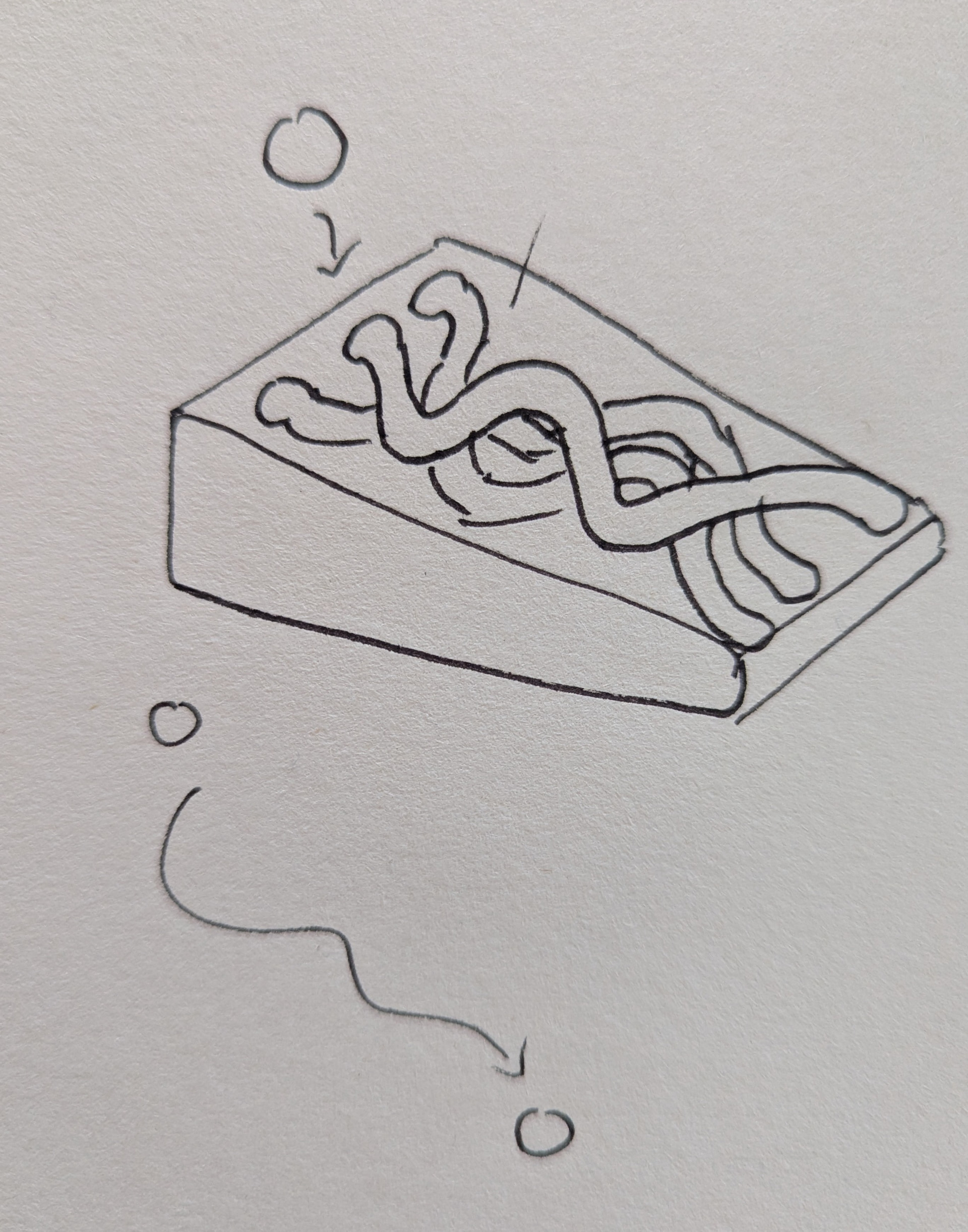

Hi ya’ll,
Looking for some advice on how to approach a project i’m thinking of making.
Which software would you recommend for the design? Would this be possible in MillMage or similar? Or better in Fusion or the like?
And what bits would you suggest for the carves?
The idea:
I was thinking of making a sort of marble track for my little one. But instead of small marbles that pose a choking hazard I like to pair it with his bigger wooden balls.

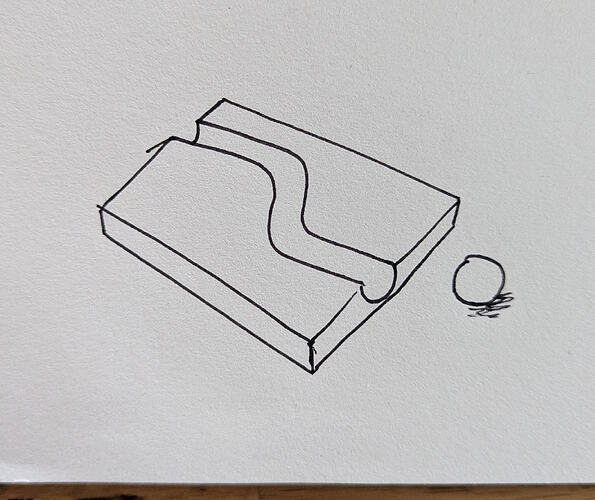

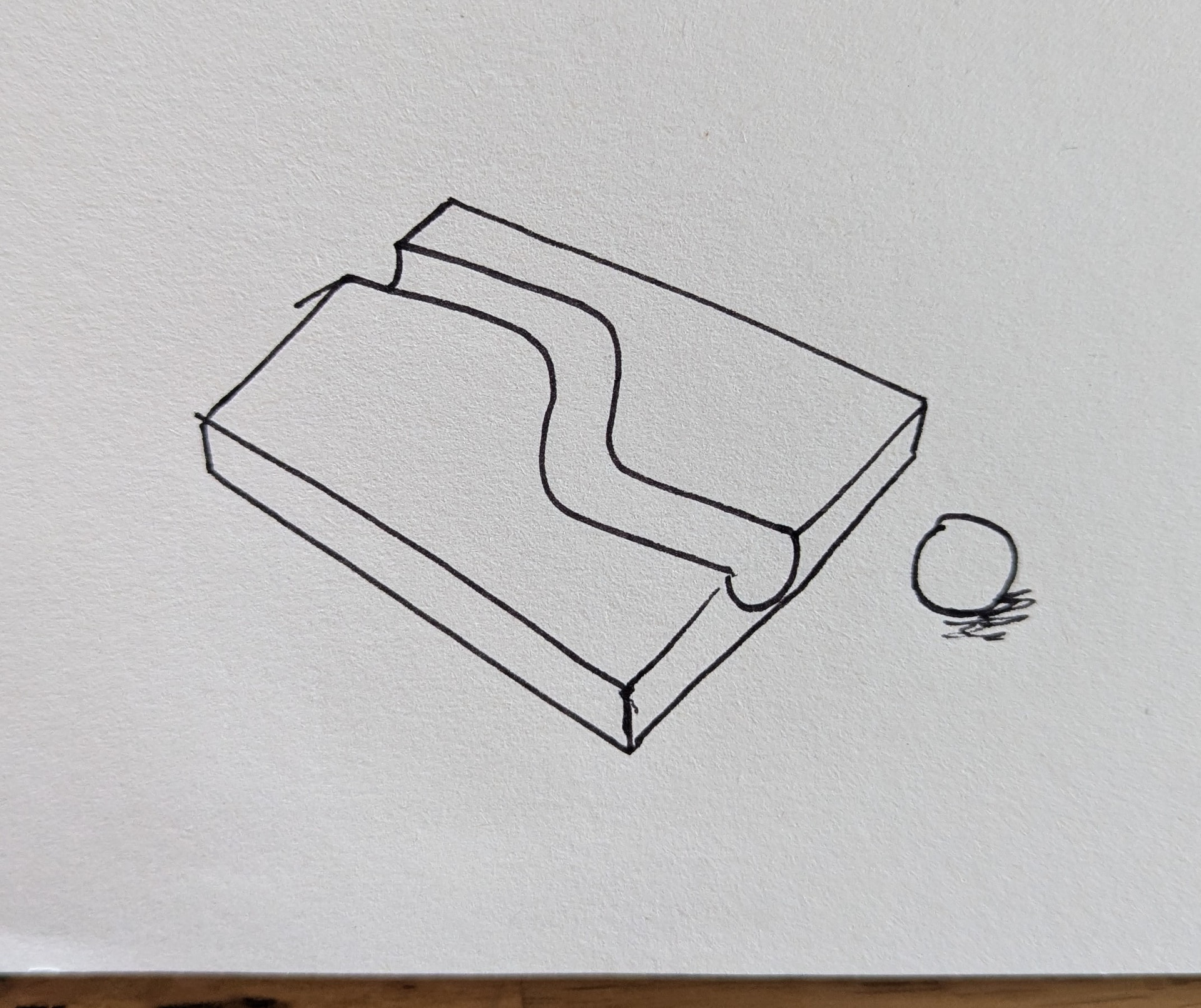

What im trying to achieve is multiple curved tracks in a sloped piece of wood. With each track having the shape of the ball on the inner side so it neatly fits while rolling down.

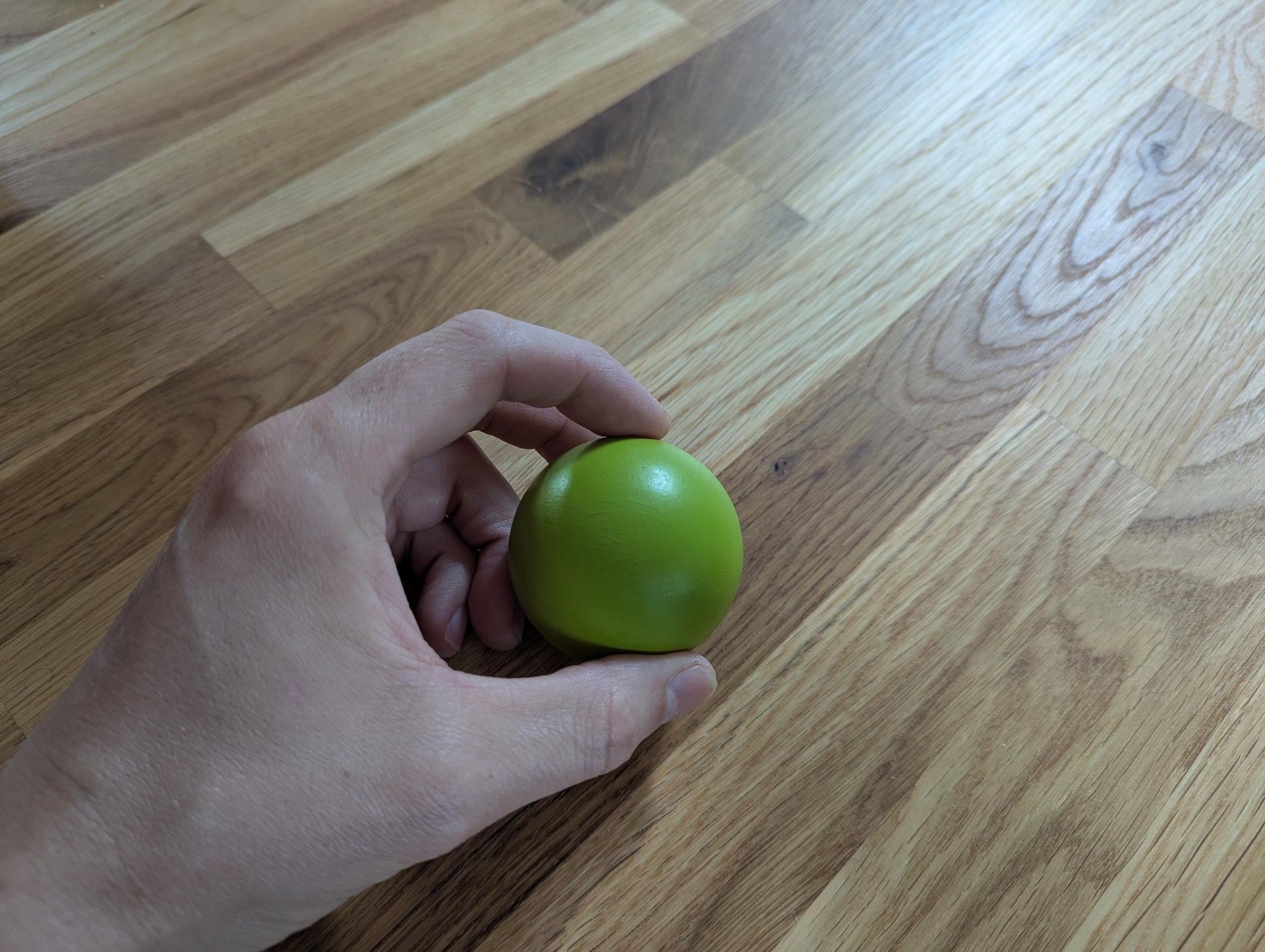

Now that last part is whats my question is about. How to create this? The diameter is too big for a bowl and tray / box bit to properly mimic the ball 's shape I assume (not that it has too be exact the same to work, but esthaticallyI think it would be nice if the radius is about the same with being a tat wider to properly Let the ball roll). The ball is about 5cm wide.
Added a few illustratieve drawings. Not the best drawings haha but yeah, hope it paints a picture.
Thanks for thinking along!

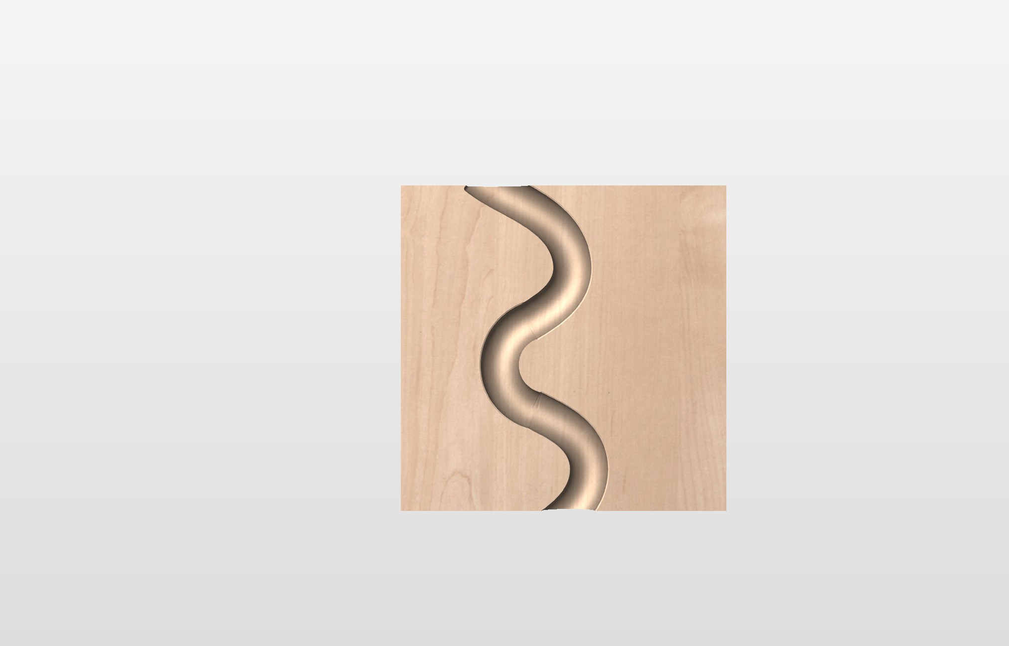

@CuttingTheCrapAlex I can’t speak to Millmage or Fusion. This can be done using the moulding toolpath in VCarvePro, with a 1/4" ballnose mill. Quick and dirty. Is this the idea?
Awesome! Yes indeed. Exactly like that. Could you share which settings you set for that result?

@CuttingTheCrapAlex I used the moulding toolpath in VCarvePro. I don’t know if Millmage has an equivalent function. I can send you a .crv file, but it will not help if you don’t have VCarvePro 12.
Gotcha. I was wondering if there are specific settings to this toolpath to let it cut like that. But let me do my part first and experiment with MillMage as I start the trial.
@CuttingTheCrapAlex If Millmage can’t do it and you don’t want to buy vCarve, Fusion can do this with the loft tool. You’ll essentially create a 3D model that you then carve with a ball nose or tapered ball nose.
@CuttingTheCrapAlex The moulding toolpath just takes a drive rail and runs a profile along it. So, for your project, I created a half circle of a diameter of 2.1" or just over the diameter of the ball. Then, freehand drew a curved “track”. The software does the rest. I fiddled with it a bit to get a smooth run, but it’s pretty straight forward for this toolpath.
As @Chucky_ott said, another approach would be to create a 3D model. I can’t do that in VCarve. I would need to use Aspire in the Vectric family and I don’t have that. The upside of the 3D model over the moulding toolpath is that you can be a bit more imaginative. The downside is that the 3D model will take quite a bit longer to carve.
Great, thanks for sharing, that paints a clear picture on how that toolpath works. I have some roads to explore to get this carved. Thanks all!

That would ask for a bit smaller ball then we have laying around now. But that’s ok.
