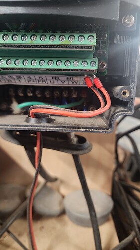

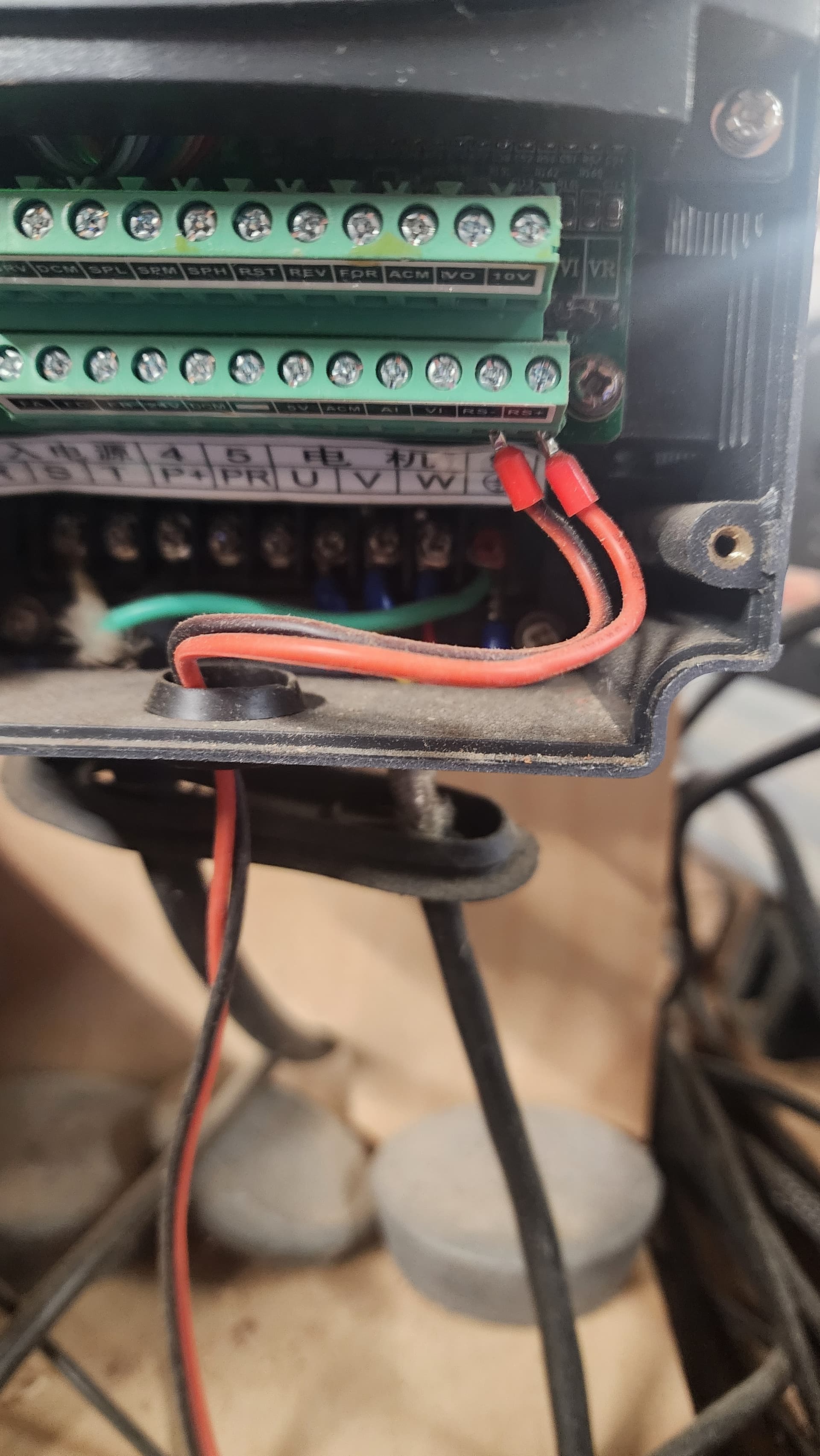

For RS485 you should only need to set the address pd163 (any number i used 2) , Baud pd164 (I use 192000 param value of 2. And data method pd165 to 3.
This jumper needs to be switched to as shown
These are the rs485 pins

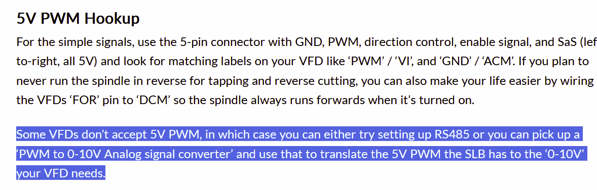

from the posts i had read on here i somehow was under the impression that i needed them because the pwm was running at 5v and the drive needed 0/10. 10 being wot.
This was the only way to get spindle control on the original longboard controller. I never could get that to work. RS485 support is one of the reasons I upgraded to a SLB.
Hey Courtney,
As far as I can see, Kerryh is right. If you have an SLB, you are good to use RS485 if your VFD has that option.

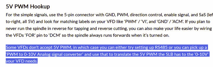

When using PWM output, you need to convert, if the VFD does not take 5V PWM, as stated here:
Found here:
ok. i blew up one drive. have no clue what happened in detail. i checked the cable and connector to spindle with my meter. nothing is shorted and #4 pin is ground as it should be. uwv went to the corresponding terminals. drive powered up but when i sent a speed command via the speed pot on the drive she popped something on the inside and never was heard from again. i had the jumper set for using the speed pot just for testing purposes. no other connections other than incoming power (120v to the first and third terminals) the listing on amazon states its a 110v system so i assumed that since the drive powered up with line on the first terminal and nuetral on the third everything was fine. (it was not fine) now the question.
can you send me a detailed picture of exactly how you hooked yours up? and if you have time the parameters you changed from the manufacturer?
i should also add that this is an HY series of drive from haunyang. 110v 2.2kw water cooled spindle. 400hz
ok. its an hy series drive. 110v 2.2kw. did you hook up pin 4 on the spindle to the earth ground terminal on the drive? as in the one with the red paint on it?
Pin 4 on the spindle should not be connected to anything internally (at least mine is not). I used that wire to ground the shielding. in the motor feed cable.

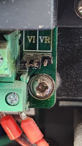

If you can still turn on the spindle and control the speed from the panel on the vfd, there is a jumper on the right side of the terminal block that needs to be switched.

yes i have the jumper on the left two pins (VI) will let you know in a few
