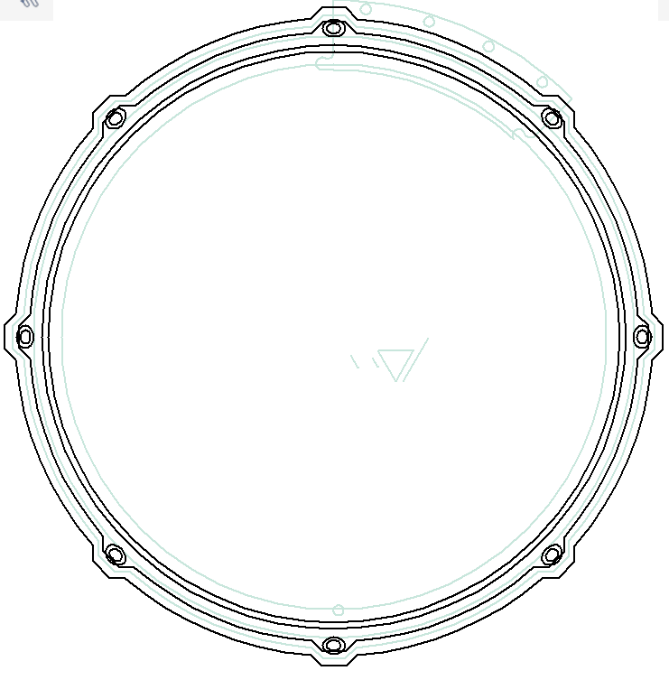

So I make custom drums, and the primary reason I bought my cnc was to more accurately and consistently make parts. The main part I am concentrating on is a wood rim. I have r&d’d my design over many years using an overhand router setup I built myself, but realized I could not keep it consistent enough for any real production. The rims are made of 4 layers of 1/4" hardwood that I have constructed from octagons. I was hoping my cnc would make this easier faster and more consistant, but I can’t get it to actually come up with the size I have programmed. Here is my vectric design:

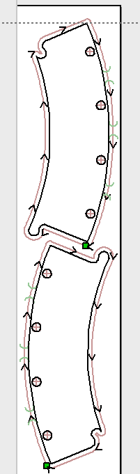

So I designed the individual piece using the drawing, using angles created from an octagon layed inside and outside the rim dimensions, isolated the part of it I needed and created this file to cut them out of small peices of 1/4" maple,

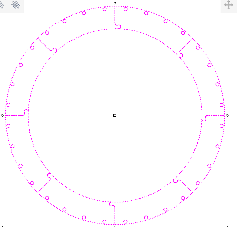

but when I make the part, It comes up smaller than needed to create a full circle. The angle is also just a hair off. I even created a circular array to check my measurerments and it seems like my design is right, even the little reference points have a little room in the joint(.002’) so they will go together well.
but my actual peices dont join correctly into a circle. So it seems like my machine is not cutting exactly what I am designing. How do I check and adjust my Machine to make it cut the actual dimensions I need?

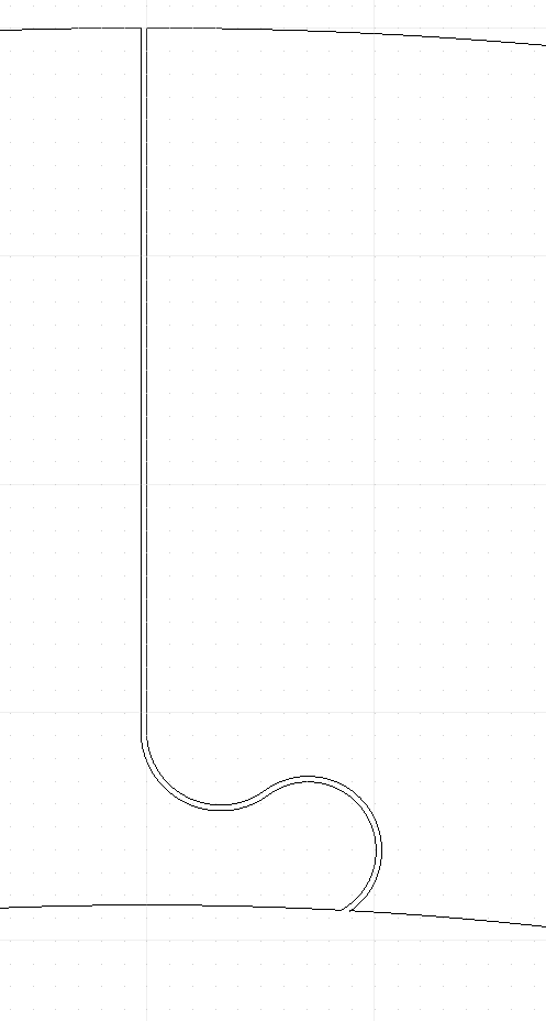

Could the problem be with your drawing? I rarely use vCarve for the CAD portion of my designs. I prefer to use a proper CAD program, which are usually more accurate. I use qCAD, which is a paid (and supported) fork of LibreCAD.

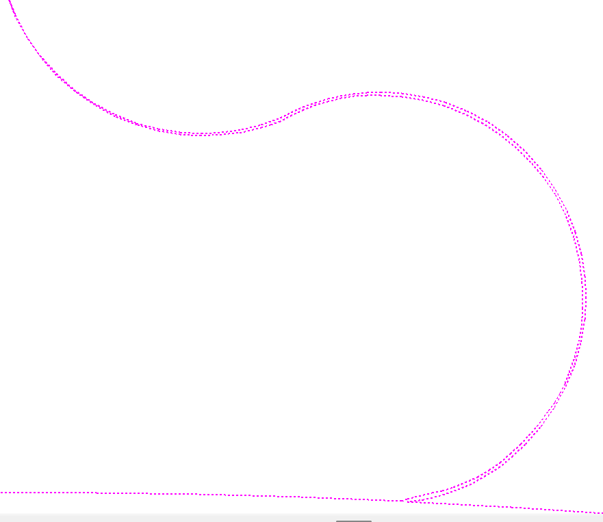

From the drawing you posted above, you can see that the lines between the mating parts are not equidistant throughout the length of the vector. That might be part of the problem.
If you fix that, maybe the parts will mate together better. But you might also need to use offsets so that there is some play in between the mating parts.
If you stack your parts, are they all exactly the same? If they are, then accuracy of the CNC may not be the problem. It could be the drawing.
I’d be happy to make a DXF version of your file if you want to try it.

Yes it certainly could be the drawing. I was hoping someone with cad experience might chime in, so thank you! Do you think that the mating lines should have a gap? if so how much?
I don’t know much about offsets, so any info would be appreciated.
The parts are all coming out the same now, and I’m very close to having a complete circle now, so I think half of my problem is fixed, the other half is getting the drawing or offsets, (or both)corrected,
Thanks!!
Ok thanks. I didnt realize you could do it that way, just have to make sure I change it back if I adjust any other vectors..
There probably should be a gap between mating vectors, especially with wood. How much of a gap? I dunno. You’d have to try different gaps sizes to determine that. A lot of factors come into play here: wood species, moisture content, time to assembly, adhesive that will get used, etc.

Here’s what can easily be done with qCAD. While vCarve has its strong points, creating vector drawings is not it (at least not to someone with 35 years experience with CAD software).
Note the constant gap between the mating parts. It would even be possible to vary the gap of the “key” but minimize the gap of the straight line as much as possible.
@Shellshock I will respectfully disagree with @Chucky_ott on two points. First, Vcarve is perfectly capable of producing those mating parts. I have made dozens of jigsaw puzzles that prove that. Second, IMHO, the last thing you want to start your project with is a DXF file. They are messy, node filled files that will not play well with Vcarve. You can take the time to clean them up if you like. If you must import a 2D file rather than create it yourself, look for an svg file.
The other issue that has not been covered is the size of the end mill you are using compared to the profile that you want it to cut. An easy way to see how and where your endmill will cut in Vcarve is to turn on the profile view that shows as a dark blue line. (I don’t have access to Vcarve in my current location, so I am not using the proper term.) This will show you precisely where the end mill you have chosen will cut. Another way to see this is to create a circle the size of the end mill you want to use and move it around the profile. You will quickly see where it will and will not cut.
All of this presupposes that your machine is properly calibrated and maintained. If it is not, none of what I have said has much relevance.
I don’t have Vectric anymore but I used to. I know it has an offset tool that you can use to get the even gaps @Chucky_ott has shown. You might have to use ‘node view’ or whatever it’s called to isolate the curved part and then the offset tool will create another vector with a constant gap on whichever side you choose in the dialog for the tool.
