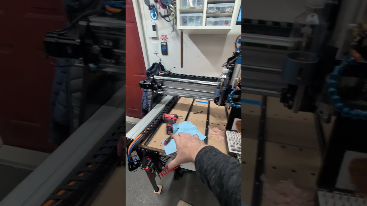

How to adjust your AltMill's X axis
I couldn’t achieve a properly tram with my 2x4, I couldn’t adjust the mounting plate far enough to correct it. I went through these steps along to way to achieve it.
Great overview of leveling/squaring the table! Did you also tram the spindle?

Yes, after this I was able to tram properly using shim stock. You should first ensure your Z axis is moving orthogonally to the XY plane. Then, you can tram the spindle tilt and nod.

Note that tramming your spindle is the last step you should be performing. You need to adjust your Z axis first so it’s moving orthogonally to the XY plane first before you tram your spindle. Otherwise you have a spindle that’s moving in X/Y when you don’t want it to.
