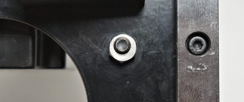

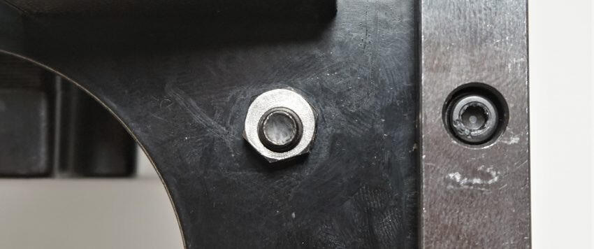

Make sure your eccentric nuts are in their widest position. The off-centered hole at the top
Lowest/narrowest
Upper/widest
