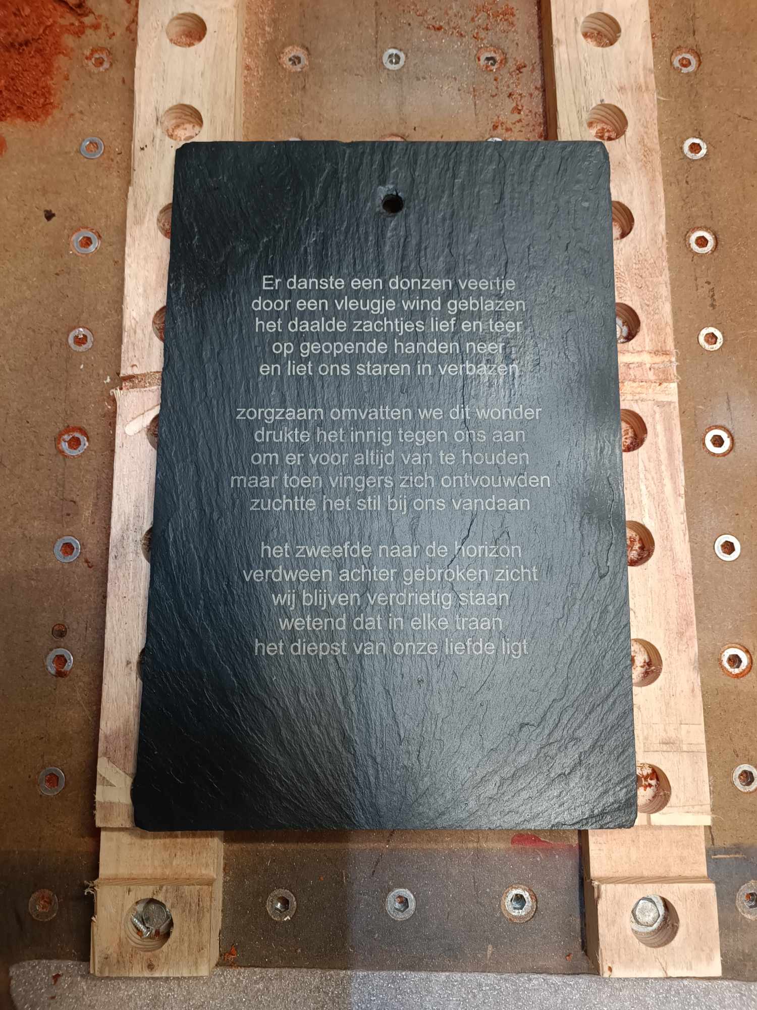

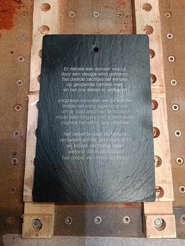

  2. Slate.
    . Clean surface with spirit.
    . Apply clear coating to preserve slate look or black coating for extra contrast.
    . Use for tekst or simple vector graphics. Too detailed pictures will not pan out due to lack of contrast, even with black coating.
    . Due to slate reacting with laser and becomming lighterish slate color, speeds need to be reduced and power in the high spectrum (80%ish) for best results.
    . Due to the etchings becomming lighter, graphics need te be inverted.

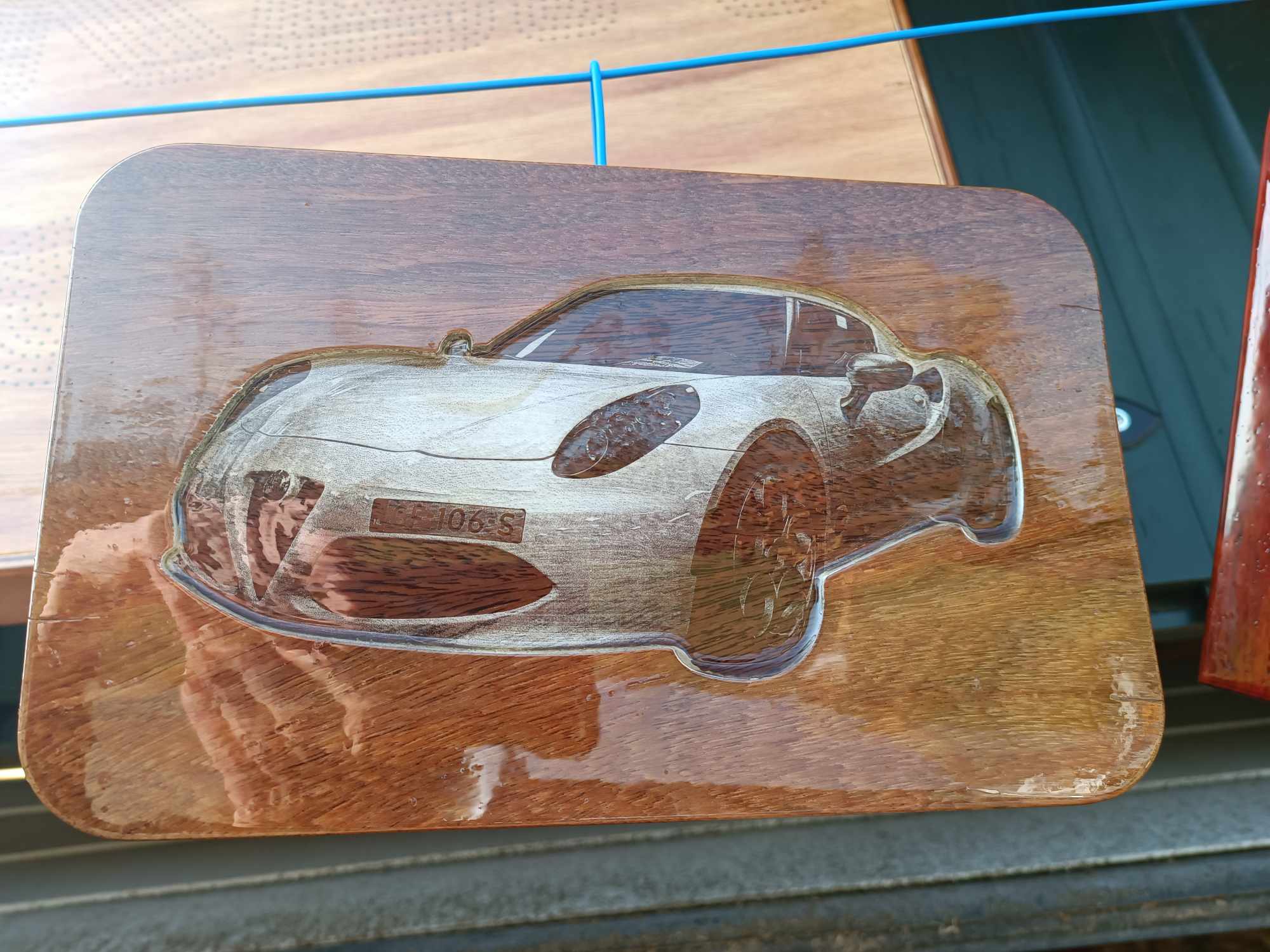

  3. Laser etching in dark wood that would otherwise give bad results due to low contrast between etch and medium.
    . Paint the wood with a white acrylic paint. Don’t worry about visible brush strokes, they will give your etch the apearance of a painting rather than a laser job.
    . Speeds and feeds is more tricky. All depends on how thick you apply your paint. Some experimenting is needed. The trick is to not burn the wood, just the paint, so speeds tend to be medium and power no higher than 50%. If anything needs adjusting lower the speeds rather than upping power. The exposed wood in the darkest parts of your picture will make the etch come to life.
    . I like to carve an outline of the picture and etch inside of that but it isn’t needed to get awesome results.
The last one needs some learning curve, but when you gained a feeling for it, it will be a fully repeatable proces on various wood species with wildly variating properties when exposed to a laser naked. It’s a bit of a cheat, but a neat cheat.

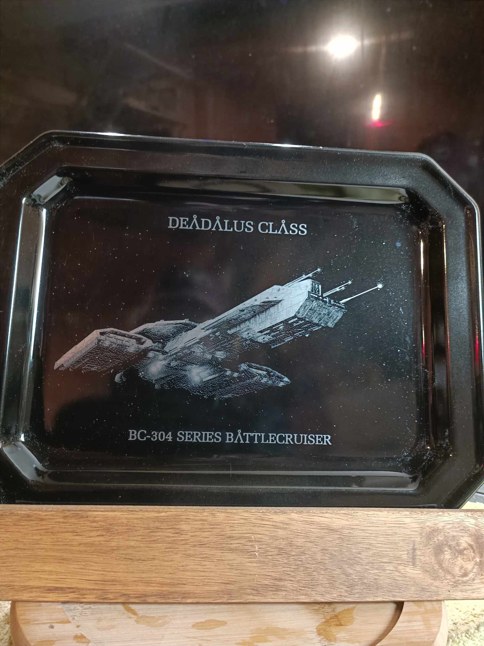

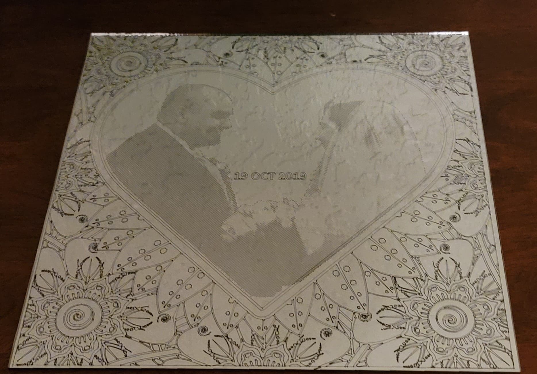

I have used Vetric Pro to create this 12"x12" mirror
And also have used the vortex to laser etch a beer mug
It works great for me just had to modify the vortex track to do the mug.
