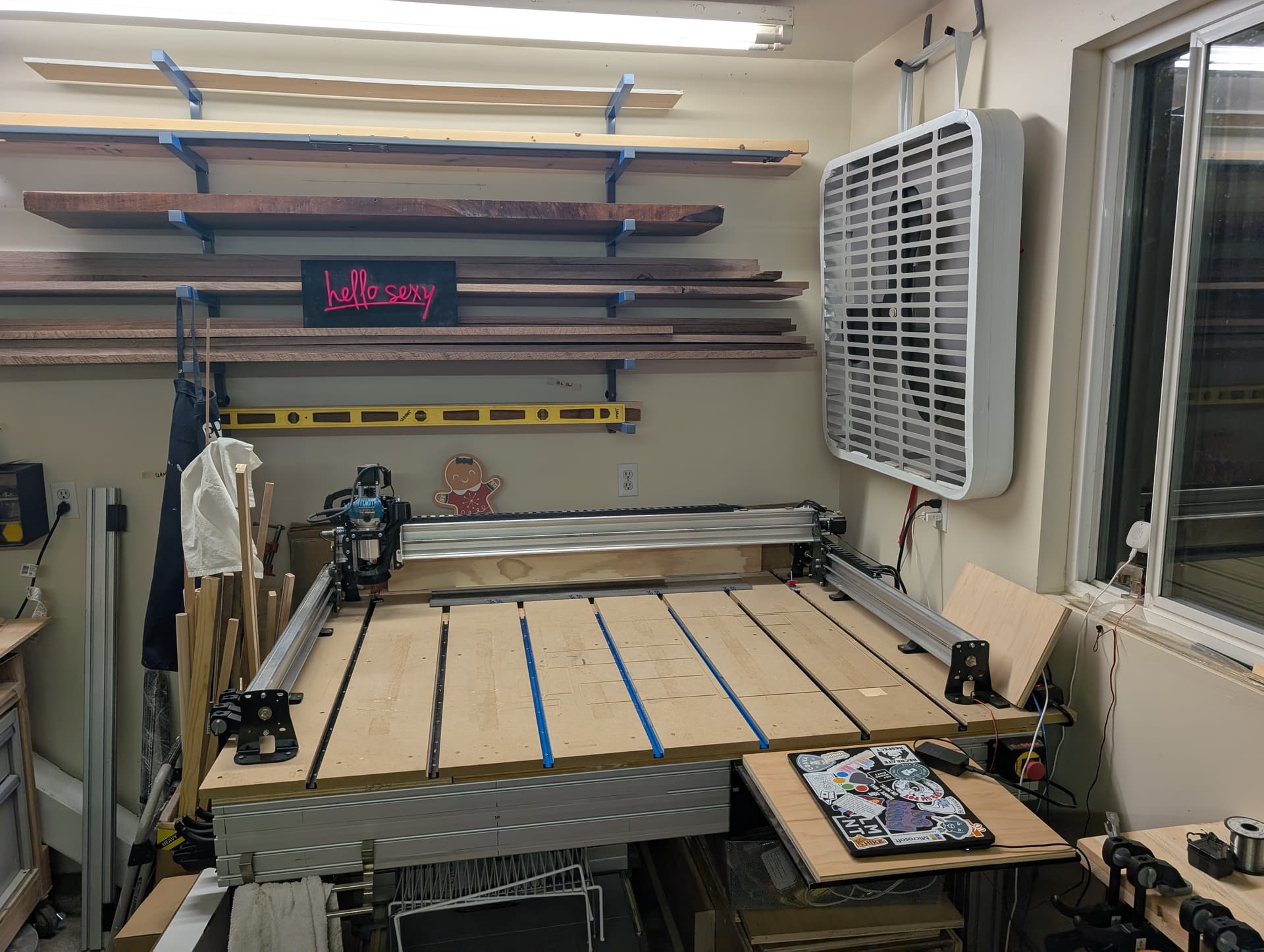

Okay so Ive had this machine since 2022- and long story short _ I set up my Longmill MK2 and ran a sample cut soap dish (which worked!) for various reasons haven’t been able to use it until now. Trying to start back up and set it up. after getting through various troubleshooting problems (machine out of square in x-y, hitting too many limit switches, re-learning the new auto zero touchplate I am still having trouble with basics.

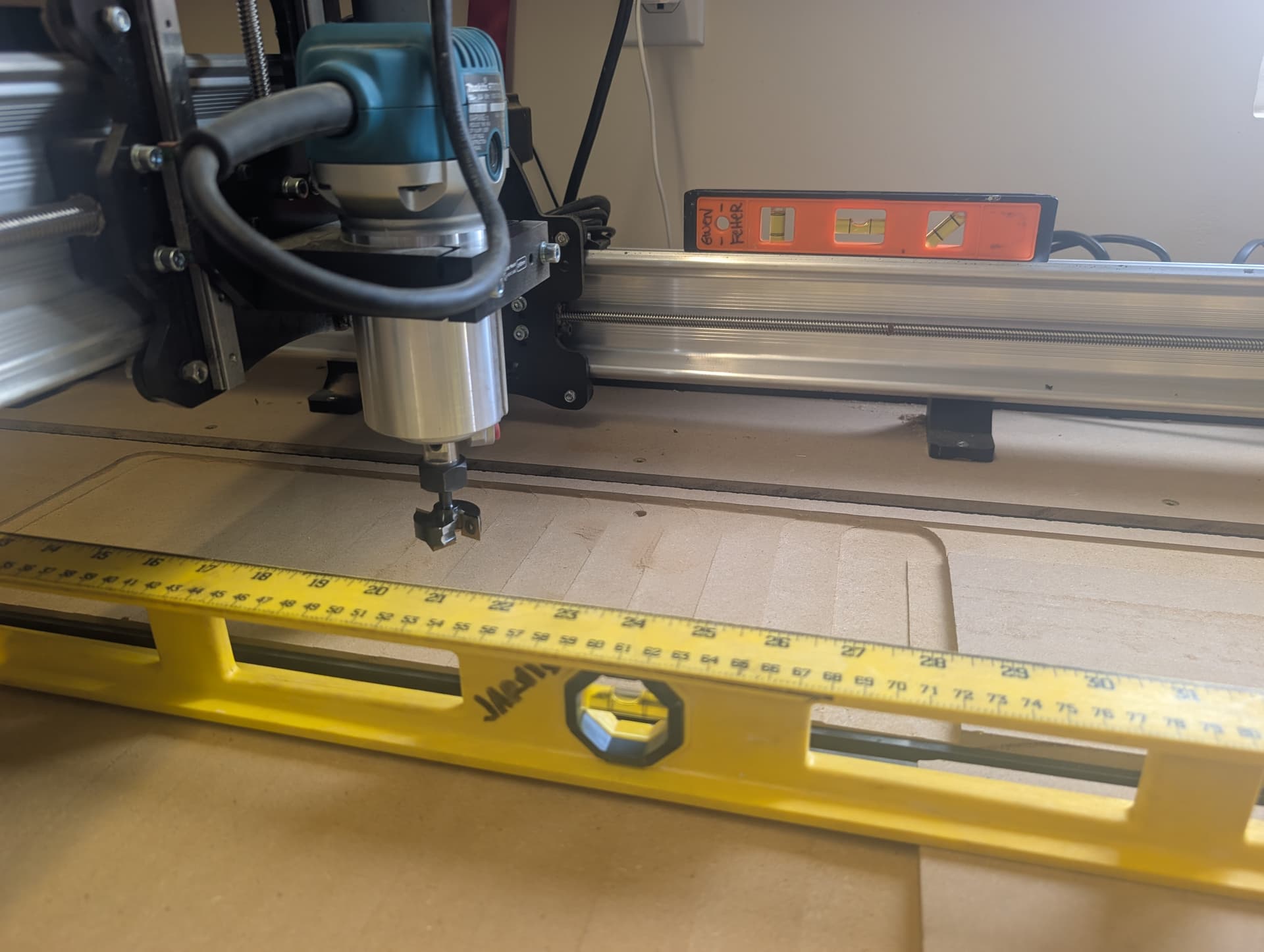

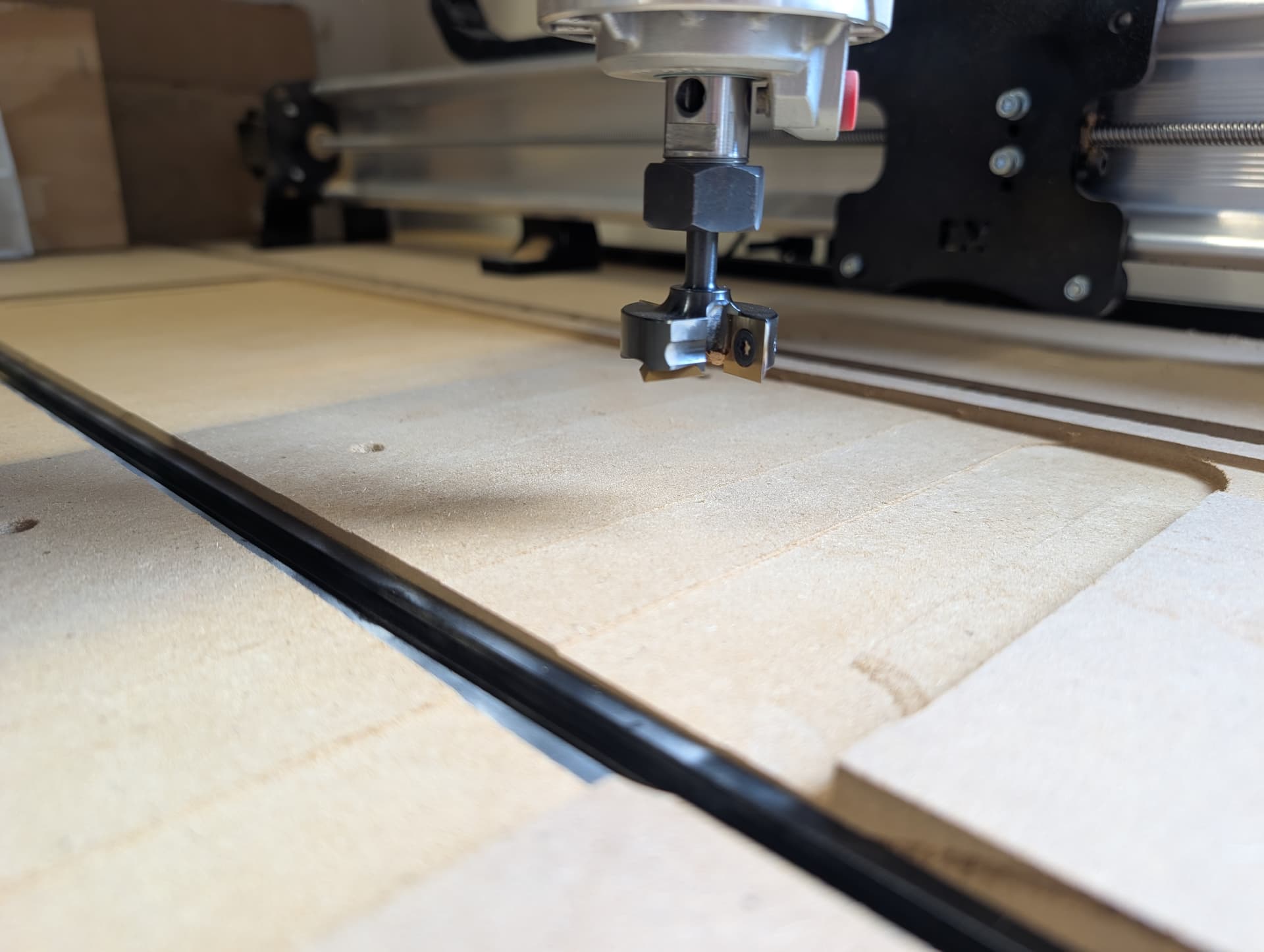

For whatever reason the router (tightened in the router mount) maybe seems to be sliding down because each pass it is going deeper and deeper. the top left corner (my 0,0) i set for a spoilboard cleanup at 1mm depth, max 1mm and the lower right corner is already at 5mm deep. My bit is about to hit the C channels so I had to stop mid program. its also going to chew up my bit like this.

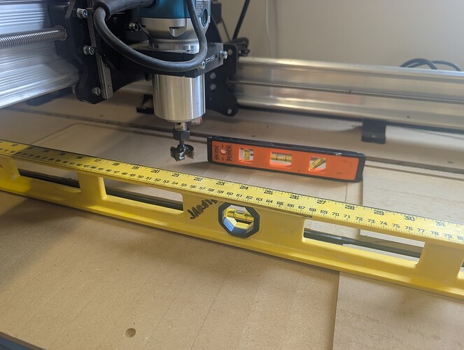

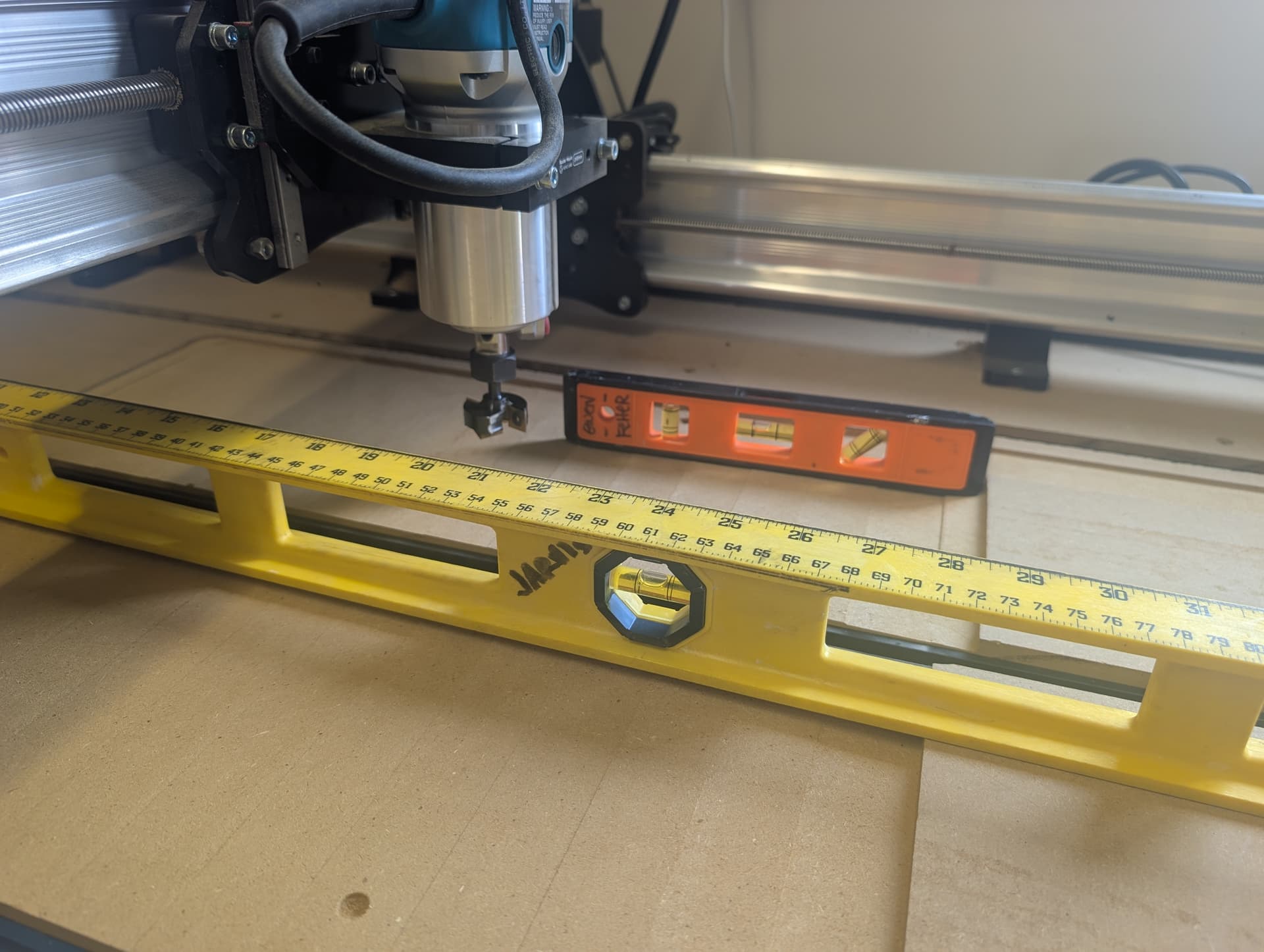

1st photo is the setup before spoilboard surfacing attempt - 2nd photo is front right , 3rd photo is near 0,0 top left)
What is going on? The router is mounted to the same surface on left and right so its not that. help - what do i do? I am out of ideas on what it could be.

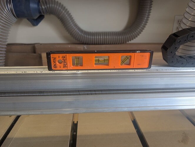

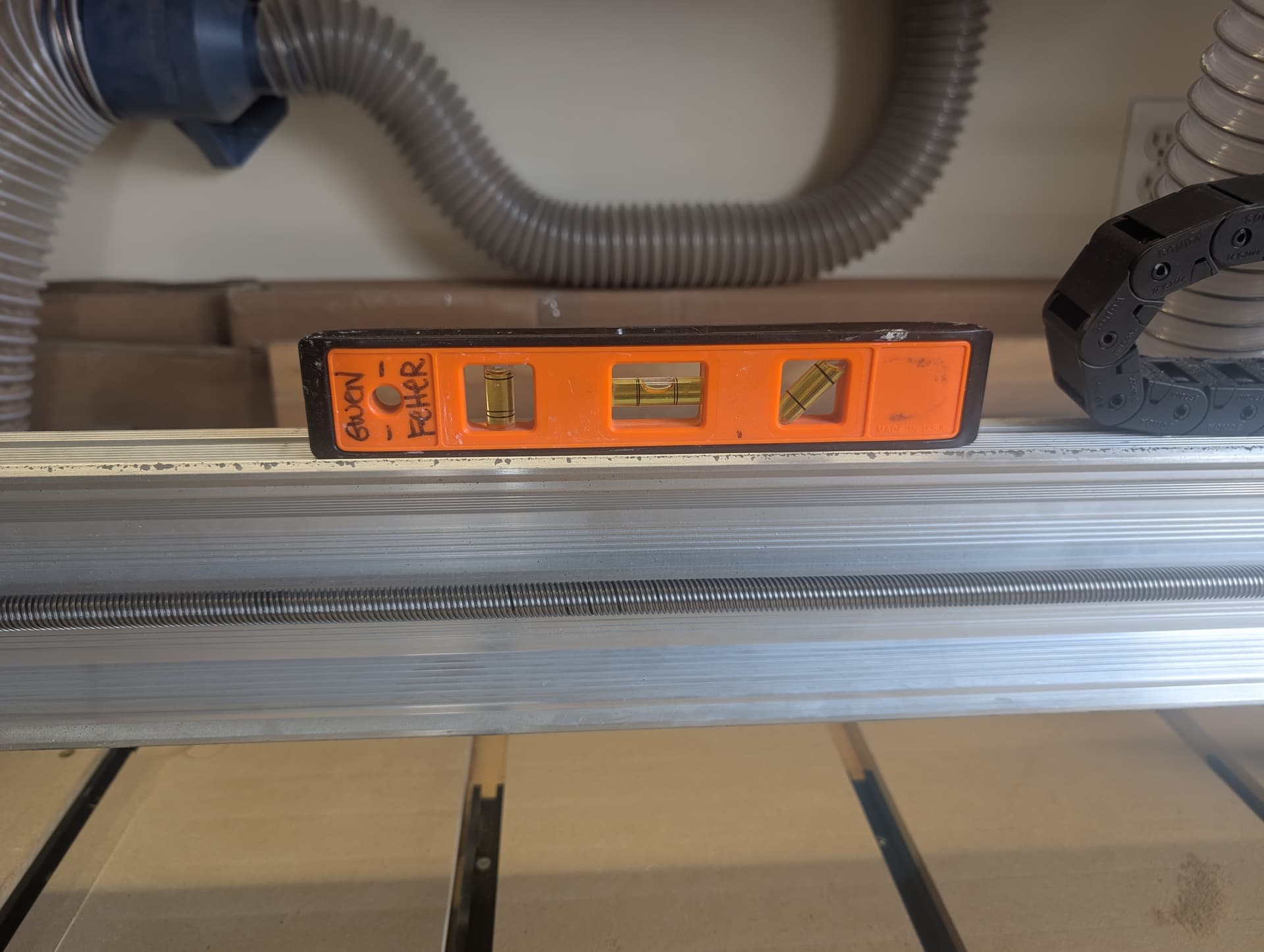

you can also see with my two levels that the spoilboard previously was level and the new cut is unlevel (I also checked my gantry rail and y rails which are also level )
@GwenMakesThings It’s unlikely, though not impossible, that the router is moving. It’s more likely that the bit is slipping in the collet. Check that all is clean in the collet, the router spindle and the mill. Check also that the collar between the Z motor and the Z lead screw are tight.
When you’ve done all that, I suggest that you clamp a piece of scrap anything down onto the spoilboard and surface it. That way, your spoilboard is not the guinea pig.
The front right corner is about 6mm deep. The front left corner is 3mm. But the back left at 0,0 is barley 1mm. And the back right is 3.
So it’s like everything is skewed on a diagonal
If the router bit was truly slipping, wouldn’t it be just as deep on the left as the right side?

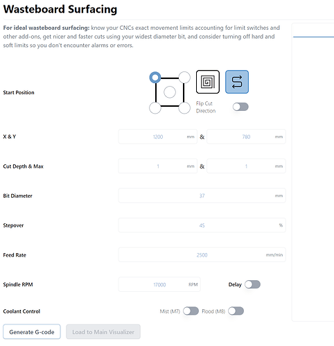

  2. I don’t know the details of your surfacing bit, stepover and cutting speed but a 1 mm cut is a very substantial cut. My standard surfacing cut with an Altmill and a spindle is 0.5 mm in solid wood. MDF might work ok at 1 mm with an Altmill but I think you are being way too aggressive.

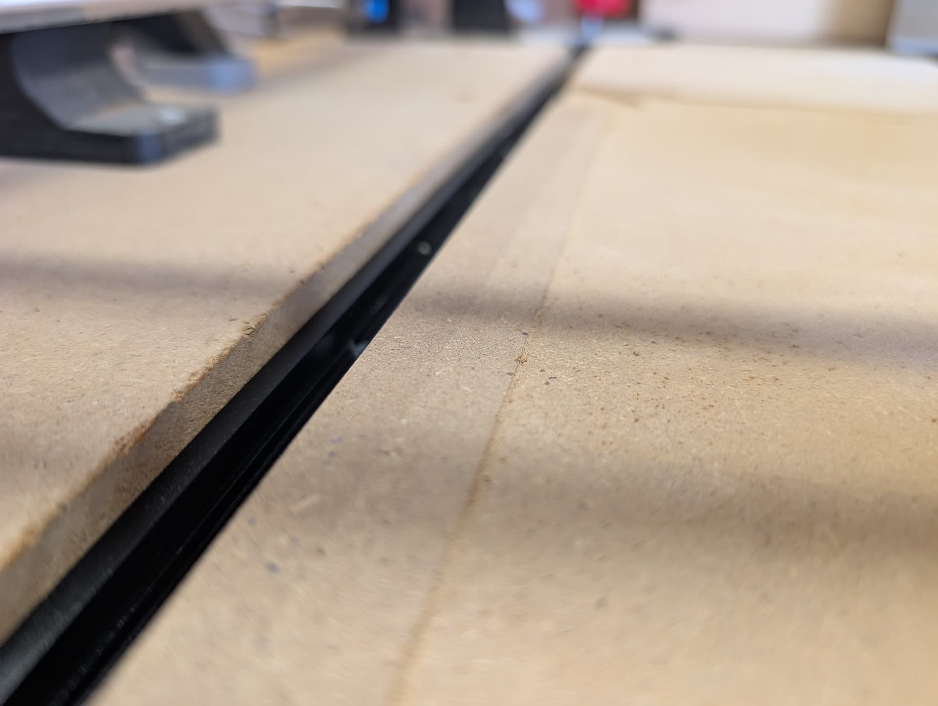

I am not sure how i woudl test that now since 1/2 the spoilboard has been surfaced down. I just checked and tried to align and the diagnol says its 2mm roughly higher when i touch down from what that corner was. but I dont understand how thats possible when the boards are within 1mm heigh of each other.
still doesnt explain going from 1mm to 6mm depth. I understand a little difference but where does the extra 4mm come from?
@GwenMakesThings It’s impossible to say what happend to that spoilboard after 3 years of being used as a storage table. MDF swells and shrinks with humidity and temperature.
You’re right, though. Since you have already cut the spoilboard down to close to the t-tracks, there is not much that you can do with this spoilboard. Replace it and start again is what I would do.
i understand it swells. the thickness of it on the left and the right is within 1mm
 and honestly its only close to touching the channel on one side. its still about 6mm away from the channel on the left and less that 1mm from hitting on the right. I can replace it but the path is slanted. the MDF spoilboard is level. the rails are level.
I understand all of what you are saying but isnt the one corner being substantially different the main issue? I will get new mdf and try again but the mdf on each side is the same thickness so I don’t think it’s going to solve the problem since only one corner is deep. Is there a way to check if my machine in racked in z?

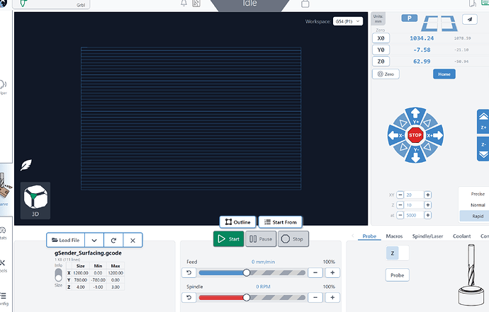

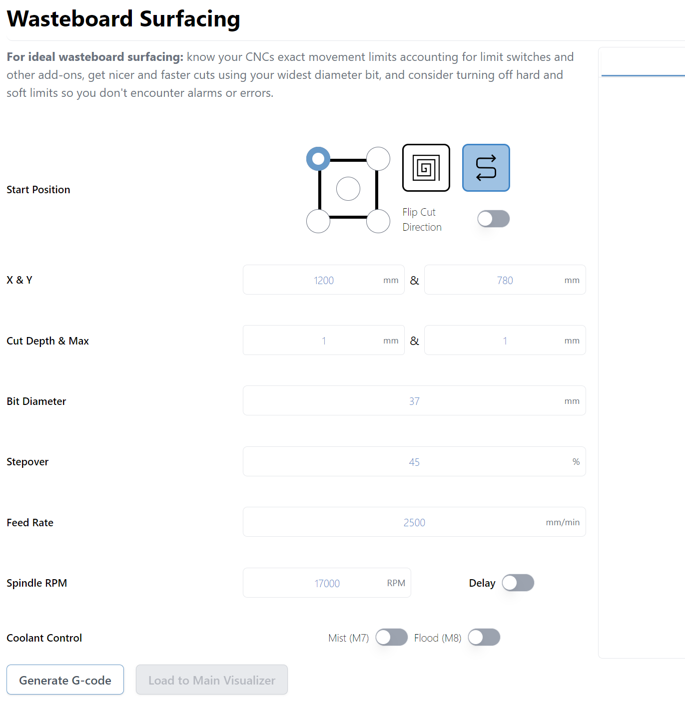

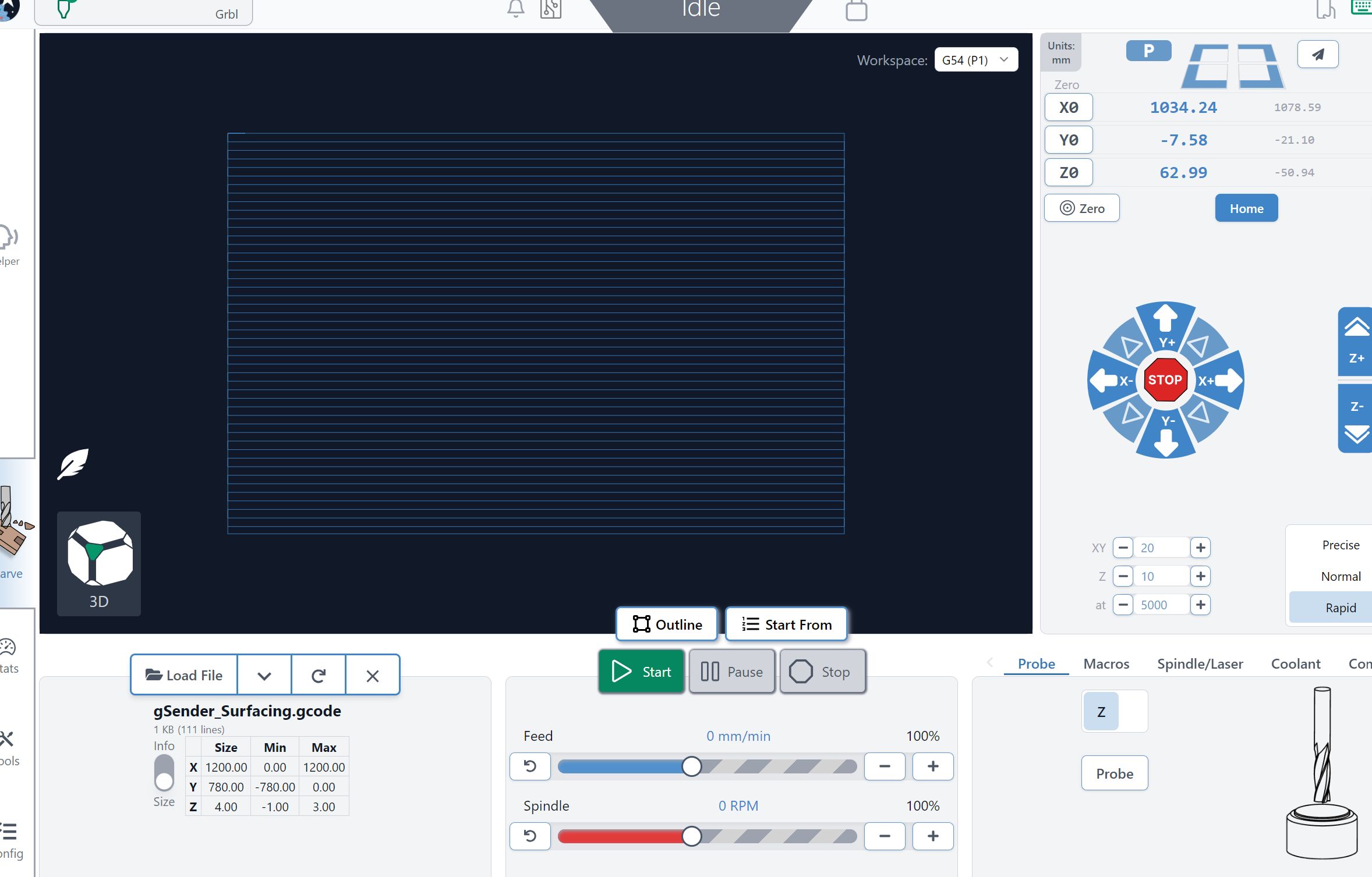

This is a screenshot of the program and the surfacing path. should i be concerned it says 4mm in Z?? cuz thats the issue ( I think) but I am not sure where its coming from
How can i check the z drive train?
I don’t think that’s a problem because it says min -1mm and max 3mm for a total travel range of 4mm.
