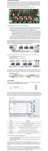

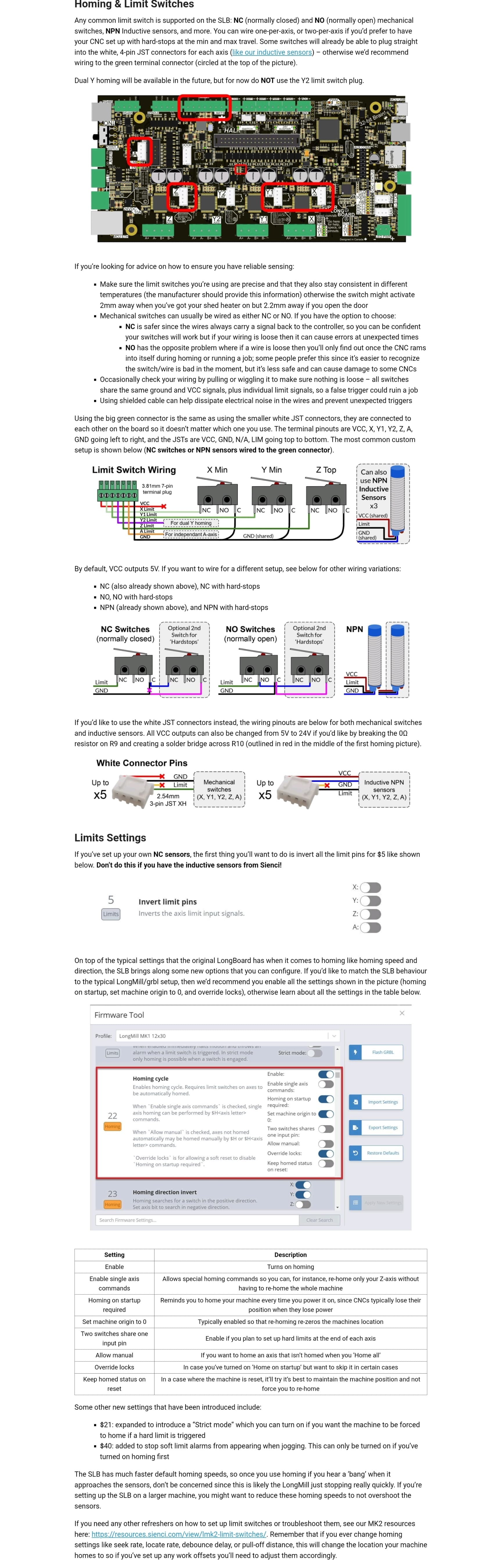

Hey Sammy,
Here’s info on limit switches and settings for them for the slb.
Found here:
Here’s info on limit switches on the older long board that is arduino based:
I believe the older lb boards needed a cap added to work, found here:
You can find a handy diagnostic tool within g-sender that shows activity on your switches (and some), this way you can look if gsender sees your switches correctly, found here:
