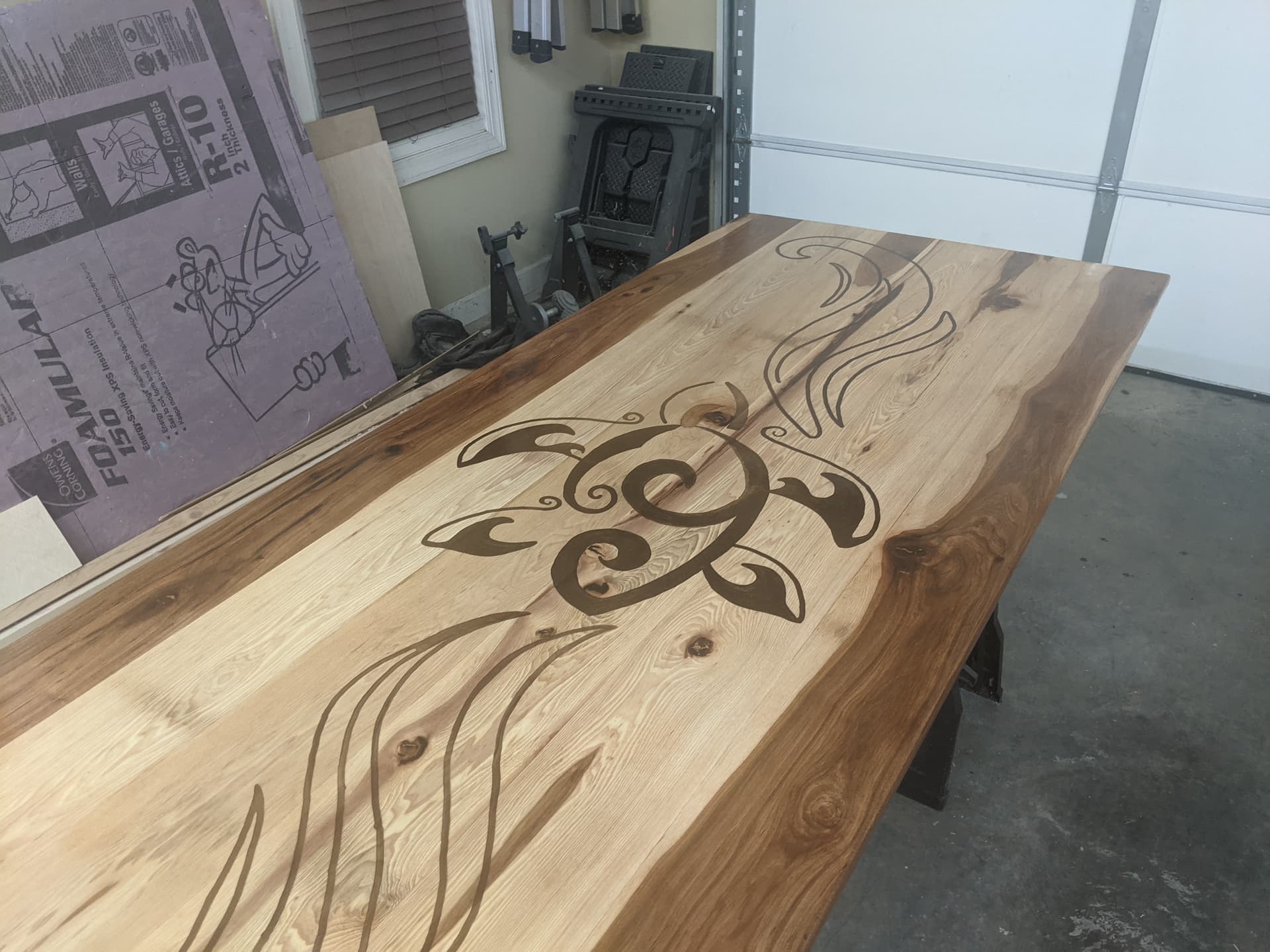

Wow! I really like that table. I can do inlays pretty well on my mill by I’d be lost without it.
I was not a woodworker when I bought my LongMill 30x30, before the 48x30 or AltMill came out. I did have some basic carpentry, design, and computer skills and those skills will transfer even if you end up using a different program for the CNC.
