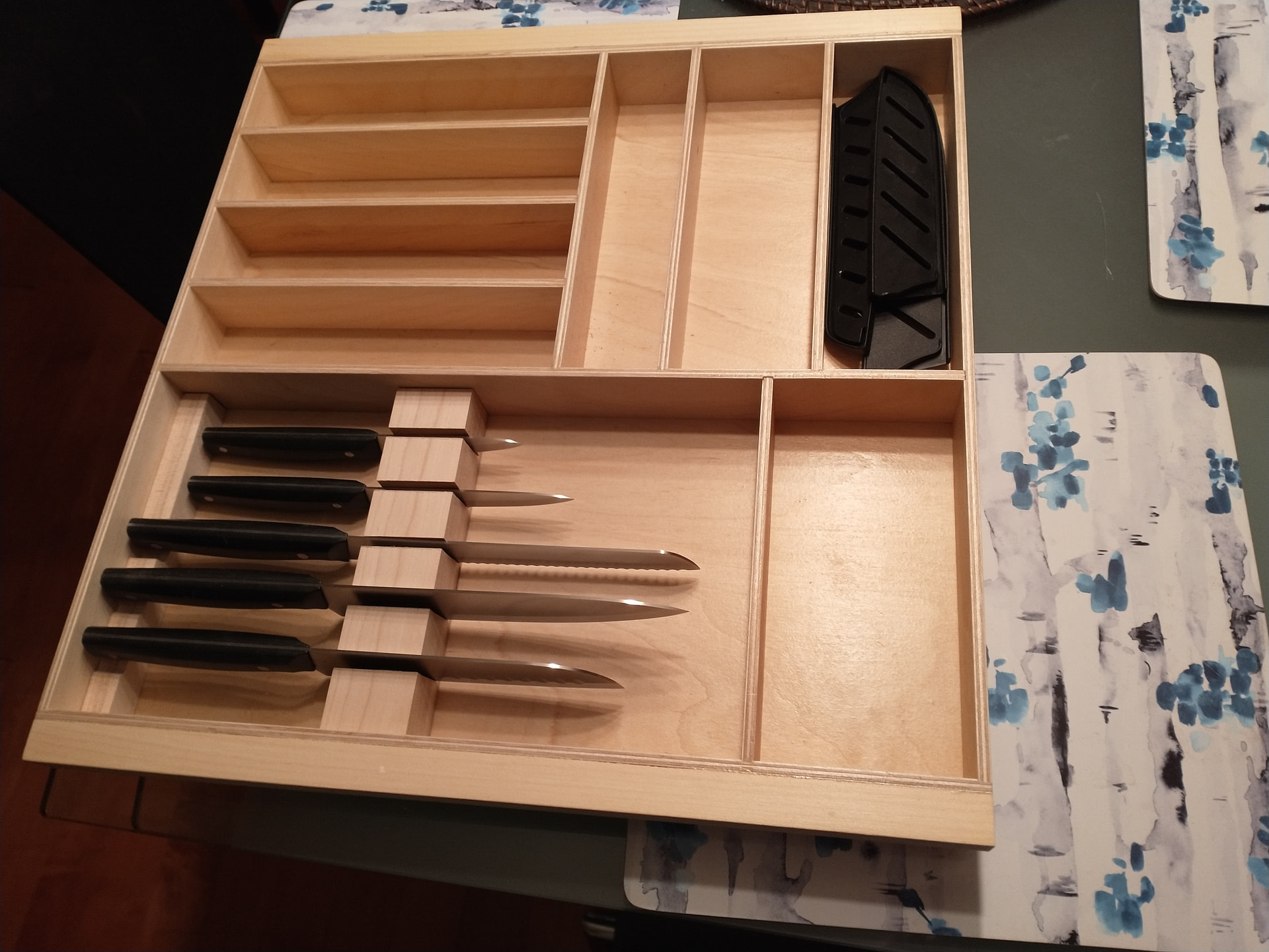

@Jens I know you have been having challenges with hold-down methods for plywood. I finally tried to mill some grooves in 6mm Baltic Birch plywood in order to do a cutlery tray for my daughter. It’s enough to make a grown man cry.
Plywood isn’t flat
Plywood isn’t even thickness
Spoilboard may not be flat (although it is still pristine since the last time I surfaced it)
Spent too much time trying to clamp it with double-sided tape, only to have it bounce back…and that’s after sealing the MDF spoilboard and plywood with WB poly.
I finally got decent results but it would have been nice to have a vacuum clamp and a surface mapping feature in gSender.

The problem is that you can’t ‘surface’ plywood.
Let me rephrase - you can certainly resurface it but what you end up with is a piece of unusable crap.
What you could do is to put the proud area on the spoilboard and use clamps to bring the sides (that are now proud) flat to the spoilboard. I have not tried this and I don’t know what the likelyhood is that the plywood is bowed in more than one direction where this technique would likely fail. I certainly would not be surprised about a multi-warp/bow situation.
@Jens it’s exactly as you suspected. Putting it concave side up is what I wanted to do but it curves in one direction along the grain but curves in the other across the grain. So even with all four sides pressed flat against the spoil board, I still had some bounce.

The final result. Sides will be trimmed with my electric planer on site to fit the drawer .
