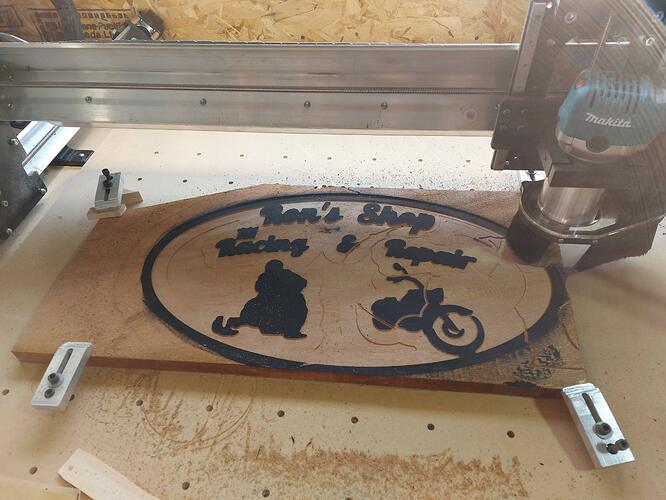

Today I started cutting another project (a sign). First toolpath ran fine (surfacing bit). Second tool path was a pocket with a 1/8th end mill. This was going to take three passes to get to depth. First pass seems to have finished fine. Second pass was in progress when I walked into the garage. I was zooming into the visualizer and then heard the sound of the router change as if it was cutting harder all of a sudden. I look up and sure enough it’s cutting out at the end of the board when UGS thinks it’s in the middle. Looks like it was about a 6 inch offset in the positive X direction. After my initial frustration :slight_smile: I hit return to 0 and sure enough it wasn’t at the corner of the board where it was before.
Jogging and rapids seem fine - and it was cutting fine for about an hour before this occured.
What would be causing the X axis to run too far forward in the middle of a cut?

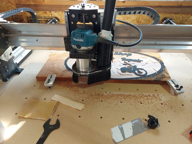

The motors seem to stay engaged, I’ve never felt them move at all whle changing. My real issue here is the random wondering while it’s operating. It suddenly ended up about 6" too far. This is with me not changing anything at all - it was just cutting fine and then it wasn’t.
I uploaded a couple pictures. The one with the router to the right is where it was when I hit stop. In UGS it thought it was cutting in the center of the piece. The one with the router to left is where it returned to when I hit ‘Return to Zero’. It should have went to the left corner of the board.

Do you hear the X-axis motor running, but the axis not moving?
If you can hear the stepper motor moving then maybe it is the coupler between the motor shaft and the lead screw that has come loose.
Not a bad idea at this point to go around and re-tighten all of the bolts anyway.
I’ll check all the bolts in the morning. Good idea.
It was jogging fine afterwards but I suppose it could be intermittent.
It could be the loose coupling on your x drive, I guess.
I had a look at all the connections and everything seemed fine. I swapped out UGS for cncJS and tried cutting again - after about 4 hours I had a sign. No issues at all. Neither this design or the previous where I had problems were overly complex, but none the less that seems to have solved my issue.
