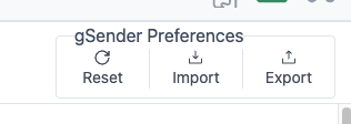

Incorrect. Shortcuts are exported and imported alongside gSender settings.

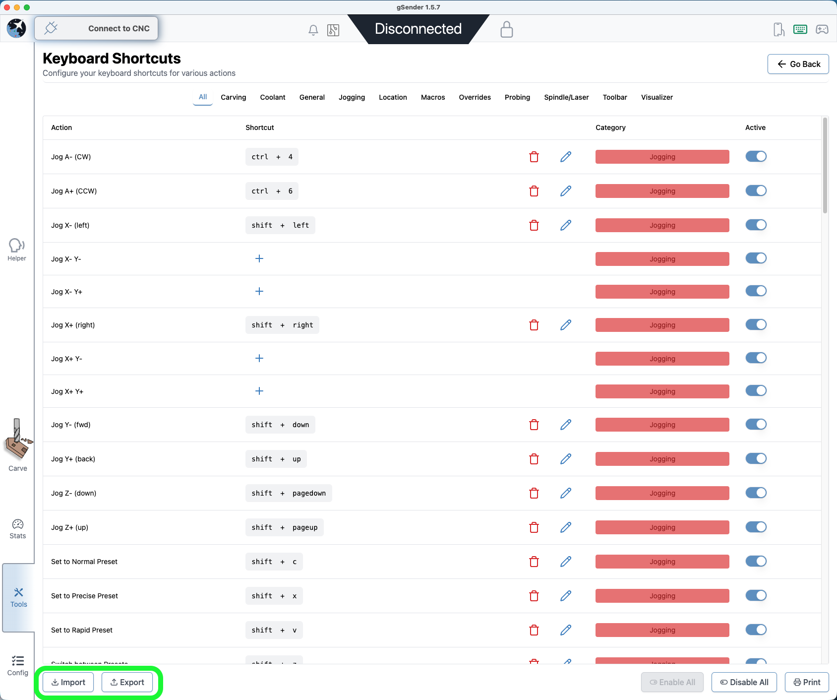

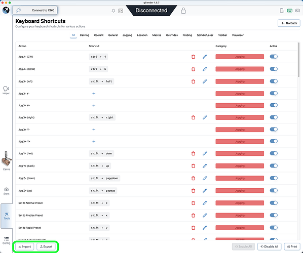

@gwilki @fljdave Happy to report that the import/export feature for shortcuts has been added on v1.5.7
Would also like to mention the shortcuts for probe tool selection scrolling have also been fixed on v.1.5.7.
Please let me know if you still find any shortcut bugs that are still present :slight_smile:
