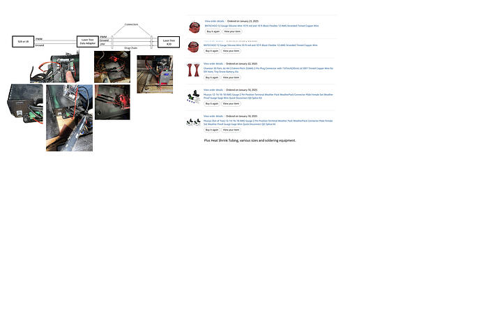

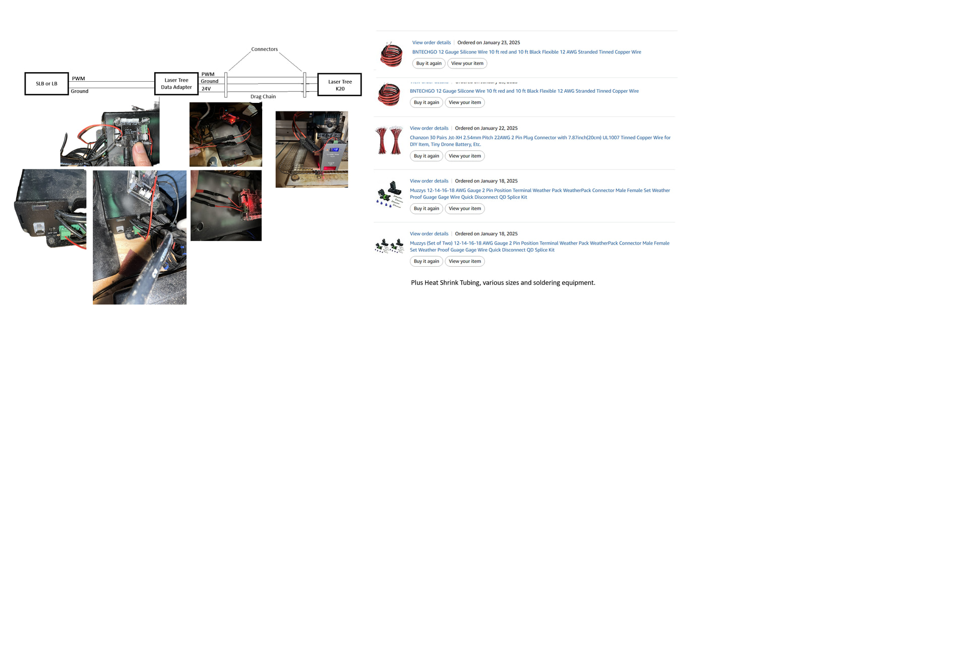

Hi Paul, I’m new to this but I read your post and shows that you bought a laser tree which is the exact same one that I just received today. I was wondering if you could give me any information on wiring setup. I do have a CNC rotor 30x30 from science lab. I have no idea how to set the laser up through the wiring system. Can you give me an idea or a photograph of the wiring? Much appreciated
Hi Bobby,
I’m not sure how well this will work, but I created a simple wiring diagram , took some pictures and created a mostly complete BOM and incorporated them in the attached .png file. If you have any questions let me know.
