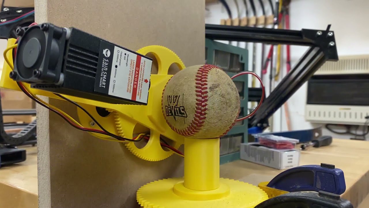

Picked up a 3D printer and it can print gears. I used the longmill to machine a pocket for the plate that holds the gears, designed a gear setup to move the laser head around the sphere. This is the proof of concept before I make the full enclosure with adjustable height. In the end, it is a 2 motor setup.
Now to make the full enclosure.

The devils logo would probably burn ok based on your laser and lens. I wanted the ability to wrap around the ball also, which this can do. This also (I think) will minimize the distortion of projecting onto the sphere, at least the squares and circles I tested with turned out looking like squares and circles and not ellipses like you get with a flat plane.
It’s over engineered, but that is part of the fun of this hobby, right?
Hey Jay, how are you powering your axis? And is it the laser moving or the ball?
I have an old Sainsmart laser kit that I stole the board and motors from. Both move, the laser in one axis and the ball for the other.

I drew up a model in Fusion 360 for the yellow parts and then printed them on a 3D printer. My first machine (before upgrading to the Longmill) was a Sainsmart laser, I stole the motor and control board from that (you can see the black extrusion frame in the back, I had not completely disassembled the unit at that time).
I just did a pinion gear to drive the motion (you can see one of the gears just under the laser. Overall it worked, but the weight of the laser was right at the edge of the motor capability. As it was, I had the change the GRBL setting to hold current always, otherwise the laser would drop. I wanted to improve the design with some type of adjustable height (different diameter spheres) but got bored with it and put it aside.
