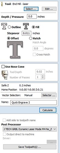

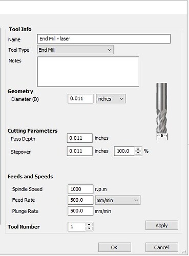

Guys, speaking of the JTech/Vectric pp. Grant, can you post/picture of your tool settings or the settings you used for the dragon. Also can we use the preview to see what it will look like? So far I canā€™t see anything of what it will look like. TIA
@Heyward43 H. Attached are a screen cap of the laser in the tool database and the toolpath settings for the dragon.

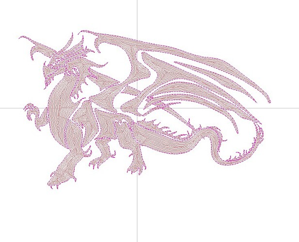

I used the quick engrave toolpath setting in VCP and there is no preview for it. However, I did two toolpaths, one fill and one outline. When you calculate, you get a pretty good idea of what you will burn. Iā€™m attaching two screenshots, one using fill and one using outline.
Thanks Grant. So I am guessing you are running it at 100% power at 500 mm/min. Is that correct? Iā€™m a little confused which parameter controls power?
@Heyward43 For the dragon, thatā€™s correct. The ā€œspeedā€ setting controls the power.
