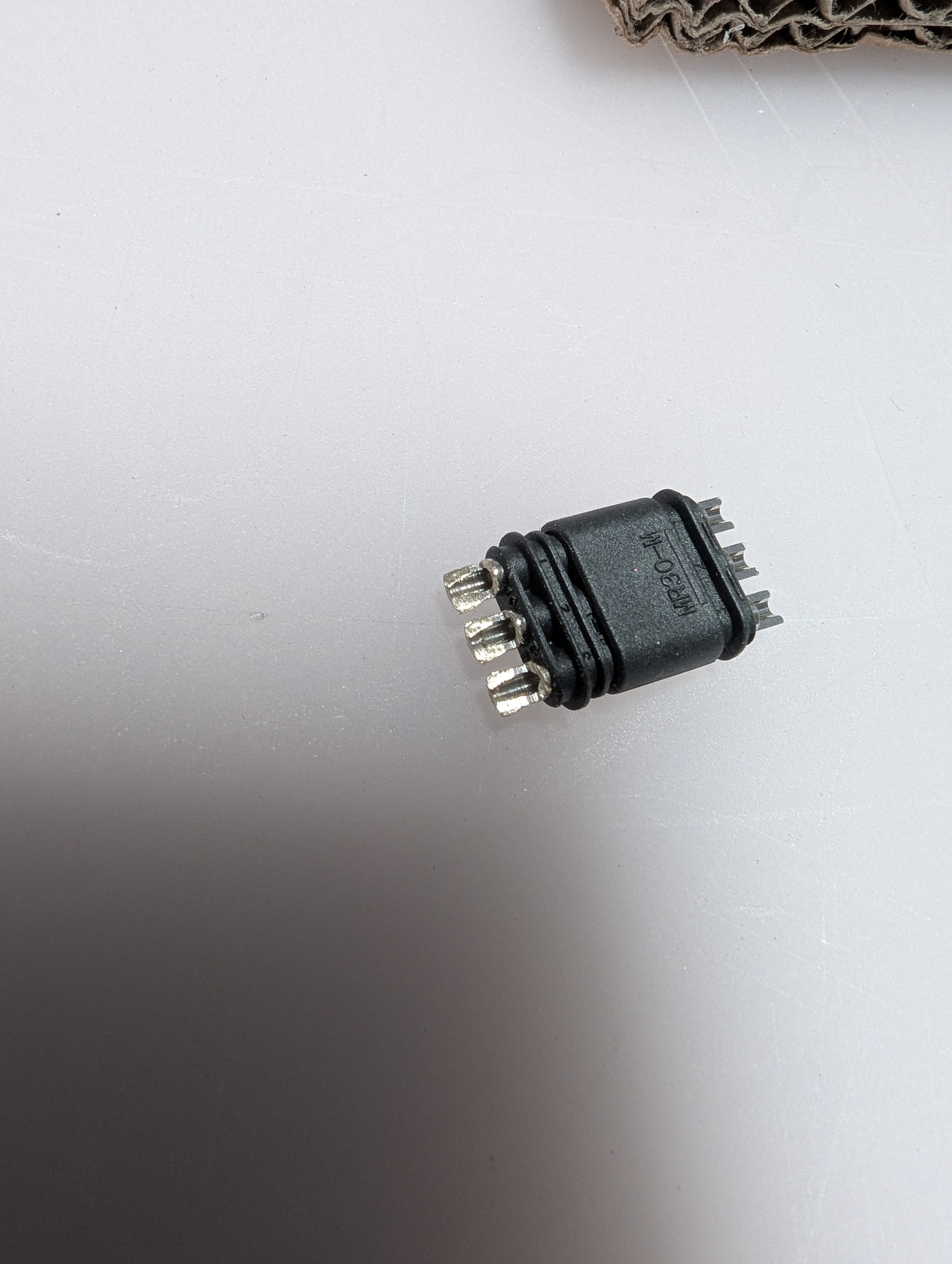

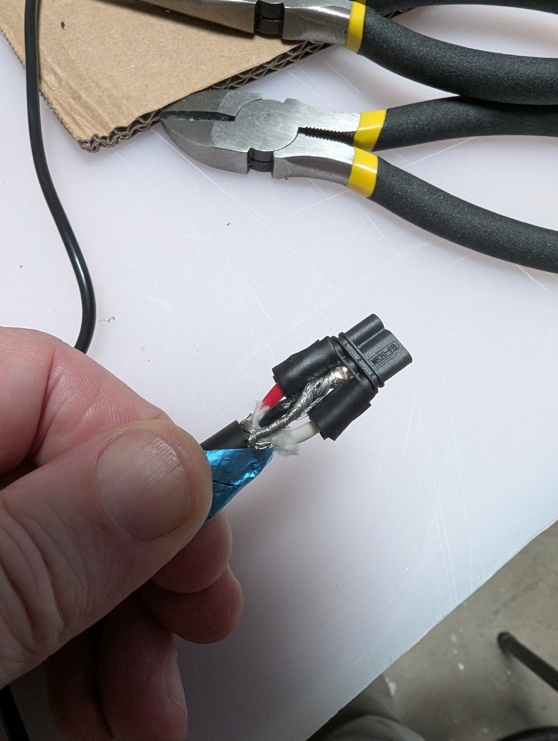

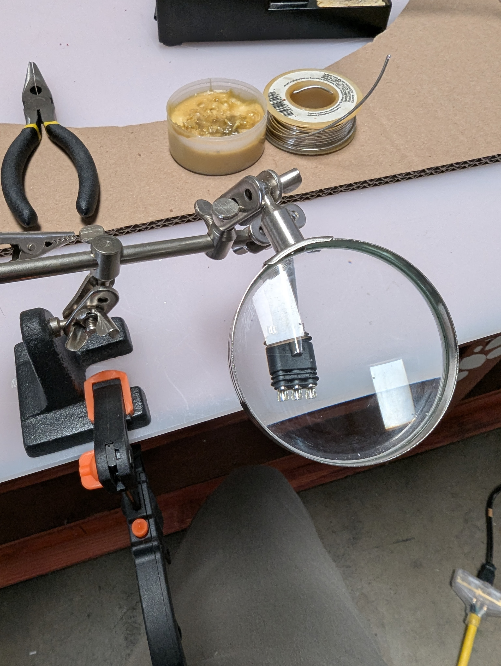

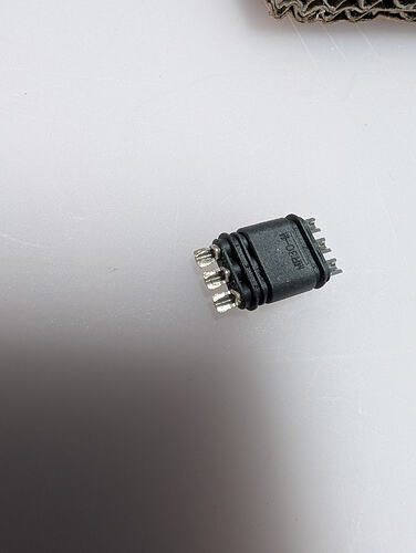

Now about the cable. K60 power is rated to 10Amp so given that cable length must be at least 6 meters I’ve decided to go with 16 AWG 3 conductor double shielded cable (https://www.amazon.com/dp/B0CR19VC9J?ref=fed_asin_title). MR30 connectors (https://www.amazon.com/dp/B0GJSBW33S?ref=ppx_yo2ov_dt_b_fed_asin_title) are recommended to use with 18 AWG wires (which are rated for less than 10A) so soldering connectors was a challenge. The connector is rather small so you’ll need some “third hand” to hold it while you manipulate the cable and soldering iron (see pictures). I recommend to partially file the metal so it’s more flat and makes soldering easier. I had to crank my 100W soldering iron up to 400 C so it could quickly heat up the solder without destroying the connector. I recommend to put some blobs of solder on both wire and connector and then quickly heat it up. It does not produce the soldering quality you’d normally after as the solder does not envelope the entire connection, but it does produce reliable result. You’ll have only one try with each wire as trying to unsolder it will require to heat up the entire metal part of the connector and it will likely ruin it. I did ruin a couple of connectors until I’ve figured this out. See the pictures.
I’ve soldered the shield to the GND on both ends of the cable which is a normal practice when dealing with high frequency noise. Soldering at one end usually used for lower frequency noise. When I’ve tested the cable there were still some small noise visible on oscilloscope. It would probably be OK to ignore that, but I’ve decided not to take any chances and also soldered 1mkF capacitor between GND and 24v wires as part of the cable. I did not want to modify neither laser module nor the adapter board.
I recommend to spread out the copper threads of the GND wire and shield threads, mesh them together and tightly wind them up together before putting solder on it. If you wind them up separately then they will likely to separate when you try to solder them to the MR30 and you’ll ruin the connector trying to fix that.
