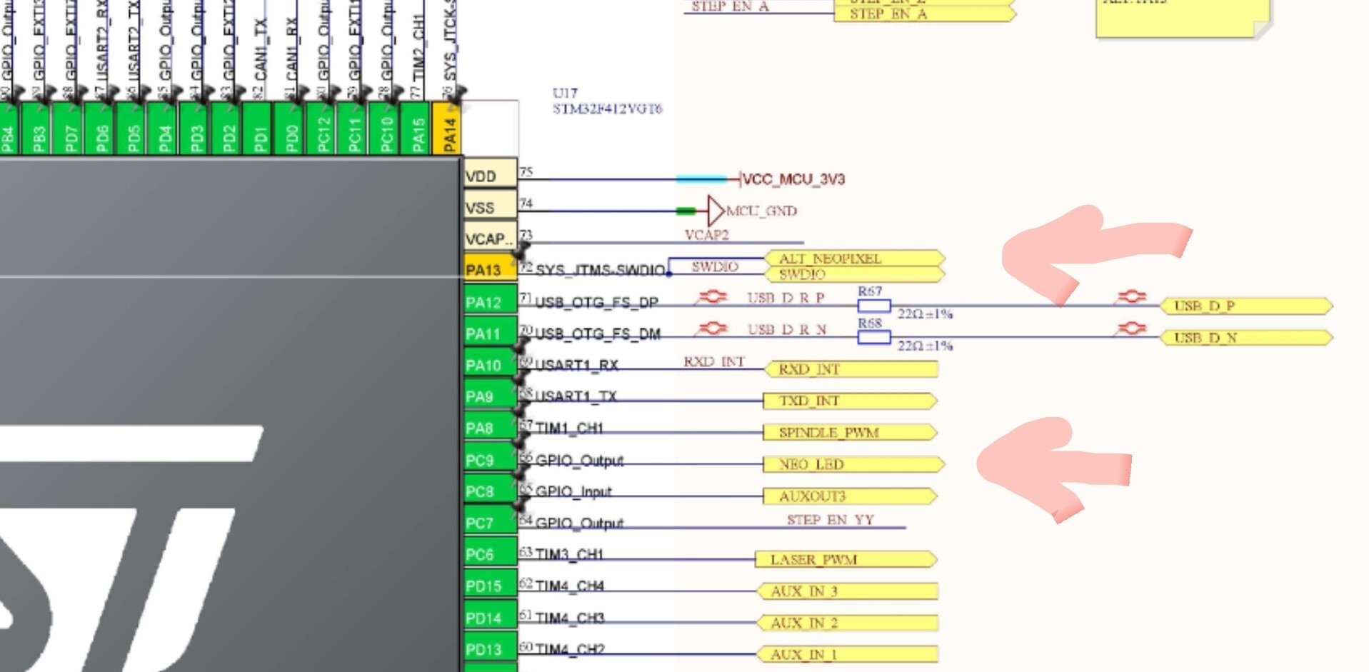

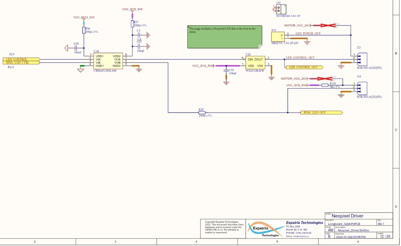

Although unlikely, something can be down at the software side. It might however be that something is scewed on the board. I looked at the github schematics (they actually worked after months of no reaction) and I found that the ring and strip have seperate data lines comming from the cpu. You could look at these components (IC14, IC28 and IC17-pc9) to see if all solder connections are looking solid.
The best route to take is indeed getting the siencitists involved.

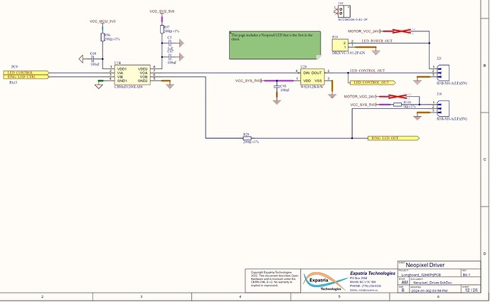

I went to the schematic as well - and I have convinced myself that this isn’t a ā€œboard solderingā€ problem - the RAIL strip lights the correct number of LEDS when I change $665. For this to happen, the power and ground lines mist be correctly connected, and the data (led control out) must also be connected.
There may be a problem with the onboard LED though - or more correctly, the shift register/LED driver chip inside it. One of the common-on-the-intertubes suggestion when searching for ā€œWS2812B displays whiteā€ is that ā€œthe first LED on the strip might be badā€ - and the recommendation is to cut it off and start with the second one.
  • Corrupted data: The LED may remain lit but cannot properly process the incoming data. It could then send a corrupted or ā€œstuckā€ data signal to the next LEDs, causing them to flicker or display the wrong colors.
  • ā€œStuckā€ pixels: An LED may freeze on a specific color or brightness level and not respond to further data commands.
If that first chip had a ā€œstuckā€ problem, the rationale goes, it could be corrupting the content of the data packets it passes through without corrupting the overall packet format.
In this use case, that first LED is on the SLB and seems to be working correctly.

Referring to the schematic (above in this thread), I suspect that the difference is the signal integrity and drive capability of the RING circuit versus the reliance on that of the onboard SLB status LED used in the RAIL circuit. If this is so, your milage may vary due to the manufacturing differences between WS2812B devices.

I haven’t had time to patch in a test ā€œrepeater LEDā€, but after looking at the SLB schematic, where the only real difference is that the RAIL signal is driven through an onboard WS2812B chip first, there is weight behind the conclusion that WS2812B chips have a lower drive capacity than expected/desired :frowning:
