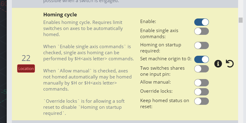

I have a Longmill MK2.5 that I just bought and installed homing switches. I’ve confirmed in console they are triggering correctly. I have them positioned for left front home. When I home the Longmill (to the front left corner), the machine coordinates under X and Y show a machine zero of the far right corner, and if I hit “go XY0” the gantry moves to the far right corner. I read others saying that the bottom left homing positions can be set to 0 along with machine position (grey numbers). I am having problems running into Alarm 2 soft limits even though I have correct settings in firmware for 130-132 and the jobs should be well within the soft limits.
From reading this post (Absolute 0 after homing? - #5 by AndyCXL), I think this is the default GRBL machine position. Is this correct? The last post says this behavior however was changed in firmware. The links I can find for GRBL firmware (grbl Firmware 🤖 - LongMill MK2 CNC) only are valid for the 2019 version as I was thinking of flashing the firmware if necessary.

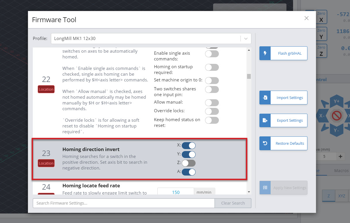

Hey @Elmo,
You can flip the direction you home in by going into the firmware settings and finding $23. Here you can make X and Y go in a negative direction, by flipping their toggles.
In this picture you can see I have X set to home left (negative), Y set to home front (negative) and Z set to home up (positive).
Cheers,
Stephen
Hi,
Just to clarify, default GRBL firmware behaviour is that machine 0/origin after homing is ALWAYS the back right corner regardless of which corner you home to. This is just CNC convention so every job is always entirely in negative space.
If you want machine origin to instead be the corner you home to, you need to enable the “Set Machine Origin to 0” option in $22 in the firmware tool.
The second little thing I noticed in your post is that you used go XY0 - this movement is in WCS (the large blue numbers), not machine coordinates, so will go where you set your workspace offsets, not the machine XY 0. I’d read the following if you’re unsure of the difference between the two but suffice to say machine coordinates are the internal representation of where the machine is in physical space vs WCS being offsets of that internal representation.

Thank you. Changing that 22 “set machine origin to 0” did the trick. I do understand after some reading the difference between machine zero and workspace zero. I would imagine that having your homing and machine zeros differ really shouldn’t matter as jobs are going to run based on workspace zero anyway. It just threw me off that the machine zero changed once I installed homing switches to the rear right corner. It would be helpful if Sienci included this tidbit of info in their notes and video of homing switches installation. I ran across a few other threads where this caused confusion also.
As for the XY0 thing, I don’t know why I was getting confused because of course you’re right that XY0 is workspace or homing zero.
Now this is strange. After changing that 22 setting (and re-enabling 20 soft limits), the CNC has changed its traveling area. It wouldn’t go over X 740mm x Y 800 (30" x 30" Longmill), but now it is traveling X 800mm x Y 845 (machine 805 x 850mm). I am completely miffed as to why. I knew it should travel further than it was as there was still length on the X and Y rails, but it wouldn’t no matter what I did.
I have 23 inverts set exactly that way for a front left home, which is where I set my homing switches
