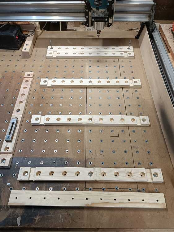

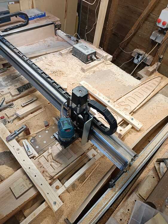

Hi Derekh,
I was summoned to this topic and can only say that I do not use a classic spoilboard, but use individual spoil strips that are fast to surface, easy to replace and cheap to reproduce.
Mine come with fence sloths and double as a glue up station with overlapping clamping bridges.
But the one reason I have it like this.. yeah.. cheap.. me..
@Spamming_Eddie very interesting and interested… BUT now you have more ideas in my head to choose from lol…
So you use these as a fence and can add clamps to the fences if needed… hmmmmm guessing you use thin mdf under the project for those times you cut through the project?
Nope, the strips are the spoil boards, the project rests on them. When I use cut through toolpath, I zero on one of the strips so they don’t get hurt too much. This section is my tiling jig but they integrate with the rest of the strips on the machine for horizontal milling projects too.
And here I abuse it as a glue up station.
