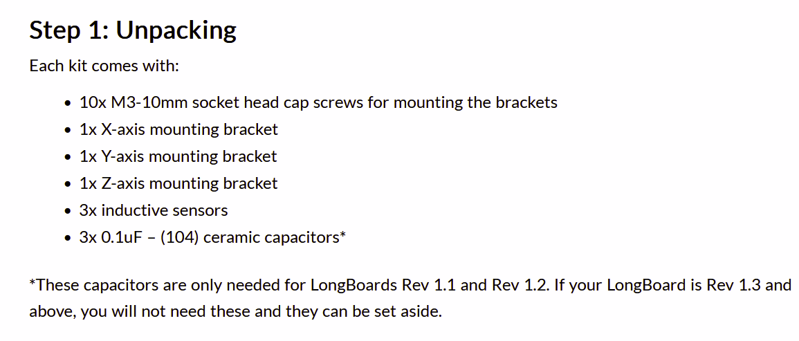

Thank you for responding. I will definitely upgrade my usb cable. I’m wondering if there’s any evidence of static discharge affecting the limit switches? It’s the only thing I can think of that would trigger them when the spindle is no where near them, specifically the z axis?
It certainly can be triggered by static. It’s more or less a transistor with the base triggered by.. oh wait..
What version of the Longboard do you own, if you have a loingboard?
If you have a older version than the 1.3 you need to add some ceramic caps.
I have the MK1 with the Longboard Rev 1.4.3. If I understand correctly I do not need ceramic caps, is this correct? I have bought a new USB cord and will ground my dust collection hose. Hopefully that will fix the issue.
