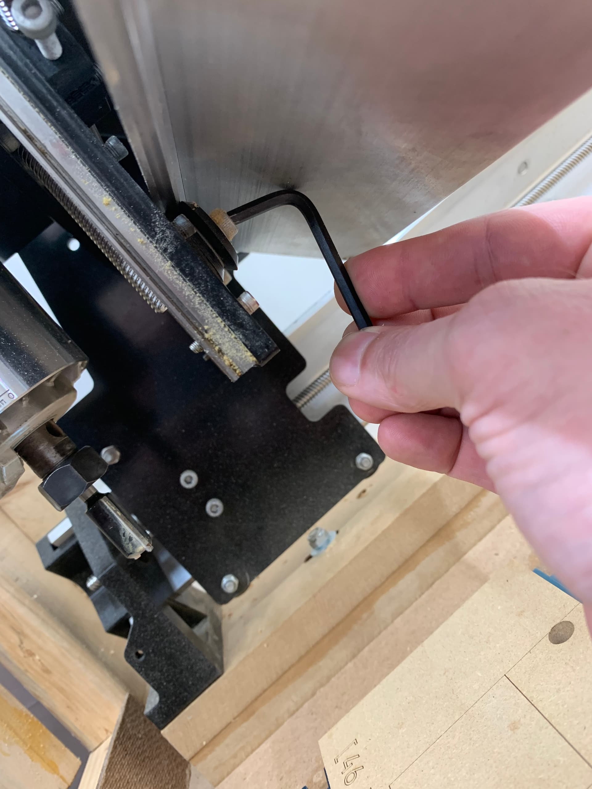

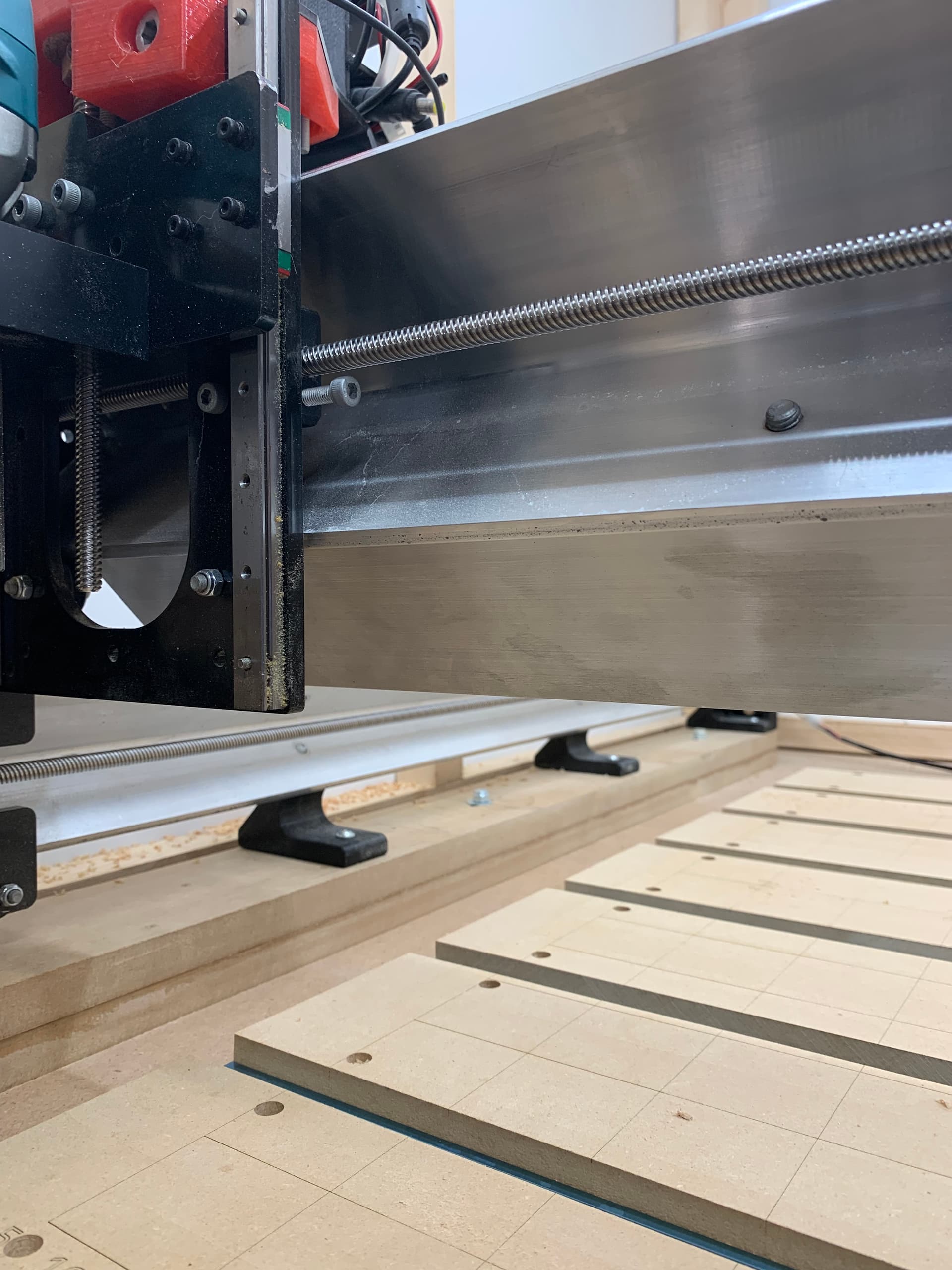

On the Y axis gantries of my Longmill, the eccentric nuts used to tension the v-wheels are on the top of the gantries. Would it be better to have them on the bottom? It seems to me that as it stands, adjusting the eccentric nuts would put the spindle out of tram.

I have a LongMill Mk1 and the following is just supposition on my part. The original LongMill used a simpler frame design with a stiffener on the X axis.
The way that stiffener hangs down makes using the provided hex key impossible. I could cut it a bit to make it work though.
So maybe they were all put on the top originally to be consistent and just never changed. This is just some wild guesswork on my part but it seems reasonable to me.
For what it’s worth, I don’t see any problem with putting them on the bottom.

Can the eccentric nuts be moved to the bottom? Are the top holes made larger than the lower to accept the eccentric nut? A quick look at a replacement Y axis gantry plate for my Mk1 and the top holes appear bigger. Looking at onshape for my mill and the lower holes have a diameter of 5.2mm while the upper ones are 7.32mm so I guess we’re kind of stuck with having them where they are.
