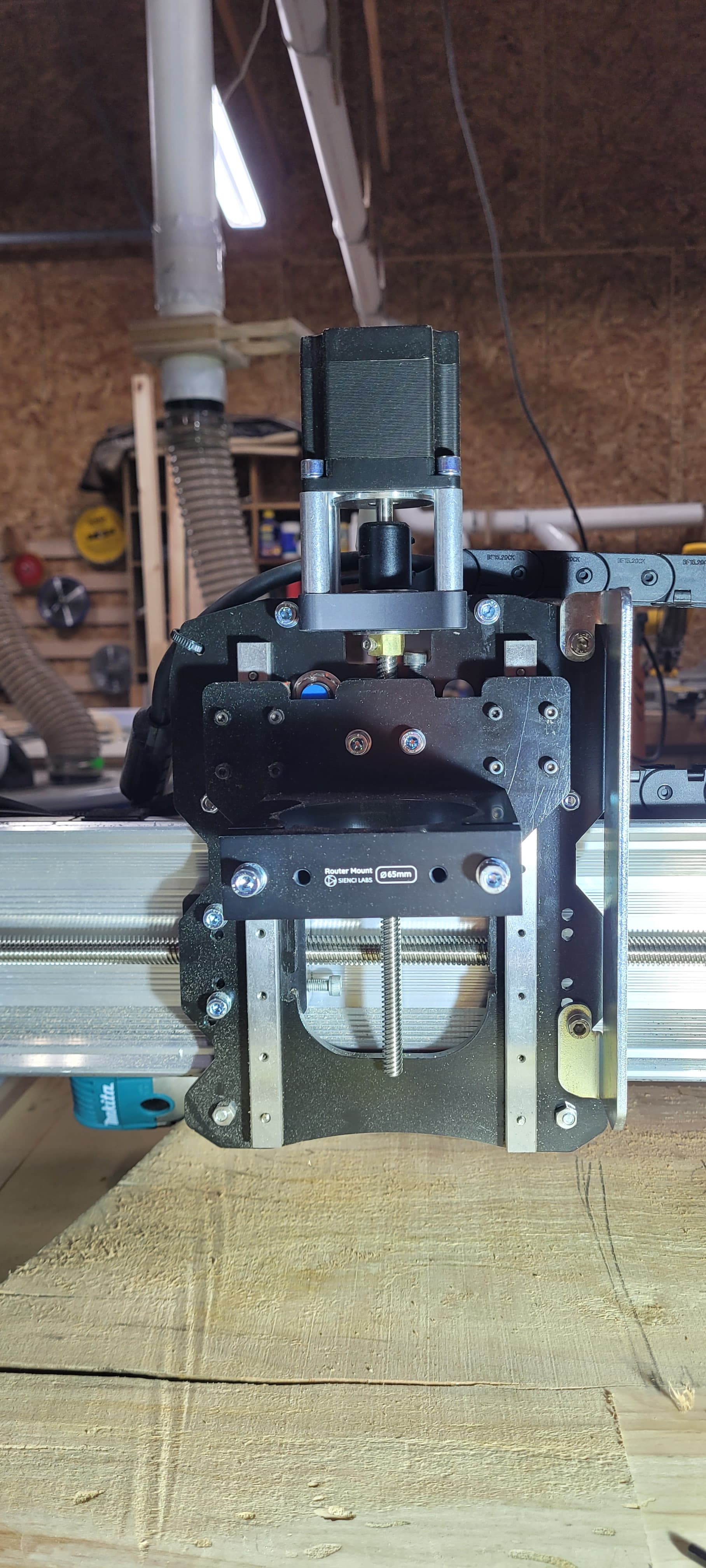

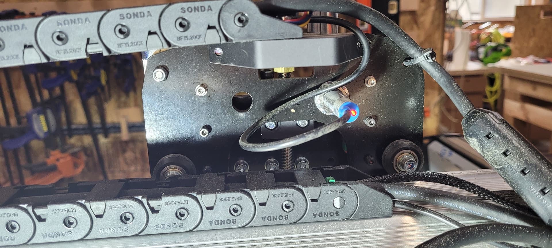

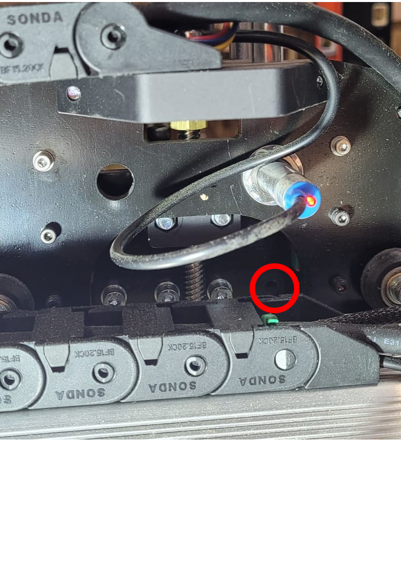

I have the 48x30 Mark 2 and have been surfacing some slabs. Worked great until my router took a bit of a nose dive and cut too deep. Prior to this I noticed a bit of vibration or quiet growl from about 24-36" on the X axis. I chalked it up to the wood in that area (maple). The job will be fine BUT I have a 5mm machine screw that fell out just about the 24" mark and thats where the nose dive started. I jogged back over to surfaced area and verified my router is headed downhill on the X axis. A few little bumps and the cutters contact the surface (have clearance to start). The rail itself seems fine. I’m thinking it’s a gantry or lead screw issue, and the M5 screw is the key. Uploading a couple of pics. I am kind of to the point of reverse assembly. Going to watch some videos. Any ideas appreciated.
Hi @Ump98,
The screw is from the router mount.
Another issue I see is that the screw on the the anti-backlash block looks to be hitting the lead screw nut when raised all the way.
The limit switch will need adjustment to stop the Z gantry a bit lower for clearance.
Thank you so much! My eyes arent what they used to be, but that makes sense. I will take a look at your recommendations tomorrow. Lot to learn here.
CJM Sharp eyes. Thanks again. The screw on the backlash block was too loose. Not sure if I failed to toghten or it worked loose.
The threads on the M5 screw were damaged, so I replaced it. I need to replace the router and check travel and tram, but hoping this solves the problem.
