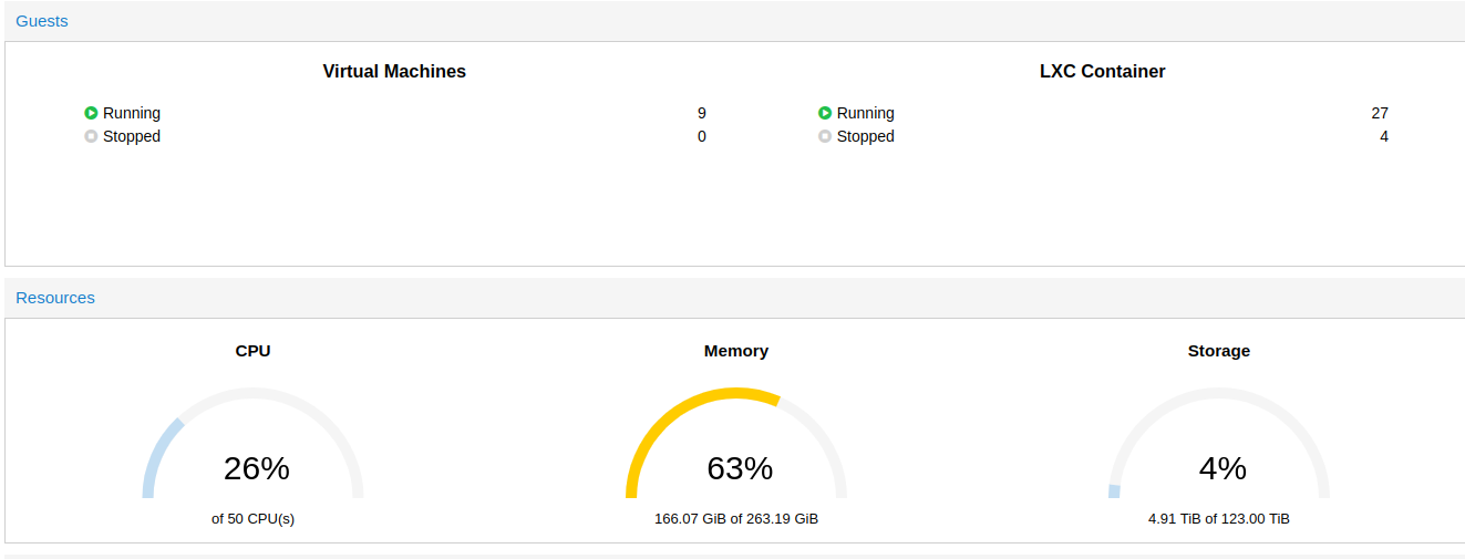

I think it is good to have a machine dedicated to connecting to the SLB to run gSender. In my case, I have a ProxMox server with a number of Linux virtual machines, one of which is a Debian Linux VM dedicated to gSender. I access this server using remote access tools such as the very poorly named free Windows App (from Microsoft). You could certainly dedicate an older Mac mini or similar to this function.

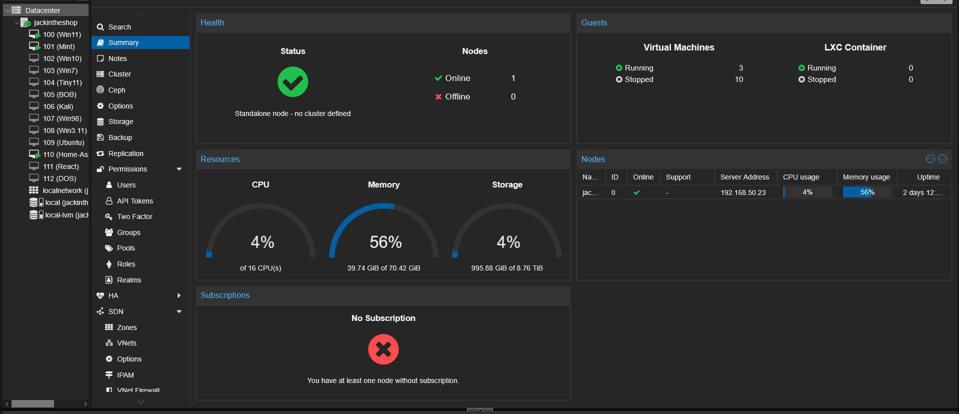

I just got the email for this post. So, I am late to the party. Looks like a great range of answers already. So you already know about Parallels.
I will say, if you do go with a Windows machine just for this use case. I mainly run Linux myself. I do run Vcarve and Fusion 360 on a small mini PC that is loaded with Proxmox.
Proxmox is a headless server that allows you to remote in and spin up VMs and containers. I use that as my file server, Home Assistant, Plex server and other handy VMs.
That said, Vectric Vcarve Pro runs just fine on an old i3 with 16gig RAM. No need to build a super computer or a gaming rig with a high end GPU.
Good for you on ProxMox - gotta love ProxMox. The electric company loves me :slight_smile:
I didn’t mention that as I wasn’t aware of the OP’s background/knowledge base on hypervisors. I too have a Windows VM but decided against running Vectric and some other software on it due to the lack of a viable passthrough GPU for it. If I ever add an extra GPU I may revert back to it though.
I started to use Windows VM on my newest install. I just got a decommissioned Dell D160 Gen9. It only has 72gig RAM and 8TB SAS with a single 16core chip and 1 empty socket. But it was free so… I just moved all my Proxmox VMs to the new rack mount. I need to put one of my power meters on it from Home Assistant to monitor the power flow.
PS. Don’t OS shame. LOL Yea I got everything from DOS to Win11. and the XP machine has MS BOB on it. LOL
