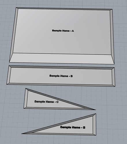

Getting ready to make my Altmill order, I have some work flow questions.
I have an experienced CNC user that has another brand machine and has suggested a few paths for my work flow. Running it by the pro’s here to dial everything in.
I am a Mac person that does all my drawing work in Rhino. A lot of my work will be either 3D type carves or flat pieces of PVC foam board with custom shapes and miters cut into them, photo below. From what I understand I have two options, well probably more options than that.
For the PVC projects-
  1. Rhino Mac / import STP into Fusion Mac, generate G-code / send to CNC attached to a Mac or PC
  2. Rhino Mac / import STL onto V-carve Pro PC, generate G-code / send to CNC PC.
Any advise will help.
Thanks in advance.
@jBones I know almost nothing about Rhino, but I can say that if you are going to include VCarve in the process anywhere, there is no value in using Rhino at all. The shapes that you have attached can be done very easily in VCarve in minutes. From VCarve, you would use the grbl mm or grbl inch post processor to create gcode and gSender will read that.

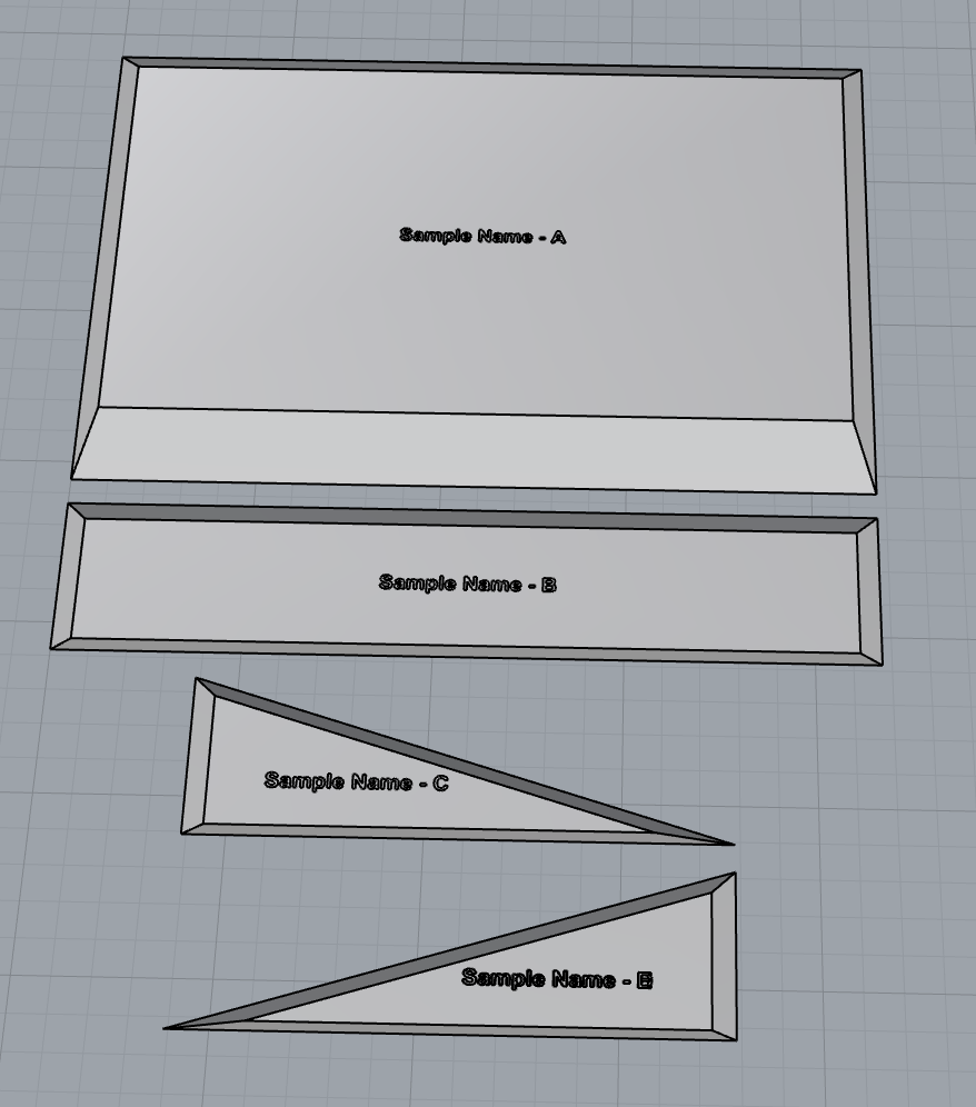

This is just a small sample of what I draw and find Rhino far superior to Fusion, in my opinion, for drawing very elaborate organic shapes, most of which get sent to a 6 axis machine to process. For this particular use I have a script in Grasshopper/Rhino that makes parts for me by entering a few quick pieces of data. I this case it is a mold for my concrete casting process. The script then slices the mold into individual pieces, lays them flat and nests them on a sheet for cutting. Each part a different size and draft making each piece to be cut with dimensions and degrees of miter. I can do 10 molds in a matter of minutes producing the parts I need as well as the appropriate final renderings, layout drawings and labeling for the rest of my processes. Basically these pieces are drawn out automatically in the process. I just need to know how to introduce them to the work flow.
In a perfect world I would export as STL, open in V-carve and go to town, didn’t know if it was that simple.
@jBones IMHO, in VCarve, you would want to start with an svg file, not an stl.
Thats cool, does SVG include all the 3 dimensional information needed?
@jBones No, SVG is is just a 2D vector graphic.
vCarve will handle an STL file like any other 3D model. Import the model, create a clearing and finishing toolpath and you’re done.
If you use an SVG, DXF, or create vectors directly in vCarve, then you have a multitude of toolpaths to select from. It’s more involved than using a 3D model but easy just the same. And whatever you carve would probably be called a 2.5D project as opposed to a proper 3D project.
If you work with a model, that’s what you will carve. If you use vectors, you can modify the tool paths depending on the end result you are looking for.
But if you are going to use Fusion and a STL model, no need to use vCarve. Fusion will create the g-code for you. But I find that it’s easier to do in vCarve.

@jBones Part of the issue with these discussions is the vague and frequently contradictory terminology used in the magical world of CAD/CAM.
I guess that I’m simple To me, something that has length, width and height is 3 dimensional. The CNC world seems to have invented a creature not found anywhere in nature or real life - 2.5D. They don’t stop there, though. Some refer to 4D projects. I’ve asked, “what is the 4th dimension”. I’ve yet to receive a valid answer.
In your case, without seeing the projects, I suggested svg rather than stl only within the context of using VCarve. By my definition of 3D, you can easily create 3D projects from svg files. The will have length, width and depth - ergo, 3D.
Many, many users of VCarve create projects using the CAD/CAM definition of 3D, when it is not at all necesary for the end result and most of the time is much less efficient than using what Vectric refers to as 2D tools.
Enough of my blathering. Good luck with your projects. As has been said, I don’t understand the benefit of bringing models from Rhino or Fusion into VCarve. However, each to his own.

To go back, the point that I was trying to address with the OP was that the pics that he posted showing what I understand are molds could be done much more efficiently using vector files than model files. I realize that may not be true for all the jobs that he does.
I also understand that we all work differently. There are no absolutes. I was simply saying that I don’t understand the concept of designing in one CAD/CAM and exporting into another CAD/CAM project if the first will generate the necessary gcode for the machine. I dabbled with Rhino 5 some years ago when the shop bought a Laguna CNC lathe. With Rhino 5 and Rhino Cam, it would have been counterproductive to include VCarve into the job process.
