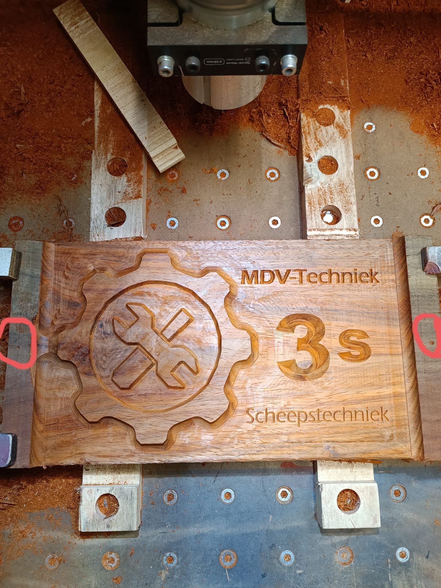

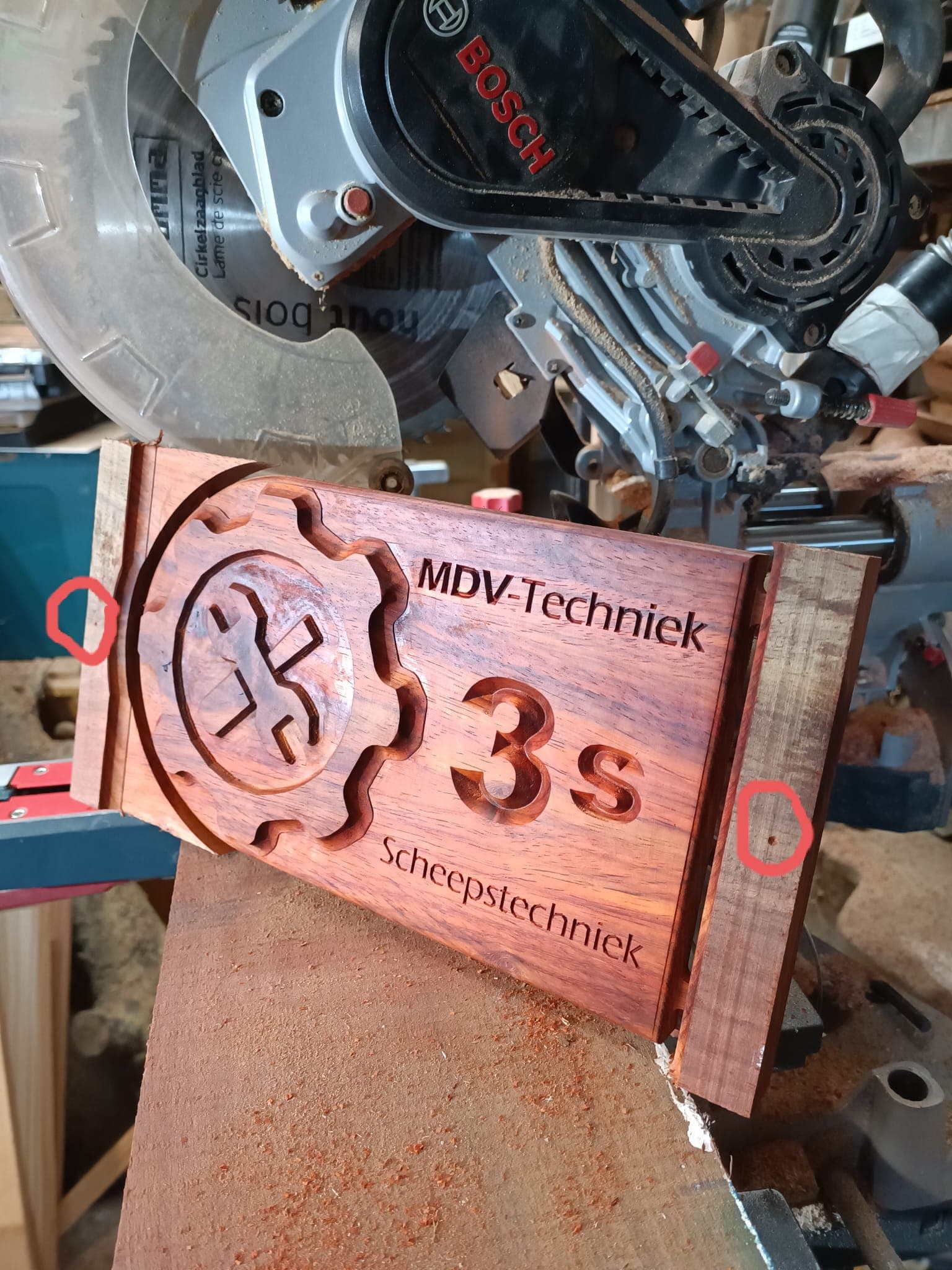

Two v-carve dimples is all you need to recover a project that otherwise would be lost. I have them usualy on y=0 and x=offset(a). If I am not lazy, I’ll even write a close to the dimples, else I need to measure between the two dimps to know my xy0-offset.
It’s not much, but it’s better than having no way to recover.

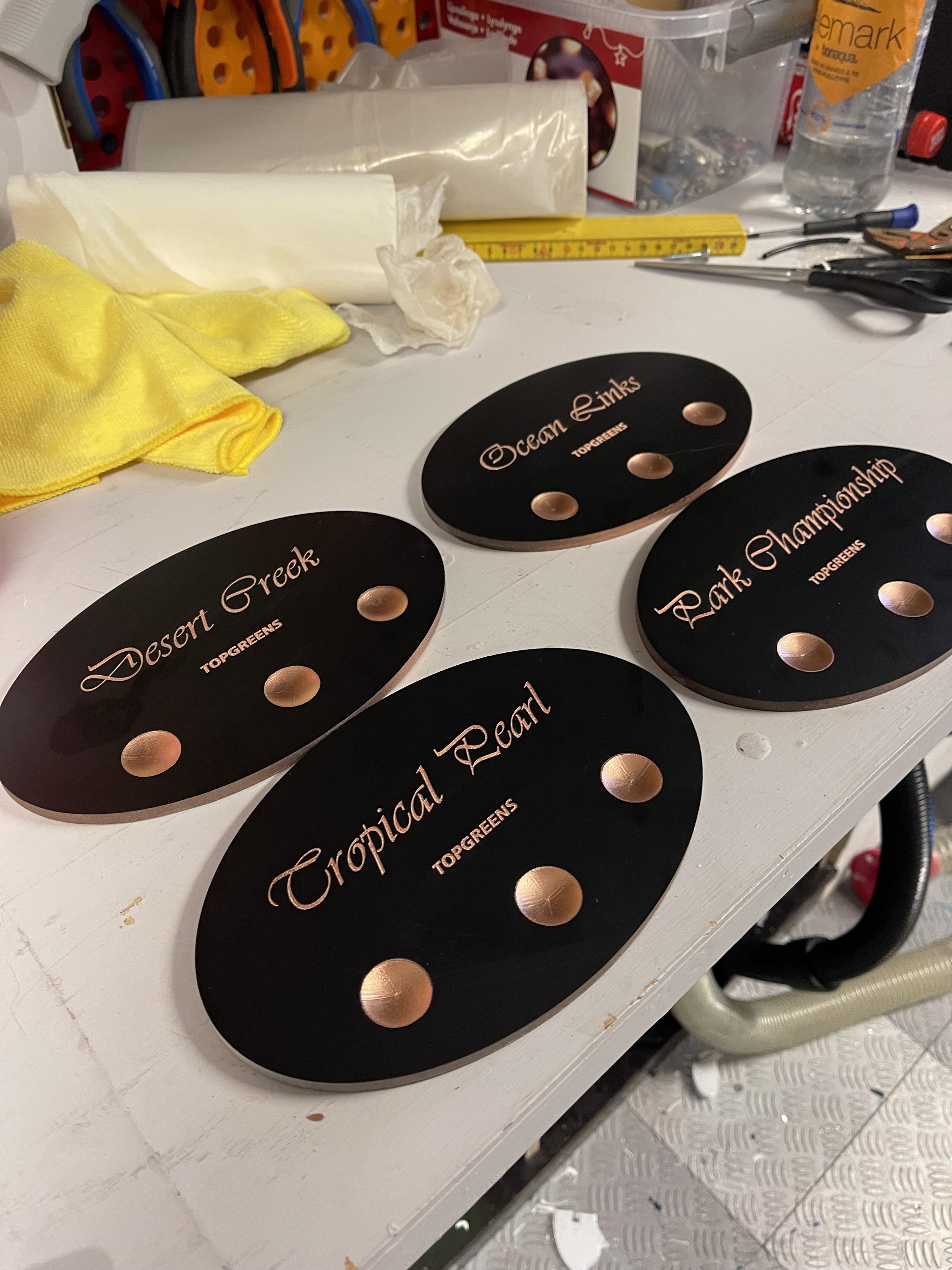

sveininge79 – do you mind sharing what that material is the photos? Looks great.
Its composit core and thin alu on both sides. usally used on building fasades.
