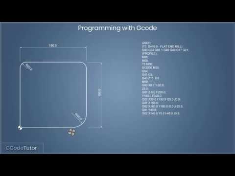

Learning to write g-code by hand provides a great learning experience. There are many examples out on you tube, here is one organization which provides courses to help you along.
There are others …
