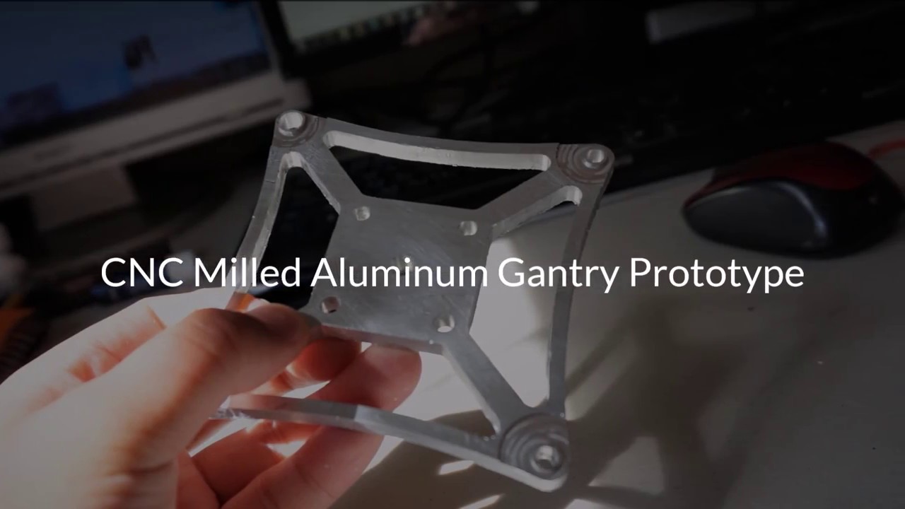

I know of a few vids on tha tube that shows a mill, being it long or alt, cutting sheet metal and aluminum. There are some material lists avaiable for the longmill and that there is the problem with lists. Every machine has it’s own specs so every machine needs its own list. I see them more as a guide line, eventhough I do have the machine for these lists.
There’s some great info on that and some guideline list here:
Here’s the sheet metal on a longmill.
Aluminum on a mill one

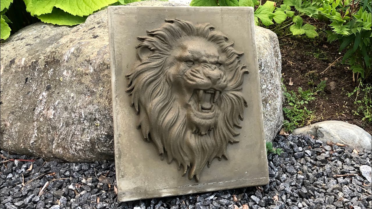

And if you feel like doing some more concrete you can always carve casting molds. You don’t need much of a cnc for that. If you bump your head into a peace of styrofoam you might be good to go.

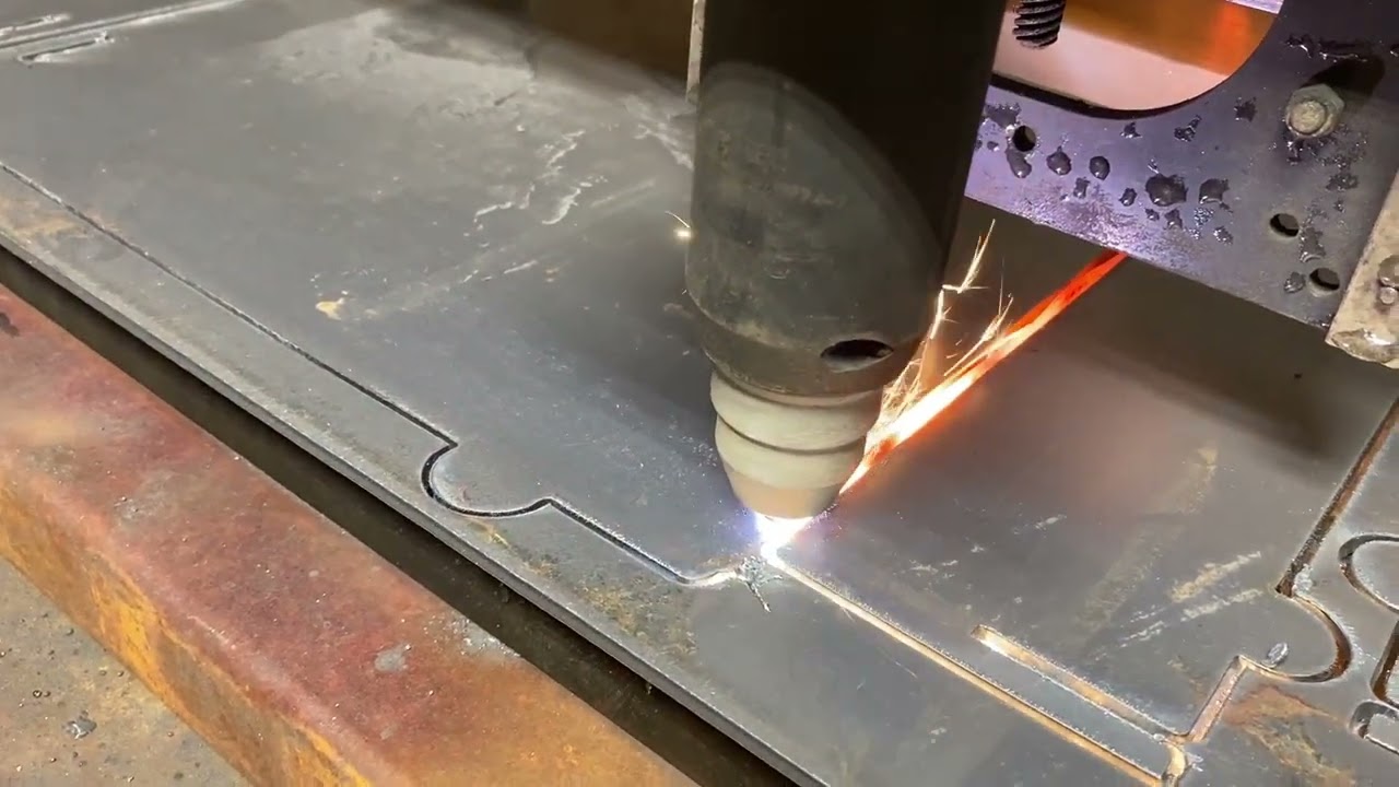

And if you like to go all in crazy, here’s a plasma cutter on a longmill.
Like @Spamming_Eddie suggests, making molds to cast concrete, cement, plaster of Paris, clay, or other non-combustable materials is what I would do. I dont know how well soft stones like soapstone or sandstone would carve but I’m sure the dust it creates will be bad for you and your machine.

Aluminium cuts well with the right bit. Other non-ferrous material like copper and brass should too.
