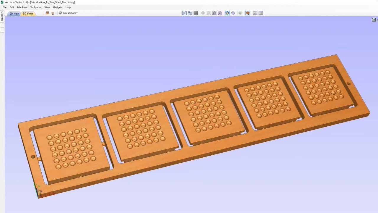

FWIW, another easy option in VCarve is to do this as a double-sided project. That way, you can use a regular bit and have no worries about Z travel.

@Bill I would suggest that, no matter how to decide to set your XY0, you still use asymmetrical dowel holes in the work piece and in your spoil board to ensure that the two sides line up exactly.
I was thinking the same, there are as one can see waste areas that could easly accept dowels, the issue is the drilling through 3" + 1/2" into the waste board. I know I could manually do it but vetric has the feature of copying and reversing so both sides have the same dowel reference.
For both sides if I use 4 dowels that means 8 holes in the spoil board
@Bill I should have explained better. Here is video that explains it very well
I understand asymmetrical dowel holes, easy on 3/4" wood, how to do it on 3" thickness don’t know, I don’t have a bit to go through the 3" stock and another 1/2" into the spoil board.
@Bill You don’t need to drill the holes all the way through. You only drill them deep enough to take the dowels. That’s what Mark shows. Example: you drill 3/4" into the project material. You drill the mirror image holes 1/2" into the spoil board. You put 1" dowels onto the spoil board and place the project material onto them. The two sides MUST match. You do not ever reset XY0.
