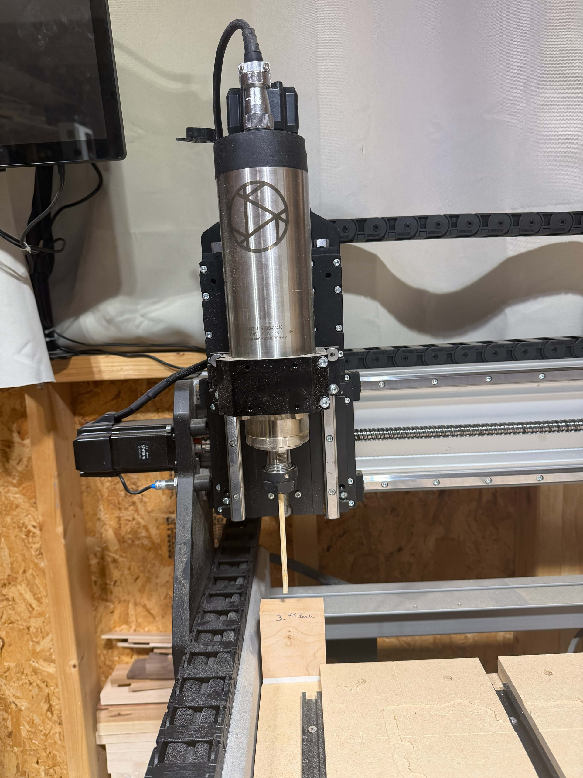

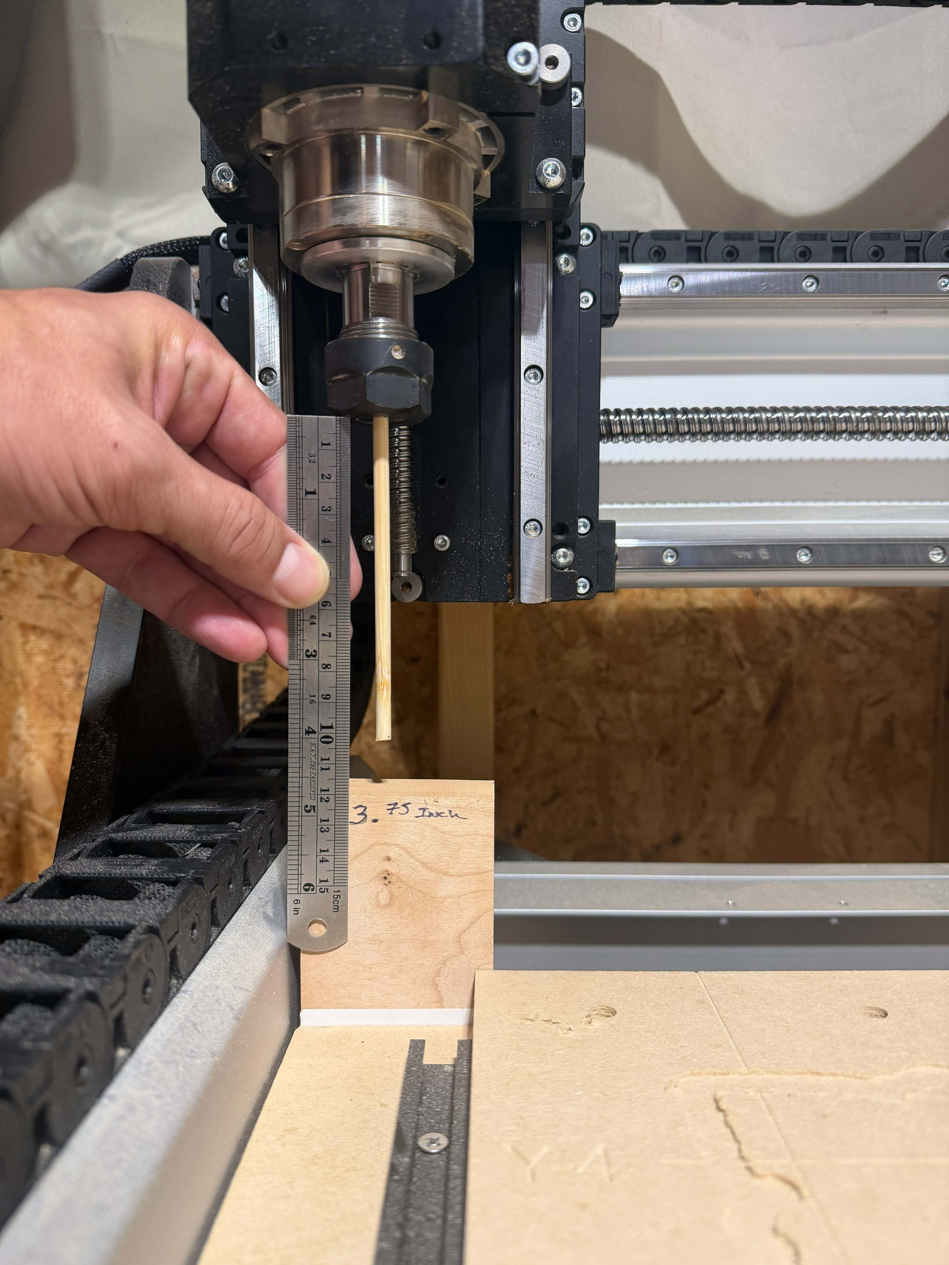

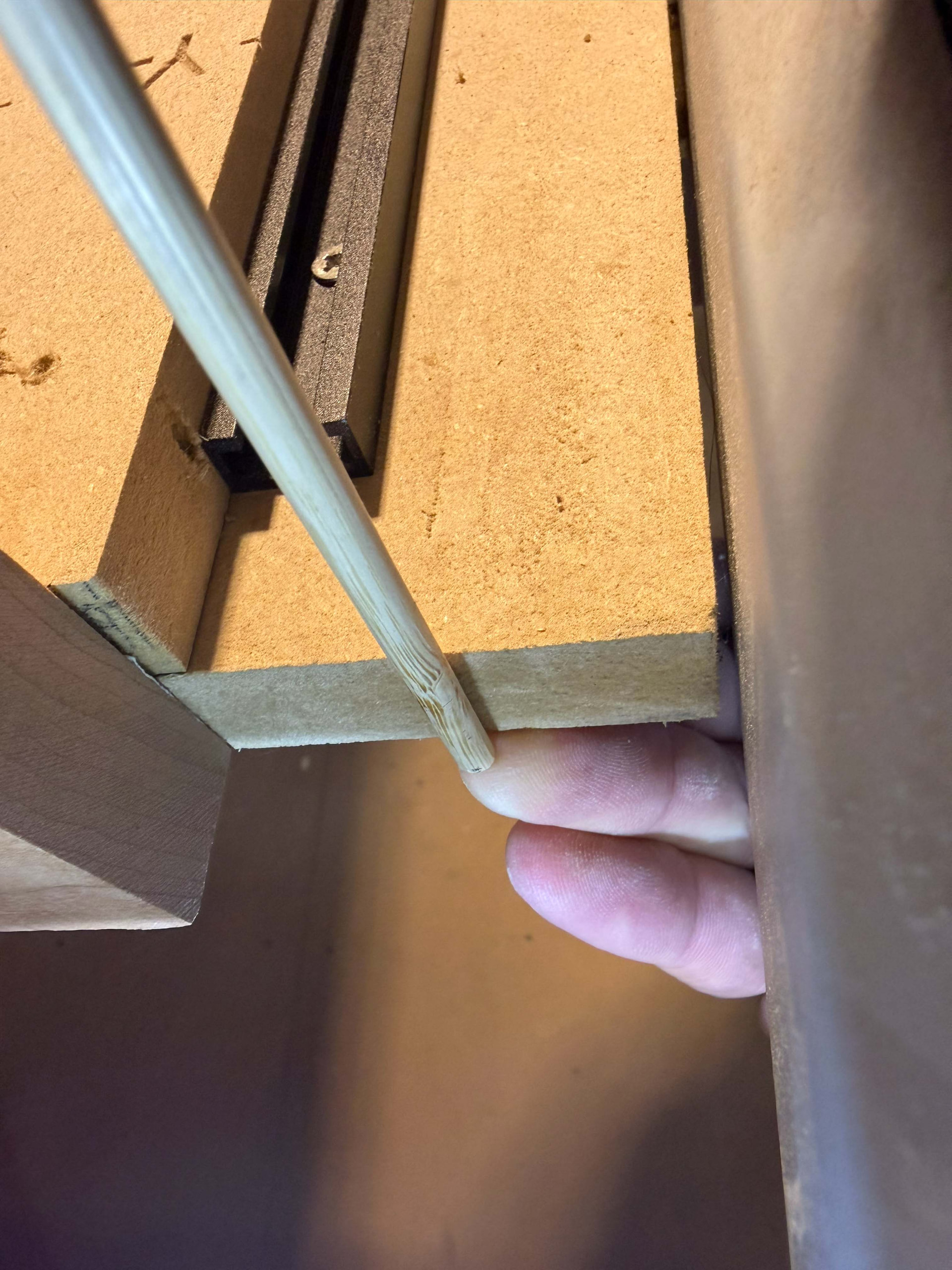

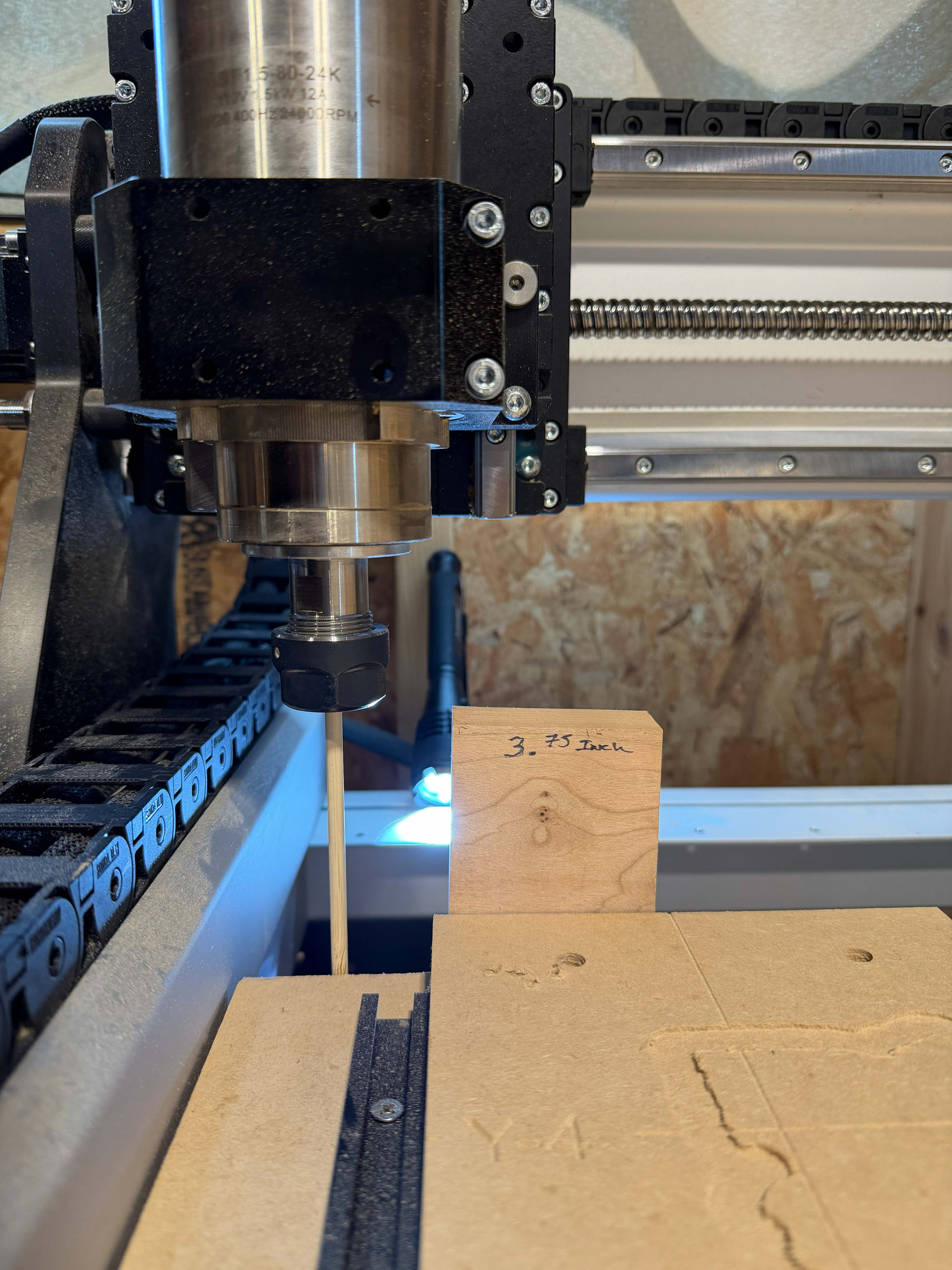

I thought I would try a set up for you. Here I put a 3.75 inch block on the frame below my spoilboard. I maxed out my spindle to its limit. Then I pushed the spindle a far up on the clamp that I felt was safe and strong. I then placed a dowel in the spindle and left 4” exposed. Here was the results:
Looks like it would work if you made a jig that attached to the frame instead of a spoilboard.

@Karver_One With that set up, with the dowel still reach the spoilboard at the bottom of the travel? If the AltMill specs are correct, it shouldn’t.
@gwilki I see what your saying, but I wonder if they were basing those numbers on a specific setup. Since I have seen some of the Sienci staff put their spindles very low on their videos. Of course they are being very safe because if I was cutting hard steel I would like my spindle to be a little lower so as to have spindle clamp give more “bite” to the spindle. Or possibly they were basing their numbers on a Makita router setup. But I must admit I found that it does actually reach the distances Tim was looking for and funny enough….with room to spare. Wild, I learn something new about this machine everyday =)
@Karver_One That’s odd, because where the spindle is in the clamp has no bearing at all on the amount of Z travel available. If Z will travel, say 6", it will travel 6" with the spindle low in the clamp, high in the clamp, or not on the machine at all.
Anyway, as long as @tjpilson can do what he wants, it doesn’t matter. It would seem that the Sienci documentation should be amended to reflect the actual amount of Z travel though.
