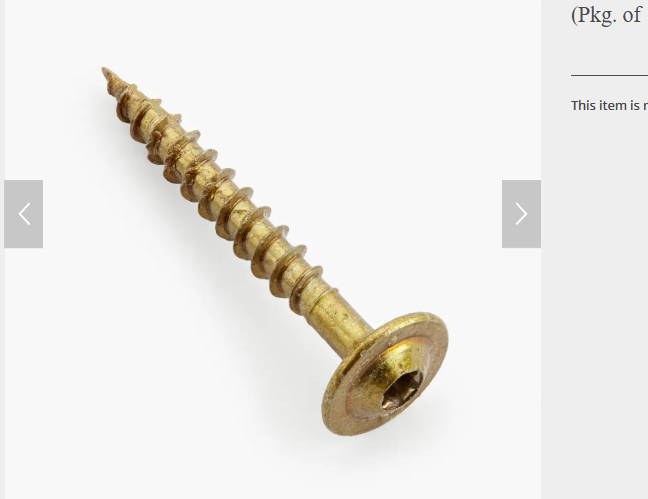

Does someone have recommendation for screws that will hold top MDF spoil board to the bottom layer MDF? I have some “cabinet” screws that have the nice flat washer head on top but the threads are not very coarse so worry that they will not work well.

I had some 1" “washer head”/cabinet style screws that had very course threads on them which I thought would be perfect but could never find them anymore. I was also asking since I was getting paranoid after just using the cabinet screw I was going to use for the spoil board in a softwood and it did not hold at all. Would the MDF hold the cabinet screw better than a softwood? (was white spruce)

Looks like a Truss Head screw to me. Pocket Hole screw would work as well (same/similar head). Either would be a good idea.
