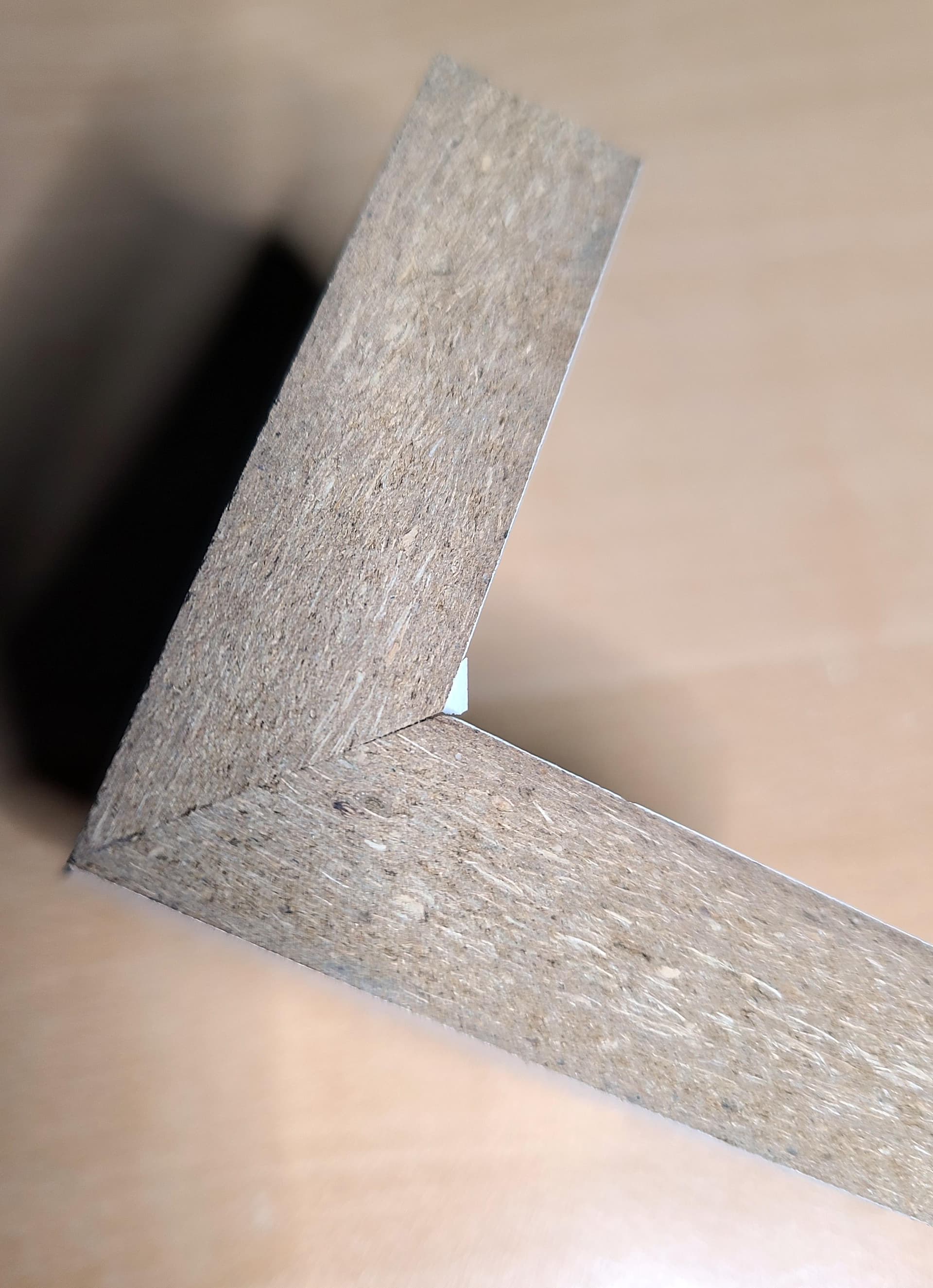

@pauljima I’ve done a few, but none recently. I did this one this afternoon in crap particle board so that I would have a pic to attach. I do these as vcarve toolpaths in VCarvePro,with a downcut 90° vbit. It’s only 3/8" diameter. If I were to ever get into doing this on a regular basis, I would look for one at least twice that. My feed rate was 100 ipm, with a plunge rate of 50 ipm.

Is that corner square too? That’s my issue… As far as I can tell, my 90 vbit is square. I’m not sure what the issue could be. Everything else I’ve cut seems on point, but I can’t get a proper miter cut to save my life… there’s always a gap on the inner corner when the two pieces are actually square.
Paul if the bit is a true 90 then it should produce a closed mitre. It seems that the issue you have is that the bit is not staying on plane when doing multiple passes. Possible causes are the bit is deflecting during the cut, or the bit is not square to the work.

@Jens Not to be a smart ass, but a downcut bit is just as its name says. It has a downcut shear to it. Just as there are upcut and downcut end mills, there are down cut v bits. There are no upcut v bits that I am aware of. Most v bits are scrapers. All of the v bits with inserts are scrapers. I have done these joint successfully with scraper-style v bits.
Yes, in my case, my downcut v bit has a cutting diameter of 3/8". As I said, if I were to do these joints frequently, I would look for something wider.
For this experiment, the material thickness was 5/8".
VCarve does set how many passes it will take to make the v groove. The groove’s diameter is twice the thickness of the material. The number of passes width-wise depends on the thickness of the material, the diameter of the bit, and the stepover set for the tool being used. I didn’t keep track of how many width passes this sample took.
Much of the succcess with these is trial and error. The toolpaths will vary depending on the exact thickness of the material, the diameter of the bit, the stepover, the feeds and speeds used and the machine’s capabilities.
