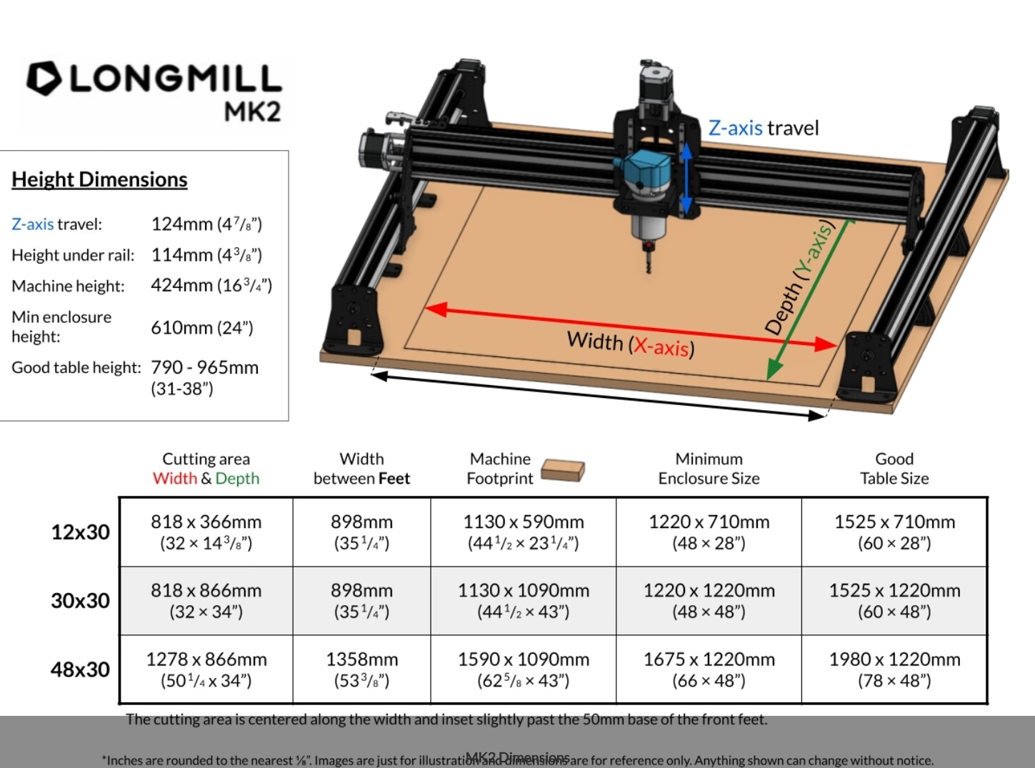

I think a good start is to collect a calculator, a measuring tape to measure up the machine you have and verifie how much longer the axis are vs the actual cutting area.
This picture might give an idea, but beware, it may include feet sticking out so take it as an indicating only and go with what you actualy measure.

yes, I would reduce the rail and the screw by the same amount BUT … before you slice and dice, Have a look-see at the screw. Does it have an area where the screw shaft is reduced to fit into the bearing on that side? Do you have the capability of doing that work while keeping the shoulder in line /concentric with the screw? Be aware that on a lot of these kinds of screws (most certainly any ball screw which I don’t think yours is) there is a surface hardening treatment applied. You will need to make sure that what you are using for cutting is harder then the screw or you need to grind the screw end off. Whwn turning down the shoulder you should use a carbide cutter and it probably needs to cut deep enough to clear the surface hardening.
Of course it is also quite possible that the screw isn’t hardened.
