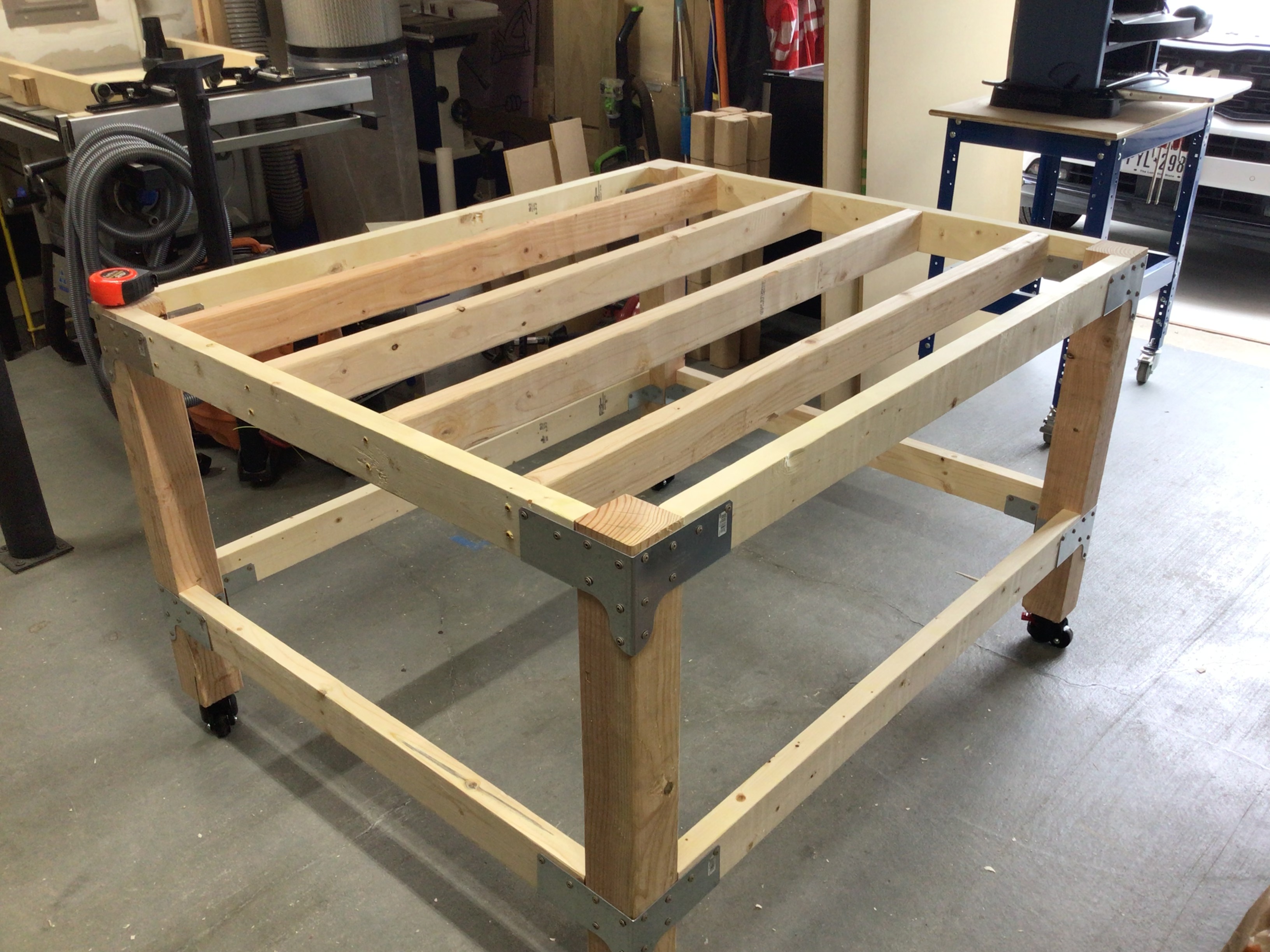

It’s a 27 inch monitor, my table is 60” wide so I should have plenty of room. I also plan on building a box for the Longboard along with my small form factor PC, I will also be adding fans to the box and air inlet to keep things cool.
Attached is my table so far, I ran the 2x4’s through the planer so they are all flat on top.
Nice work so far! That looks pretty sturdy. Looking forward to seeing your setup when you are done.

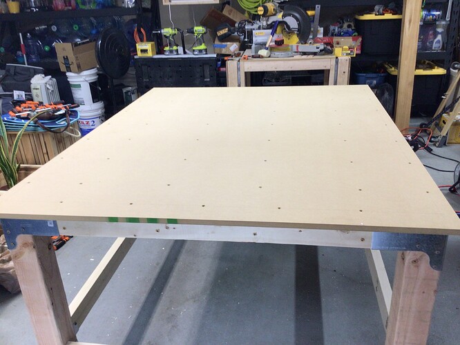

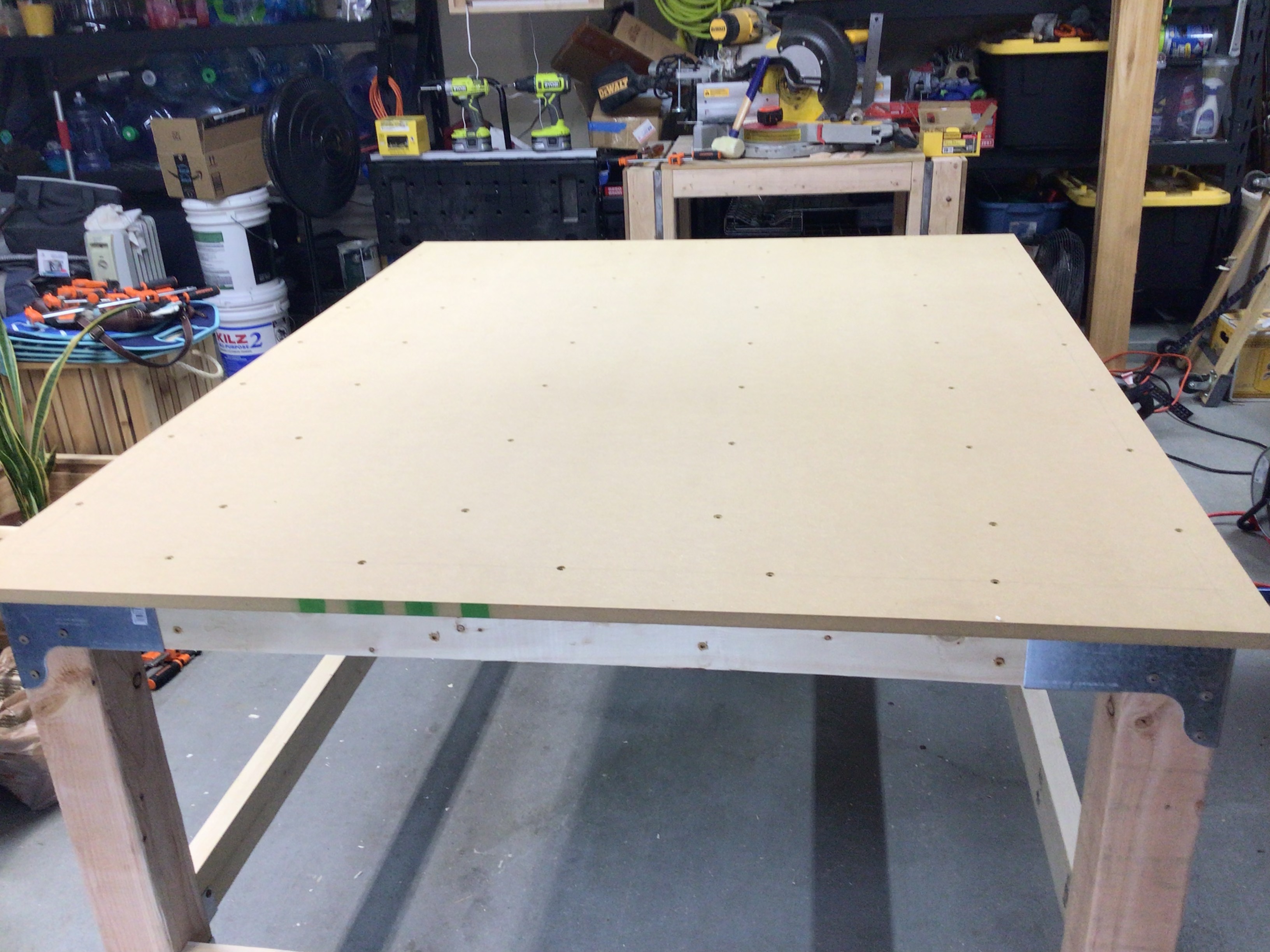

It is rock solid, I am going to mount the top in a few. I will place screws around the perimeter, should I put screws were the cross members are?
I would and did put screws where the cross members are.
Did any of your perimeter screws interfere with mounting of the mill?

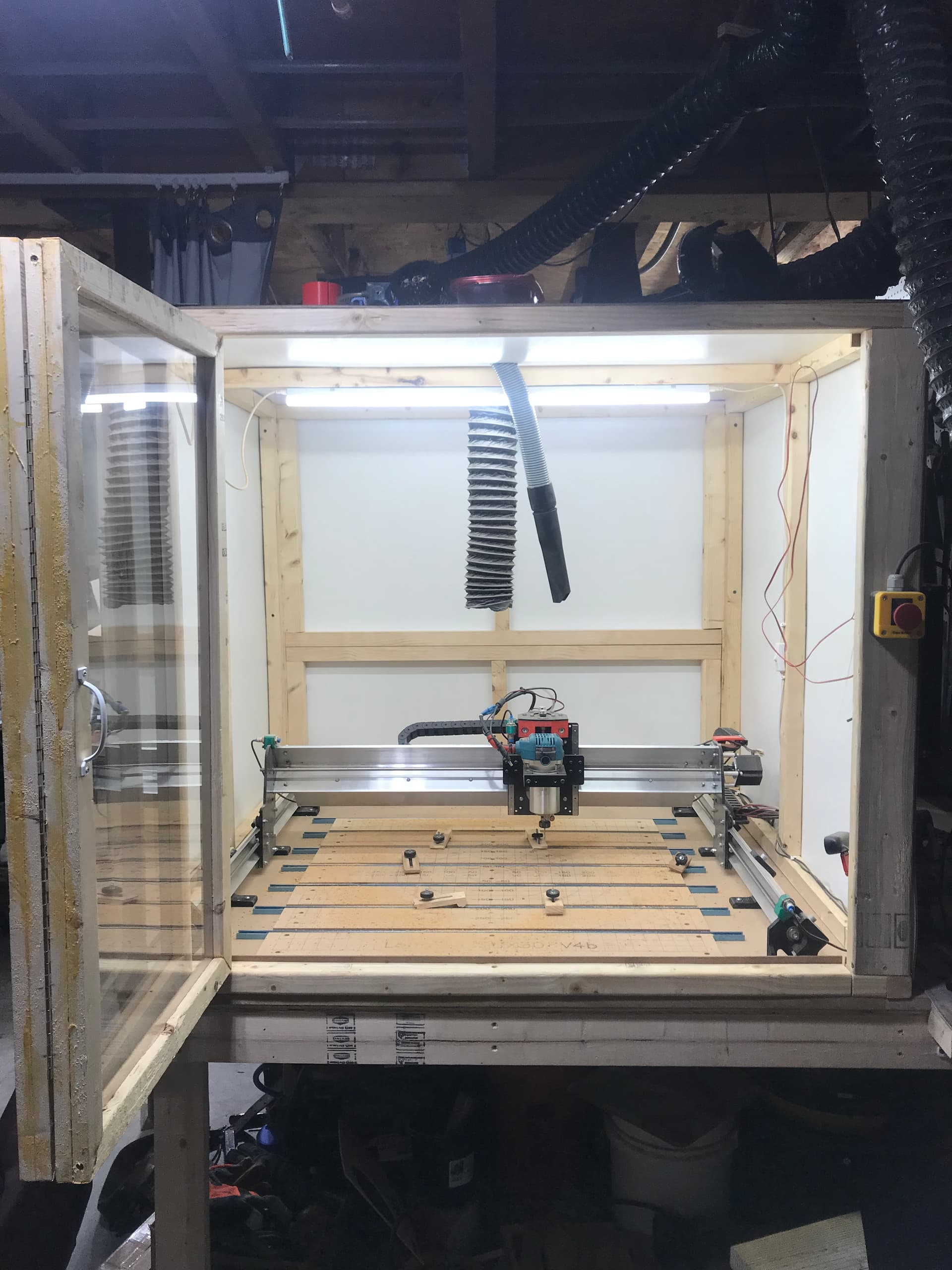

No, but my machine is only 30x30 and I built an enclosure so my machine is not right at the edge of the table. I would put the screws in a regular pattern after taking a look at where the mounts are going to end up and avoid those areas. If you mark or can see where a line of screws is it will help to avoid hitting them with the spoil board screws as well.
I also have a 30x30, do you have any pics of your enclosure?

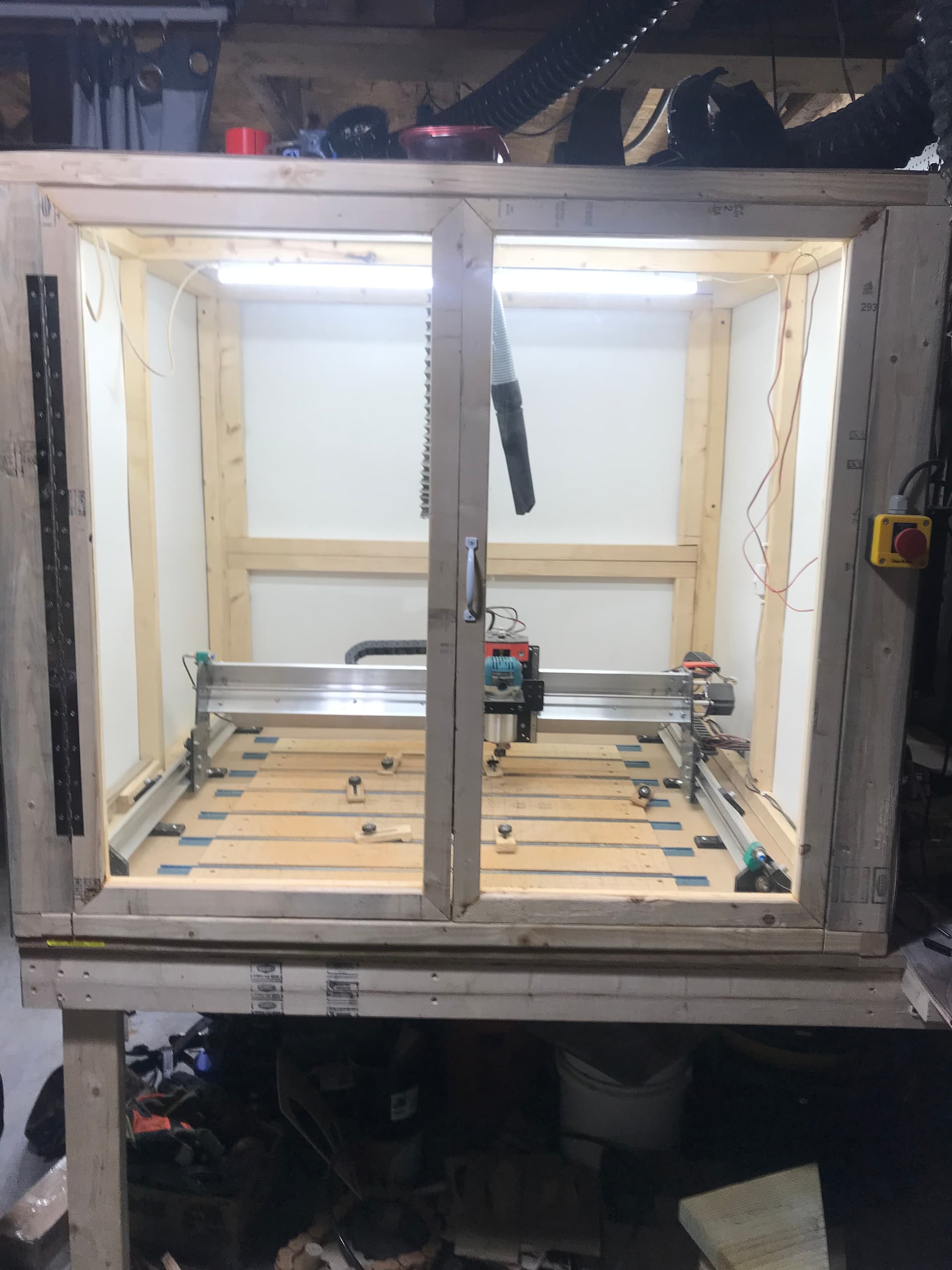

Here are a couple of pics. I made my enclosure really tall so I don’t bump my head.
If you look at the back where the cross members are that’s a section that hinges to allow pass through work.
EDIT: My table is 2x4 construction with 3/4 plywood on top and then 3/4 MDF for flatness and then the spoil board. The enclosure is made from 2x4’s 2x2’s and hardboard for the walls and ceiling.
That is very nice Mike, is there a benefit in having the spoil boards the way you do? I am getting ready to put my mill together as I type this :sunglasses:
This is the reason I have the spoil boards the way I do.
I can remove the front one and I have a homemade moxon vice underneath for doing vertical work.
