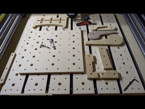

I went initially with Garret’s from IDC Woodcraft. But began pouring over YouTube and Etsy looking for the perfect spoilboard for my 48x30.
I finally settled on a design I found on YouTube from a guy with a very very few posts. He did something I had not seen before.
He used 3/4 inch plumbing water pvc pipe as his stops and drilled corresponding holes for them. And he created a smaller more manageable spoilboard to use on top of the main board. Far easier to work with on 90% of projects.

What my buddy across the street and I did was omit the hardest part
the threaded inserts or T Nuts and the T-Track. We just don’t see the need.
We also use a big grid of 3/4" holes to accept 3/4" PVC plumbing pipe. The primary clamping is done with spacer boards and 6" to 8" very narrow wedges
nothing moves. If you hit the PVC, the bit just goes through it like butter
no damage and you can probably still use the pipe again
just nicked.
We also use cam clamps as well. He mentions they
we don’t screw them down
we just use one of the PVC pipe and place the cam over the pipe with its own 3/4" hole. There are lots of cam files on Etsy!
After you watch, you’ll see also, his smaller spoil board that goes on top of the main board. We made ours a little larger.
This all avoids the expense and time-consuming process of the hand done inserts or T Nuts. Plus, you can chew up the little board without any worry. Your CNC will make another one cheap, quickly and easy.
Once you install threaded inserts or T Nuts once, you will N E V E R want to do it again.
