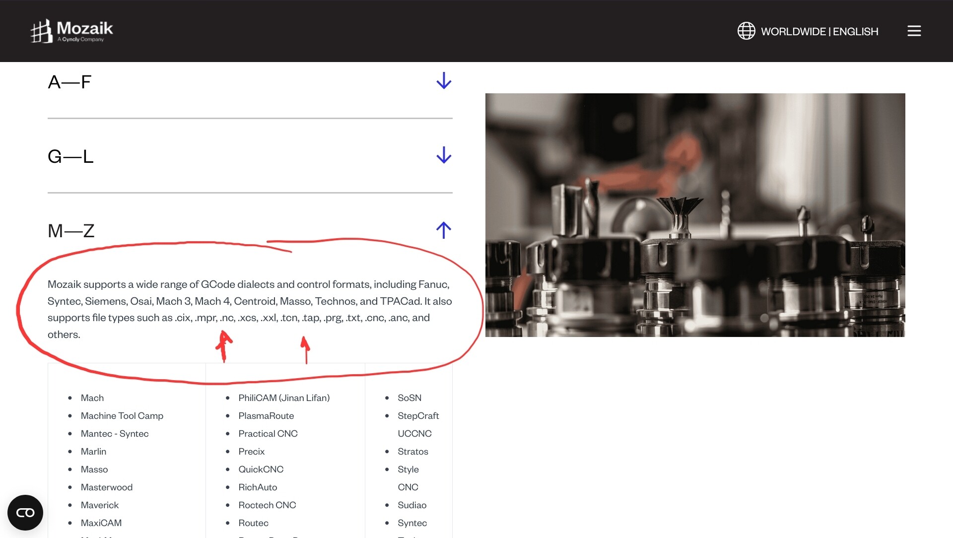

Hi Jamal,
Looking at their resource page I see in the extension list a few that I know gsender will work with (.nc and .tap). Please note I do not have a altmill and my machine ru s on old fashioned gbrl, but it would surprise me if grblhal wont take these extensions too.

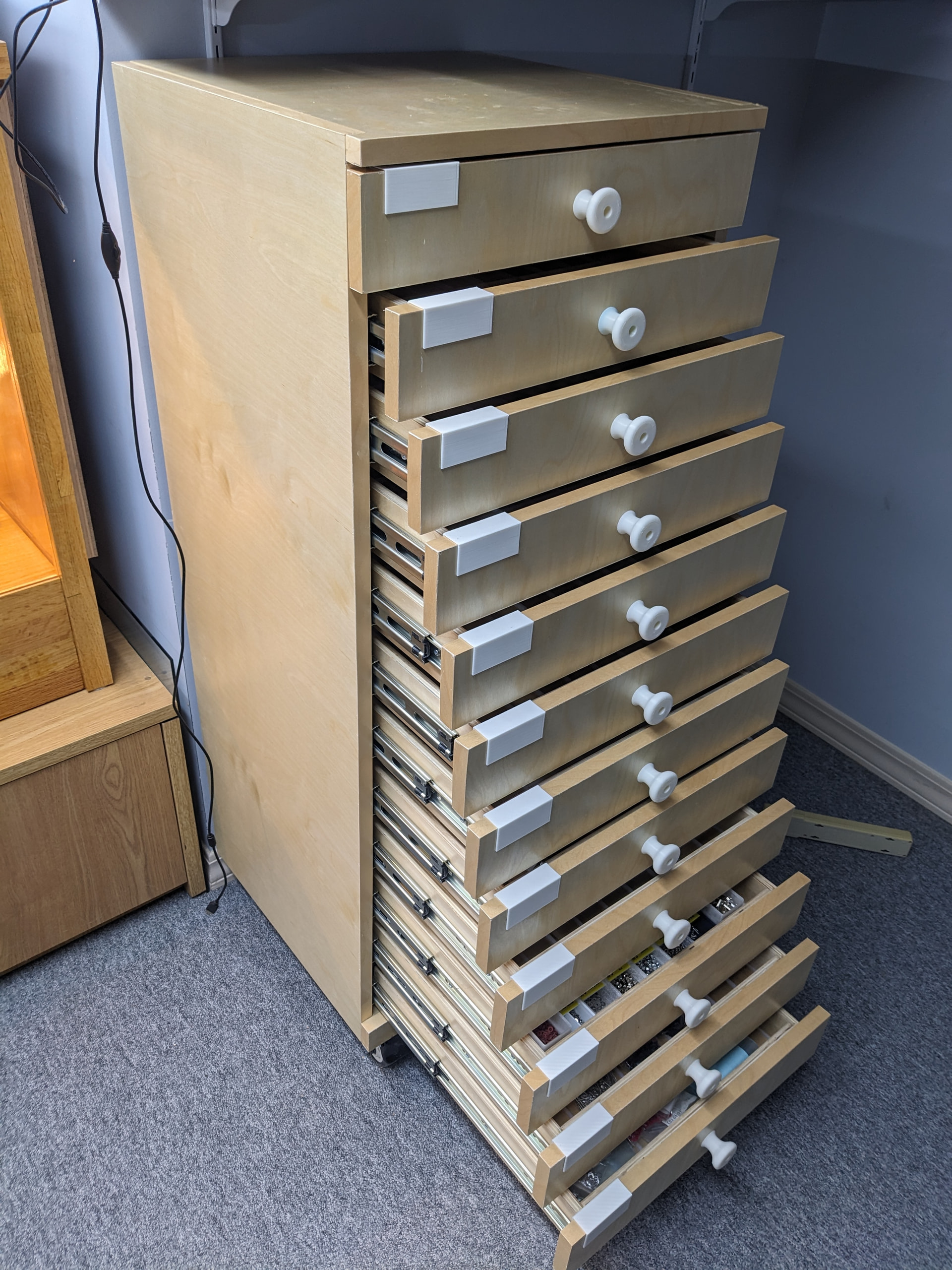

It was a LOT of work but here is an example. Luckily I am retired and have nothing better to do.
