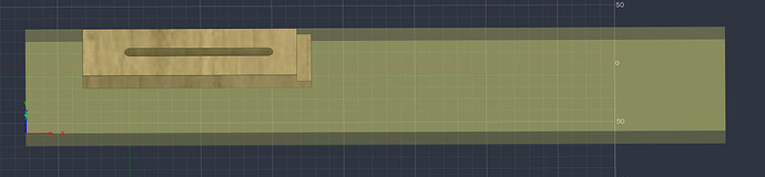

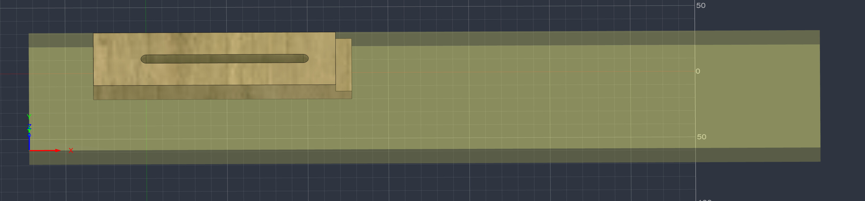

For some reason there doesn’t seem to be a lot of info on what I thought should be a simple thing. I have a fixed stock size I specified in manufacturing that I am cutting cnc clamps out of but can’t figure out how to arrange 4 of them on that same stock:
What am I missing?

You need to make copies of the manufacturing model (in the manufacture section) or design one model with 4 clamps in the same stock.
Alternatively, cut one clamp and then reset x/y zero and re-run the one model
There is a possibility that if you have a subscription (ie the non-free) version that you can put several copies of one model on one piece of stock … but I am pretty sure you can’t do this even in the paid version.

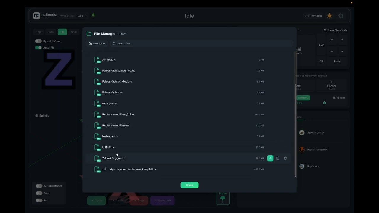

@DavidB ncSender has a copy feature that lets you repeat the g-code of one model. It would be a nice gSender feature too.
@Chucky_ott how does ncsender get around the different XY0 for each model?
@gwilki I’d have to take another look at his demo on YouTube. I’m not sure if he keeps the same g-code and just creates a new X0Y0 for each copy or if he keeps the same X0Y0 but adds an X or Y offset to each line in the g-code.
Either way, it was slick.
Here’s the link to the video:
@Chucky_ott Tks. I watched the video. It is really slick. I cannot see how to program in the material size in ncsender, though. As I will not be using it, it doesn’t matter. It will matter to people using this feature obviously. He mentions that if you try to create more copies than the machine size can accommodate, ncsender will warn you. If I were to use this, I would want the same warning when copies exceed material size. I imagine that ncsender can do this. gSender cannot as the material size is not entered into gSender.
Thanks again. Interesting stuff.
You can’t. After you replicate, it does tell you the size you need (grid size) so I guess it’s up to you to figure out your material size.

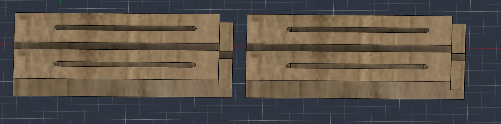

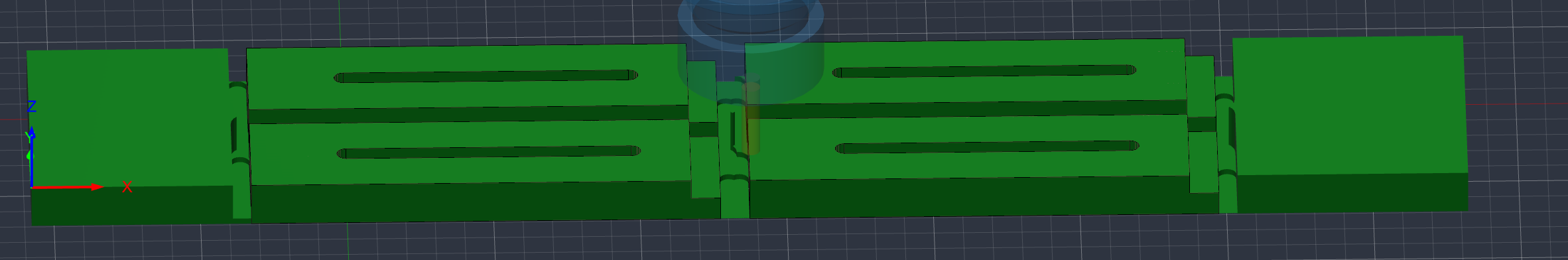

I did manage to copy/paste the component in the Design phase. I knew the depth and made sure the copy was aligned with that and also made sure to align with the left side. Last two copies did same and didn’t have to worry about how far right it went because stock was longer then I needed.
Going to try one other way by modeling stock in design.
@DavidB if you watch the video I linked to, Francis briefly mentions how he does it in Fusion.
@Chucky_ott It looks like he did what I did (copy/pasted or duplicated) in the design phase and in his case layed out exactly across the stock he already had?
