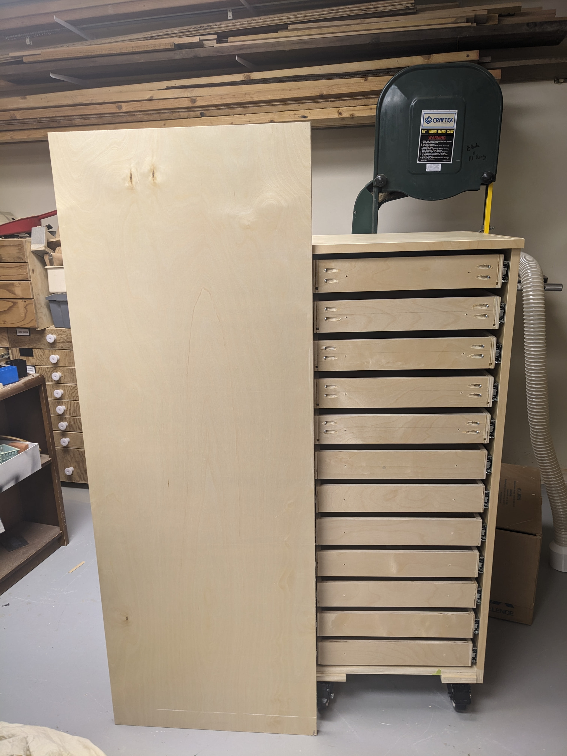

I am building a chest of drawers. There are 12 drawers and the assembly is about 45 inches tall. I need to build drawer fronts to mount onto the drawer boxes. I want to have the grain on this plywood flow continuously over all 12 drawers.
My idea was to cut all the drawer fronts out of a single large piece of birch plywood. I normally leave tabs (2 mm * 2 mm) when I do a cutout from a larger piece of stock. I am concerned that since I am cutting out 12 drawer faces from one sheet, that the result will be like a wet noodle. There is a 15 mm area of stock around the outside but the inside (all 12 drawer faces) are just held together by tabs.

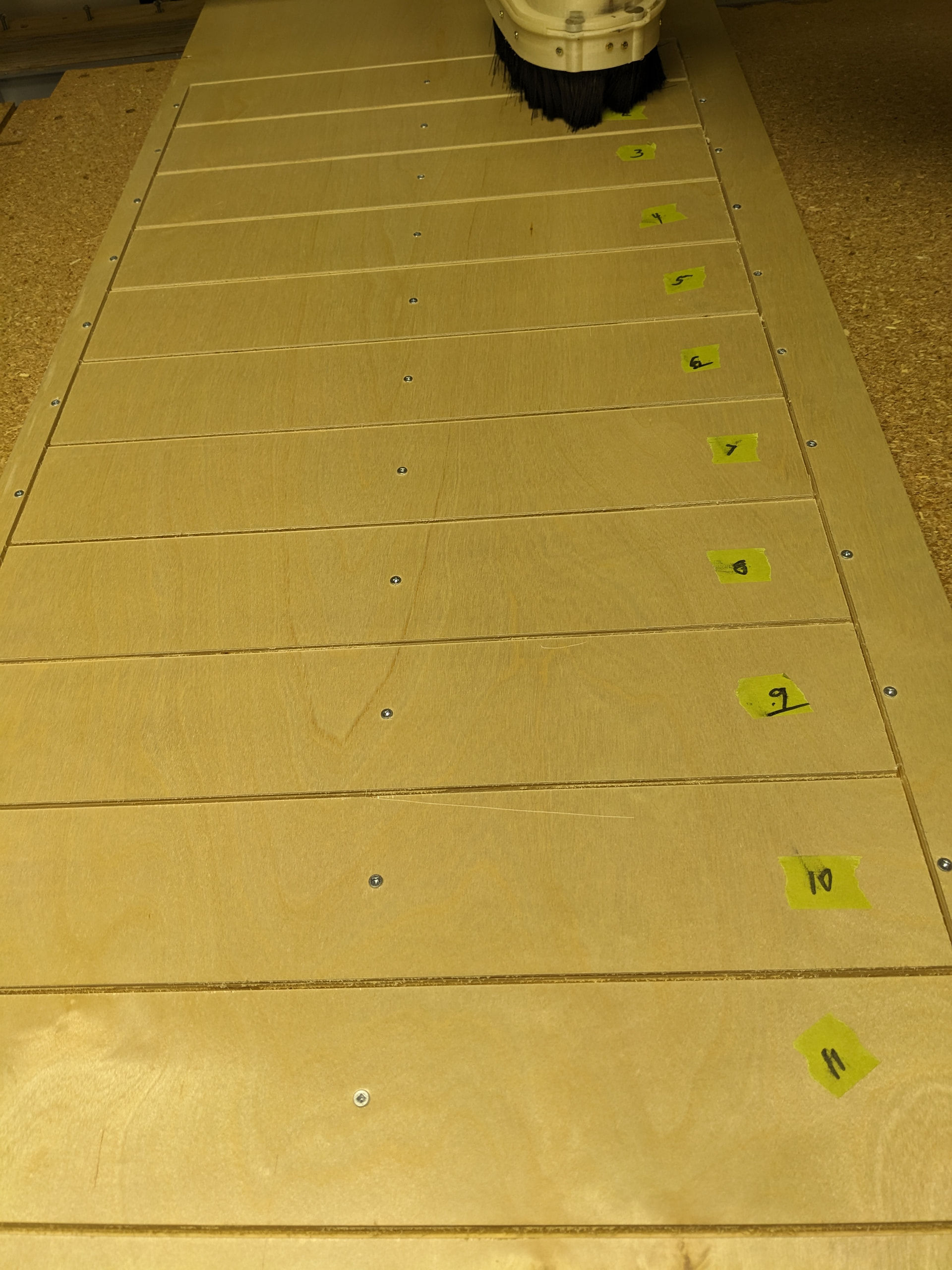

I have decided on a method … I will use a 1/8" endmill, first pass will be a downcut, the remaining passes will be upcut. I will leave the last 1 mm uncut.. I will then cut the last mm with tabs. I will either use the pull holes or apply double sided tape in the center of each drawer front. I am leaning towards using the pull holes.
Using a 1/8" endmill will hopefully keep the cutting forces pretty low. I will cross my fingers and my toes and say three hail Mary’s just to be on the safe side.
Thanks for all your inputs!
This is how I ended up milling the front drawer faces … 38 screws are holding it down so it isn’t going anywhere. I did make a bit of a mistake in only cutting down to the spoil board - I should have gone another half mm further down to reduce the breakout of the veneer. Live and learn …
@Jens very brave of you to have those screws sooooo close to the cut line
I was veeeery careful :slight_smile: Laid them out in the CAD program and tested things (with my hand on the “holy shit” button) before I proceeded.
