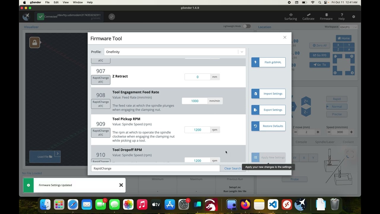

For RapidChange support, to my knowledge so far this is roughly where they’re at since I last spoke with their team - though into the future we’re hoping to make it so gSender doesn’t pause during tool change (optional) as well as integrate it more deeply into firmware

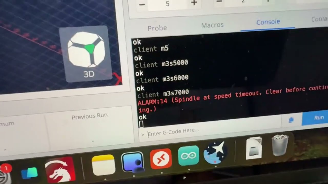

Not good start for me. Already doing troubleshooting for my spindle.
I think the SLB is not getting the speed or the VFD is not sending it and then the firmware trigger spindle timeout.
Good to know it’s on the firmware side and not sender side :+1: Perhaps since you’re only getting the alarm after frequent changes then you might want to look at Firmware settings $392 and $340? I’m not the most familiar with spindles, there are other on our team who are better versed and can answer via ticket on our contact page, but I think it’d be worthwhile to give it a shot.

It’s currently set to 0, which should be disabled. I think the problem is the SLB is not getting the data or not able to parse the data coming from the RS485.
I also tried increasing it the $392, but had no luck. I have already created a ticket for this issue.

@siganberg, just spent all day with the team testing spindles and plan to continue with it tomorrow. Turns out the old batch of spindles we ordered and distributed performed well but the new batch the majority are having Alarm 14 errors too. Now Alarm 14 is generic, so it’s hard to say what the origin is in each distinct case, but it’s causing us to spend time trying to diagnose whether there’s any improvements we could be making to the SLB firmware or if the units are plainly defective.
One interesting thing is that for many of these units when you run a job with the spindle on, it seems you can override the spindle speed as much as you want during the job without an alarm appearing, but if you perform manual control and continue changing speeds sometimes it sets off the Alarm (if you’d like you could try this yourself and let me know what you see). Hope to find results one way or another but we’ll see where it comes out. It might also be a VFD setting that’s not giving the SLB enough time to communicate with it or sending a response back to the SLB quick enough. These are both quite complex systems, I just spent 5ish hours going through hundreds of settings and will have to review them over many times more until I can see what might be going wrong.

I’m now working with my ATC and found an already-written plugin for RapidChange ATC. I’m just experimenting with it by compiling my own SienciHal firmware with this plugin. I was able to flash it, but it still needs more tweaking to make it work.

I was talking with the author of the plugin, and he already suggested moving to the macros using SD card approach, as it’s easier to customize. However, it’s not as sleek as the plugin. I might try that macro first since I’m not really proficient in writing C++, though I am a C# veteran. :smile:
New ground broken today as far as results for our own internal units!
It appears that as far as grblHAL’s pre-built spindle libraries are concerned (though this might now be fixed in the main ‘core’ but we haven’t pushed upstream to rejoin yet), there seems to be some additional retry features or error checking built into MODVFD that the other ones don’t have. This was confirmed after decoding the values needed for $462 through $471 for the H-100, once spindle control of the H-100 was happening through MODVFD the operation smoothed right out, and we could switch back to the H-100 profile and experience Alarm 14s all over again. The other aspect we found was setting $340 to 100% which also seemed to occasionally help though more testing should be done to further confirm.
Plan now is to try to investigate where the source of the error correction is coming from, and see if it’d be possible to implement across all other profiles (or if they’ve already been implemented upstream) then introduce them in a new firmware build to distribute. @siganberg I’d be really interested to hear if this resolves your issue too since that would increase my confidence in this being the source. We’ve seen other reports of this happening with other grblHAL boards too and other VFDs accross different communities, so if this is all ties together then this could be a big solve.
