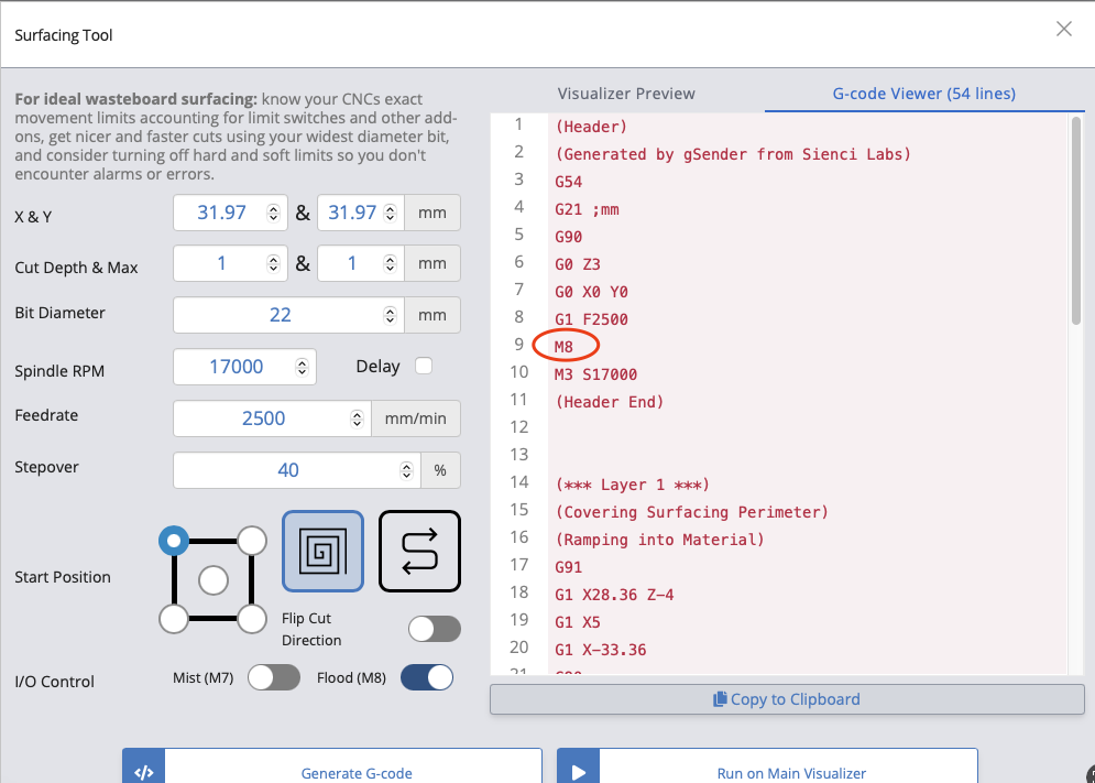

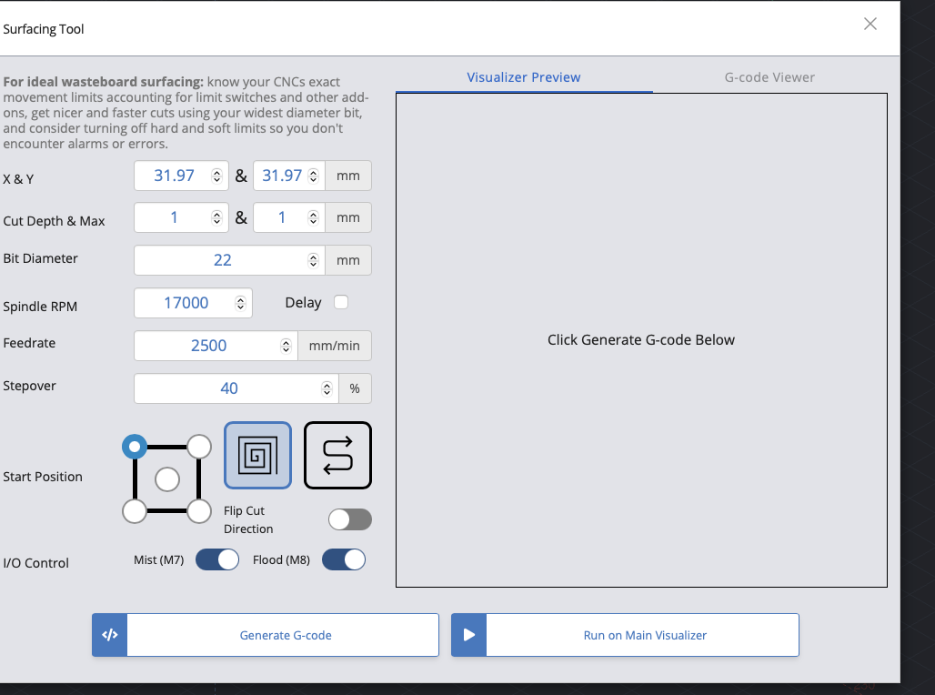

I’m also working on another feature branch for gSender to add I/O control options for surfacing.
Currently, I manually switch my vacuum ON/OFF when using the generated surfacing g-code from gSender.
I can create another pull request if this feature would be useful for others.
Would this also be possible to do using the Start/stop g-code in gSender? Or are you needing the commands to be sent at a specific time that start/stop can’t accomodate
Thanks for the PR, I’m sure we can pull it through - we might have to find another way to make the dialogs togglable since I think others are using the ā€˜code’ option and want dialogs to not be present for that too - but it’s doable either way. I’ll have to check out the NGX expressions flag, since if that’s all that’s needed otherwise then i can note it down to include in the next firmware update. With those changes in it would seem that your setup would be then possible with all stock setup :smiley:
I need it to be in specific order, right before the spindle turn on, similar when I generate code from CAM.
Is that the purpose of the Passthrough switch?
That’s a good point actually, perhaps we could just disable the popups when a passthrough occurs

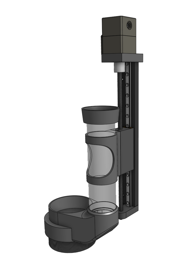

Here’s some improvent on my air flow efficiency of my new AutoDustBoot.

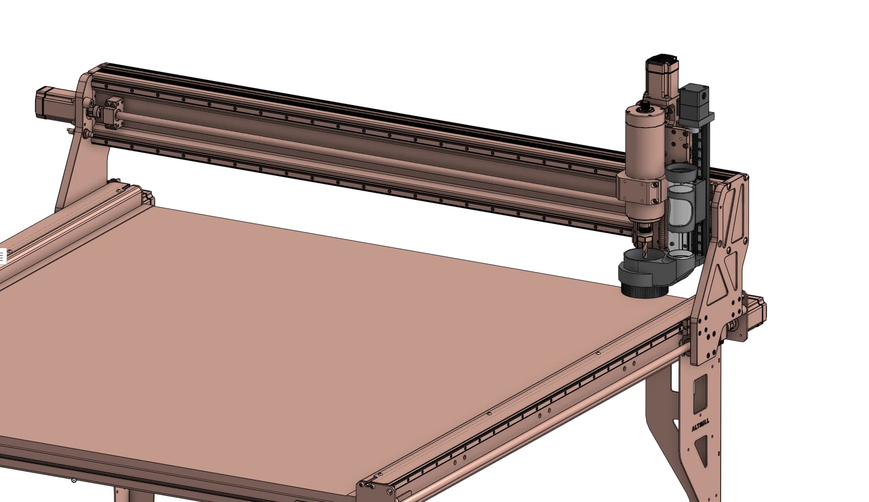

I also created a concept version for Alt Mill in case I get one in the future.
Note that the Altmill requires/suggests you use a 4" dust collection hose. It would appear to me that you are using something like a 2" hose which likely is insufficient
YMMV
That’s for their dust boot.
Mine doesn’t need it. I’ve been using just a shop vac since my Shapeoko days. If you watch my video, I even lower my Festool MINI CT (a shop vac) to half power.
I guess it really depends on how much material you’re trying to pull. For an average hobby job, 2" is good enough.
