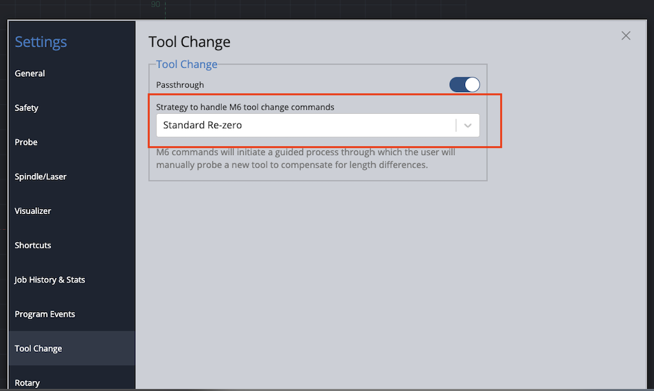

My suggestion behavior should be:
  • When Passthrough is enabled, the gSender just send whatever M6 line code to the firmware and also disabled the “Strategy to handle M6 Tool change command” drop down. No alteration to the M6 command and no pop-up.
  • When Passthrough is disabled, the “Strategy to handle M6 Tool change command” should be enabled and whatever the options is selected, it will continue working as-is.

On the gSender side, I don’t need any strategy, I just need the M6 command to be send to the firmware as-is.

So basically I found 2 issues with gSender. First, the gSender is actually altering the original gcode line of M6 or omitting it depending on the preference settings. Second, it pops up a prompt message, which is really not required for ATC.
With this issue, I forked the gSender code and made my own modification to fix this issue. There is already a Passthrough flag in the preference I use to fix those issues. You can see more details on my previous message here with Chris.
