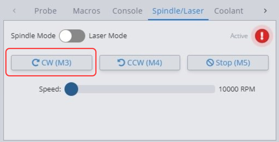

New Altmill spindle not coming up to speed
Hi, my New Altmill spindle doesn’t seem to go above the minimum speed setting when I turn it on with CW(M3) then it will shut off with a alarm(14). The VFD displays ” F 125” (frequency ?). Any help is appreciated
did you set up the vfd or it was set up from the factory ? try and go trough the settings and see if its set up correctly
also when you did M3 did you also typed S number? S means speed, so basically the command will be M3 S10000
look up in the firmware and check spindle min and max speed, also in the settings
I think he’s referring to the button labelled “CW (M3)” on the Spindle/Laser tab. He’s pressing it and not directly entering the M3 command.
I don’t know what was wrong but after I ran the Sienci spindle break in code it worked perfectly
