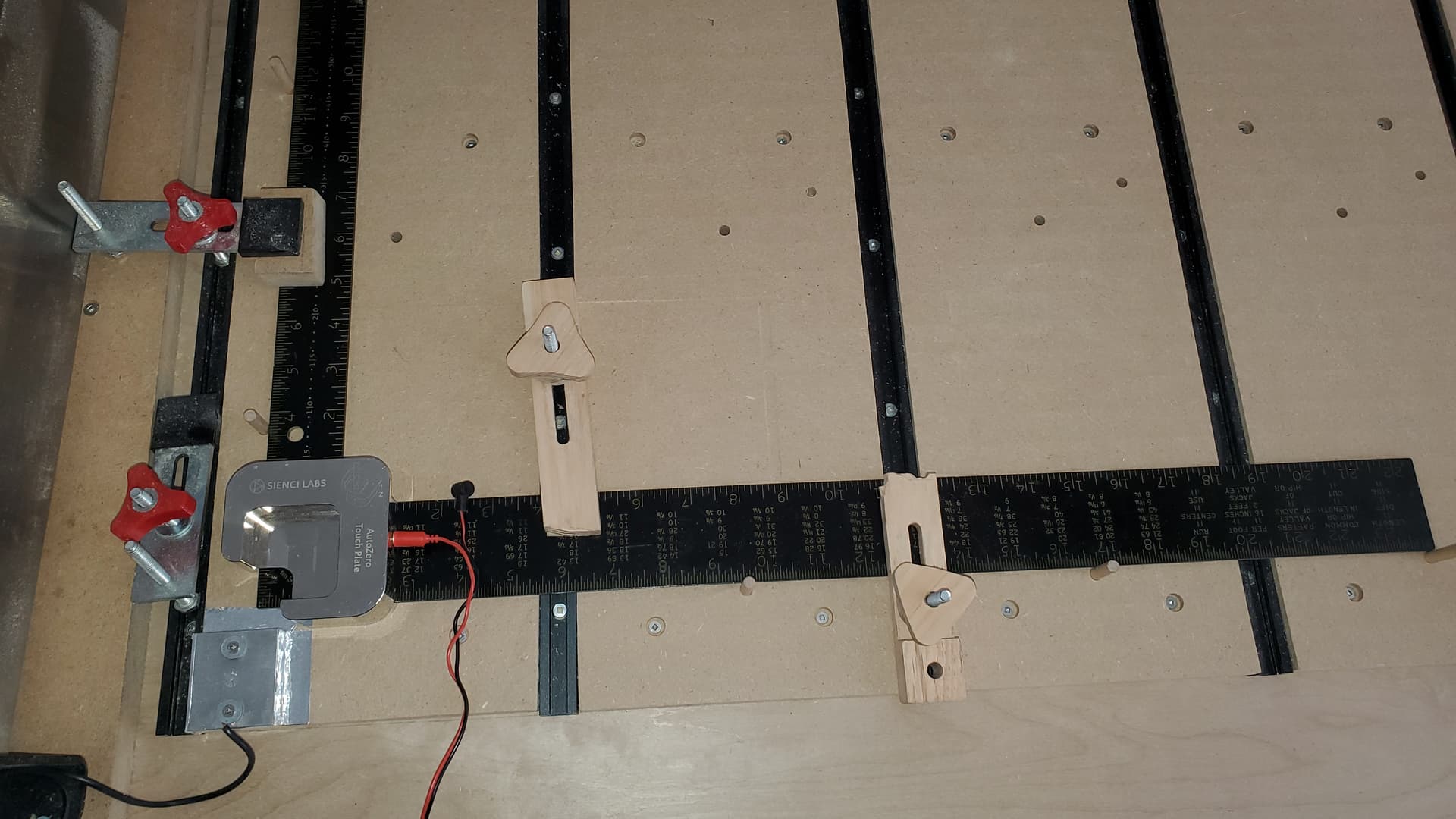

  • Machine, Table and Software Setup
I have two probes connected to the machine, an AutoZero Touch Plate for X, Y and Z probing and a smaller touch plate that I made out of an aluminum heat sink fixed with foil tape to the lower left corner of the spoil board (my machine home position) for Z probing.
Having macros for moving the machine to certain positions and automating tasks makes things a lot faster and easier.
A macro is needed to probe with the second plate so I wrote one that moves the machine to a tool change position and then probes Z on my fixed touch plate after I change the tool.
For a fence, I used the machine to pocket out a few 1/4” peg holes in the spoil board that make a squared fence when dowels are inserted. (If you plan on doing this make sure you leave room for clamps between the edges of the spoil board and the workspace)
  • Workspace Setup – Probing X, Y workspace coordinates.
To Zero the X, Y coordinates I insert the dowels and align a 16”x24” Carpenter Square to them, then align the AutoZero Touch Plate on the square and probe for X, Y, this only needs to be done once for the workspace.
  • Work Piece Setup – Probing Z workspace coordinate.
How I Zero the Z coordinate will depend on the job. Most of my jobs consist of profile cutting, so I prefer to probe off the bed using my fixed touch plate, I don’t like cutting into my spoil board when the work piece is thinner than it’s supposed to be.
I only use the AutoZero Touch Plate for probing Z if I’m probing off the top of the work piece,
which is only if I’m surfacing, engraving, or doing a shallow carving.
There are some things that are first setup in the CAM software, like the Z zero position(bed, or top of work piece), work piece dimensions, X, Y home position, keep out zones, job sheet, etc.
The basics of my workflow for the first job of the day consists of…
  1. open Gsender, connect to the machine and run a homing cycle.
  2. use a macro to move the machine out of the way.
  3. insert dowels for the fence.
  4. place the work piece against the fence, open job sheet and clamp.
  5. remove dowels.
  6. use a macro to move machine to tool change position and probe for Z on my fixed touch plate.
  7. load the tool path file while machine is probing and then start the job.
  8. if necessary repeat step 6 and 7 until the job is finished.
  9. use a macro to move the machine out of the way.
Consecutive jobs consists of points 3 to 9.
