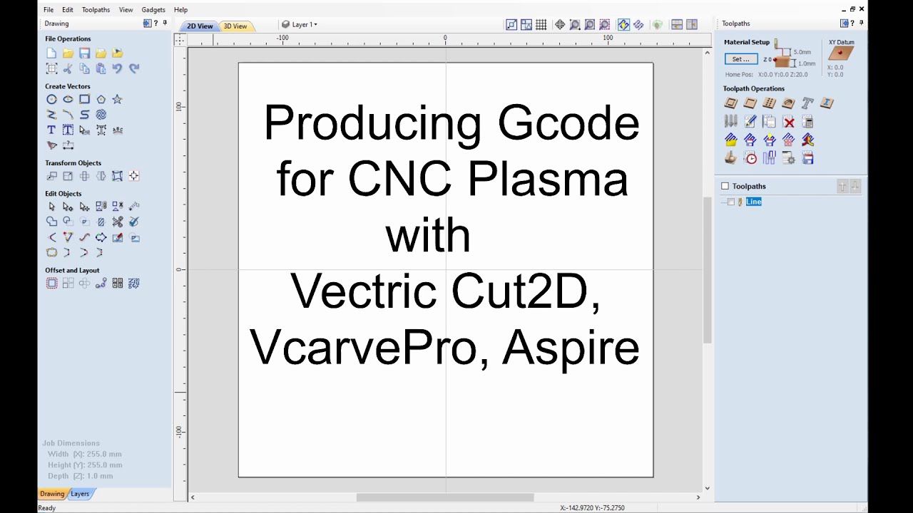

I did a quick search for how other people create toolpaths for a plasma cutter and stumbled on this guy that has it figured out using vectric software.
You might find it interesting.

yes thank you very much, I see you are using macros, there should be a description somewhere to help you with the macro creation.
